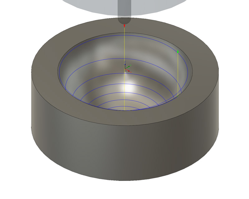

    can anyone help in letting me know which software would be best suited to cutting the attached part. ive tred Cut3D (May be doing it wrong) but i just cant seem to figure it out. been away from the machine for a while doing this sort of stuff
    Basically its a 200mm dia circle but i need to mill away the top to get the 1050mm radus cutting the rest is fine

    My idea would be to make a 3D model of it then import it as an stl file. CamBam for example could easily cut it in that manner or any other software that can make a 3D toolpath from an stl model.
    The bolt holes and central cutout would be standard 2D operations
    If it's any help I've attached an stl model, 200mm dia. with a 1050mm radius top and 20mm sides at the highest.

    Cheers lads, this are now coming back to me on the 3D side after seeing your files. also thanks to the PM's helping also its very much appreciated!
    I whats having a play with Fusion360 and this also seems promising but thats a whole new learning curve

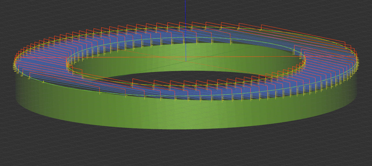

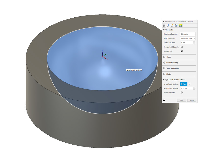

    Yeah it seems good. Only thing I can’t figure out is once the centre is cut out to just kill the face of the circle rather than a 200mm square. Looking at getting the machining time down
