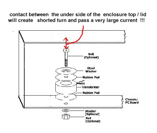

    Any connection between the bolt head and the chassis will result in a shorted turn
    but if its fitted in a low profile metal enclosure
    then it may be possible for the top to be deformed and touch the bolt head if pressure is applied !
Name:	Mount in metal enclosure.jpg

    How about the lower end? The nut will be in contact there right?
    the lower end is OK as the chassis , bolt and top mounting disk don't form a complete turn around the toroidal core
    its only when you close the loop by connecting the mounting disk to the chassis by a conductor outside the core
    John
