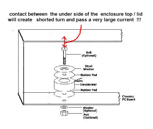

    Is this Mounting Disc the type of thing your looking out ?
    https://uk.rs-online.com/web/p/mounting-kits/6719208/
    using a Neoprene Disc
    https://uk.rs-online.com/web/p/mounting-kits/6719211/
    helps to even out the pressure on the transformer
    just watch out you don't accidently form a shorted turn by
    connecting the top metal mounting disk to the bottom disk or chassis
    John

    Yes, i think im gonna go with that and skip the cover...
    Sometime i read about how not to mount one of these transformers but i dont remeber now.
    Would this be a bad way? The top metal disc would be connected to the cabinetchassis if i do it like this.

    yes, the diagram in post 6 is the usual way to mount an open toroidal transformer
    if its fitted in a low profile metal enclosure just make sure the lid can not touch the bolt head and form a shorted turn !
    John

    Quote Originally Posted by john swift View Post
    if its fitted in a low profile metal enclosure just make sure it can not touch the bolt and form a shorted turn !
    John
    Feeling stupid now but, make sure what cant touch the bolt?
    The chassis would be in contact with the screw by mounting it in it or am i missing something?
