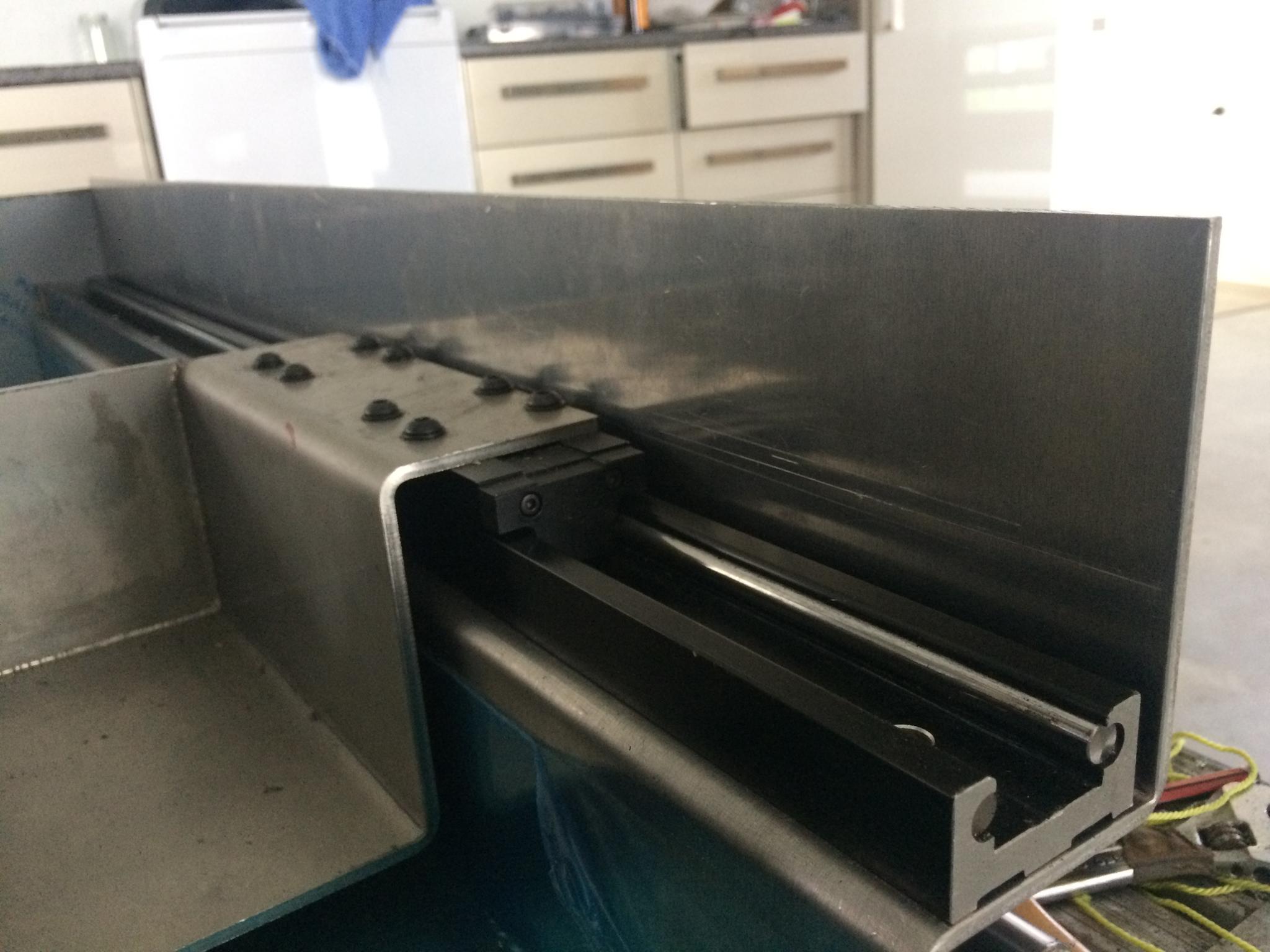

    there's a cool new machine on the market called an OMEO ( google if you like..... have to add NZ) which currently has no storing device in a vehicle unless its ramps or a hoist ( awkward and dangerous) it weights 70kg total.
    Ive thought of a machine that sits in the back of a suv type vehicle and when the door opens the machine moves OUT 400mm so that the front has now cleared the boot-bumper-towbar.
    a forklift like arm then lowers and picks up the omeo by its handles. this is then automatically locked to the arm
    gears etc lift it up 650mm and then the whole lot moves back into the vehicle. No tiedows needed as its locked.
    having problem with the "forks" moving from parked position ( right forward ) to the end of the 400mm overhang
    Thats why im here
    I need a ballscrew mounted on the side of the machine which is then attached to the fork base plate so as powered it moves the whole fork outwards 900mm

    Actuators can t work as the amount of travel is 900mm +- and most actuators are 2s + ? and i only have 900mm to fit it in
    It cant stick out the front or back
    I use an actuator to push the initial platform out the 400mm which works well.
    speed isn't a problem but i think fully in to out needs to be 15-20 secs or we could all be dead waiting for it to arrive
    thanks Richard

    I have a machine called a Abiloader now which does just that with my manual chair. boot goes up chair comes out on arm and drops right buy my door. Brilliant but my chair weights 12 kg Not the 70 of the Omeo
    have attached My drawings which is what i designed it on. Ive only done 12 hrs cad training but think ive done ok
    Managed to get all the plates-pans etc made by engineering firm off them
    dont seem to be able to load my dwg files!!!!! will try later

    just a photo of the top of the panel where the ballscrew would attach, image screw fixed by bearings ( on its side) on the 60mm upstand
    the ball housing fixed down where the 8 screws are
    I took video but can find compatible file to attach here
    thanks Richard
    just noticed my other drawing didn't come over
    might help visualize
