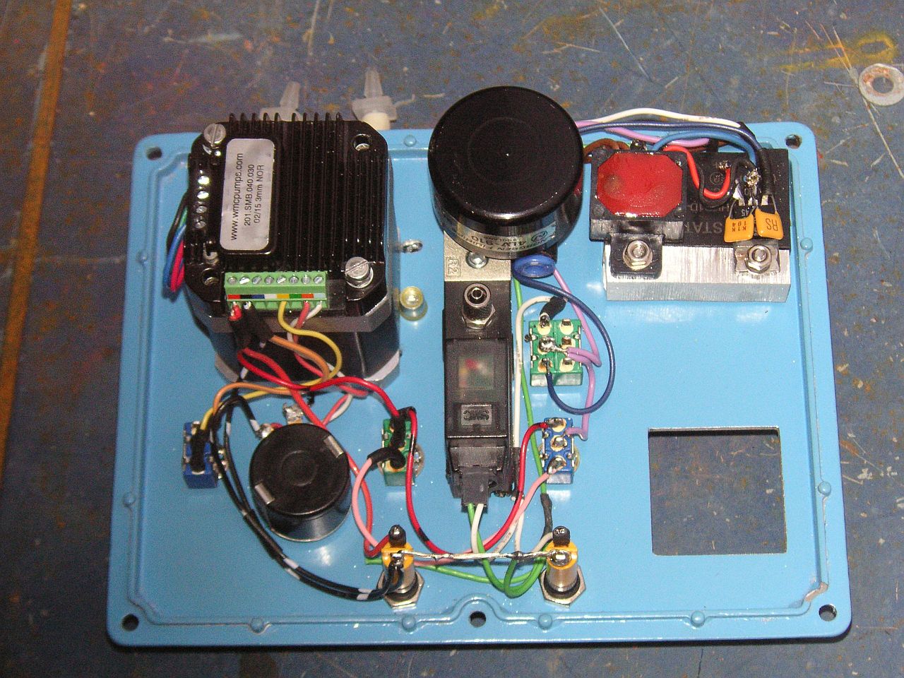

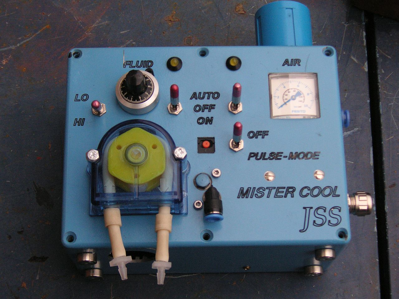

    Complete control
Name:	Mister cool-1.jpg
ID:	27164   Click image for larger version.
Name:	Mister cool-2.jpg

    Quote Originally Posted by johnsattuk View Post
    Complete control
    Yes, I had forgot about that.
