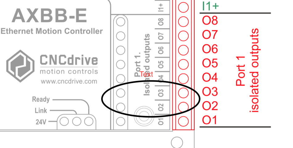

    I'm hoping one of you fine chaps can help me, I have set my VFD up manually and tested the spindle to make sure it works as expected but I now want to connect it up to the AXBB for speed and on off control and maybe forward/ reverse although I'm not sure how useful the reverse would be?
    I have moved the jumper on the VFD and set the PD00.. values for external control as shown in the manual but the wiring has me confused. I have also removed the jumper on the AXBB to allow 0-10v control.
    In the AXBB manual it shows the following

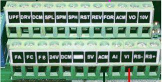

    and the VFD has the following

    I have no idea what to connect and I dont want to screw up the AXBB after my last experience with the Charge pump output!
    Will i need to connect a relay for switching or any kind of protection between the AXBB and VFD?
    All help greatly appreciated
    Connect the VFD ACM (analogue ground) to your 0V/GND level, and the AXBB analogue AO1 output to VI input to the VFD. That gives you your 0-10V control.
    Now, I expect O2 and O3 outputs are designated forward/reverse, so connect these to the FOR and REV inputs to the VFD. As these are digital inputs to the VFD you'd best connect the DCM (digital ground) to your 0V/GND as well.
    You say you've set PD00... : so I guess you've unlocked PD000, PD001 = run control = external = 1?, PD002 = operating freq = external = 1, PD044 = FOR = 2, PD045 = REV = 3, PD070 = 0-10V = 0 etc?

    Hmm...do I need anything else connected? I have dcm connected to 5v0 ground and isolated outputs 2 and 3 to the for/rev terminals and then I have acm connected to the power out 5v0 and Vi connected to the analogue out on the AXBB but I'm getting no control whatsoever
    Sent from my SM-G920F using Tapatalk
    The digital inputs to the VFD are referenced to the digital ground, DCM. The isolated outputs that you're using on the AXBB are open-collector outputs to the AXBB's 24V0 supply. So, rather than connect DCM to 5V0 connect it to 24V0. It's possible, of course, that your 5V0 and 24V0 are commoned in any case depending on your PSU wiring.

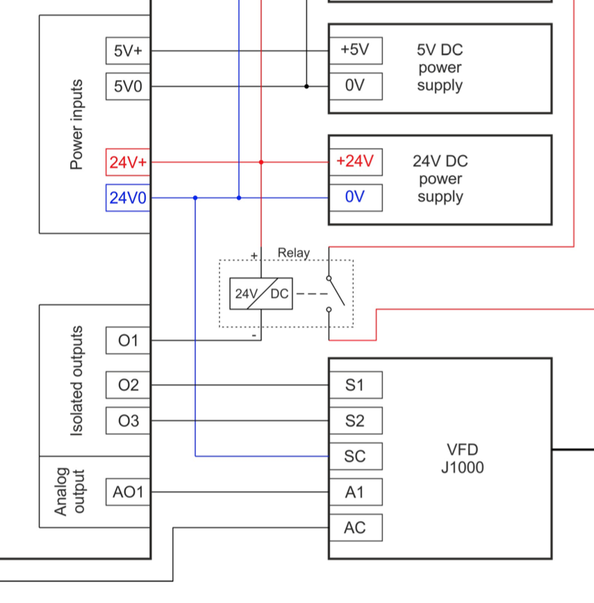

    The AXBB manual shows the 24V0 being used as the ground reference to the digital outputs to the VFD controls.
    Also, there's a jumper next to the terminals on the VFD that needs to be set correctly.
    Gerry

    The 5V0 is simply the 0v reference for the 5V supply. Similarly the 24V0 for the 24V supply. You *can* connect these together - it just means that the supplies then share a common reference.
    The isolated outputs from the AXBB are (I said Open Collector, from recent posts it's clear these are Open Drain - difference in transistor technologies - FETs vs Bipolar, but ignore that). This does mean though that the output FET Source is connected, in the case of the AXBB to the 24V0 supply. Therefore, to switch the digital input to the VFD (which is to provide a low-impedance path between VFD DCM and FOR/REV) then you need to connect the FET's source (24V0) to the DCM line on the VFD and the drain (O2/O3) to the FOR/REV input on the VFD, or it simply won't work.
    One other thing to try, to help diagnose your problem - you're 3-core CY cable - with the DCM/FOR/REV wires - just try shorting the other end so DCM & FOR are connected - you should see the VFD display change (from memory it goes from a flashing display to a solid 00000 to indicate a demand for 0RPM... but that's just a distant memory).
