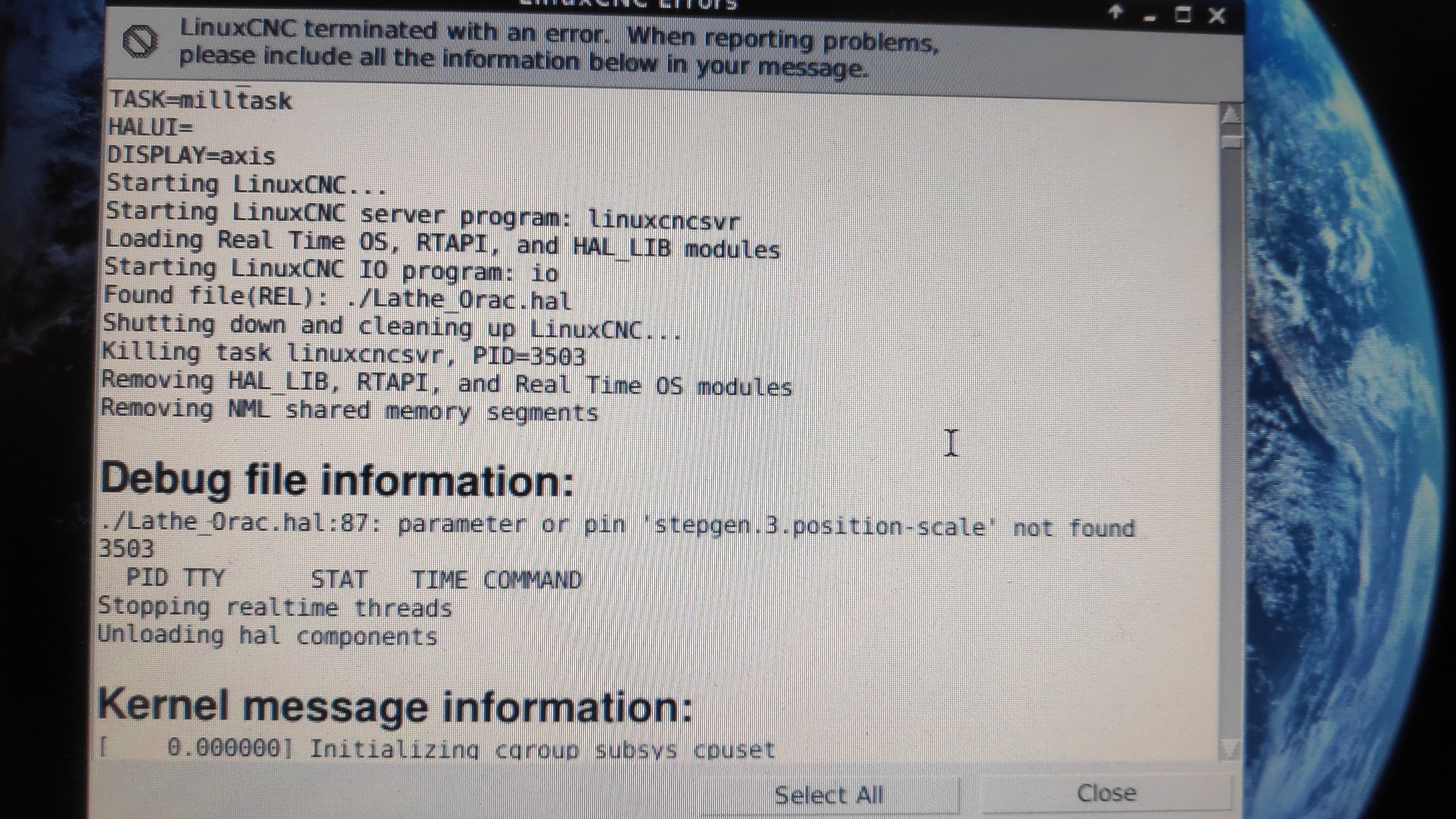

    Now when I try to run Linuxcnc I got this message:
    /Lathe_Orac.hal:87: parameter or pin ‘stepgen.3.positio-scale’ not found

    Still stuck Here when try to run linuxcnc

    Well there are more people on the linuxcnc forum that do understand it. But are you sure that the error message that you have put up on here and the linuxcnc site is correct. /Lathe_Orac.hal:87: parameter or pin ‘stepgen.3.positio-scale’ not found

    Ok but that is a different error in the screen shot as the spelling is different.
