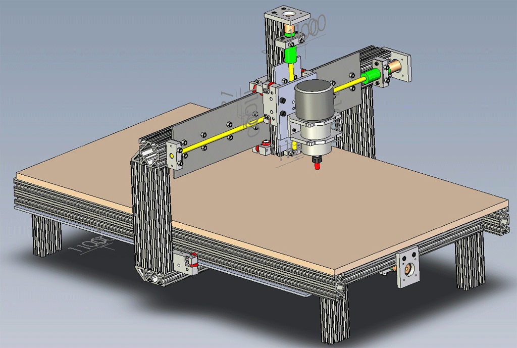

    Here is a pic of the build that I am basing my build on, it was the best example that I could find to meet my requirements.
    Relatively straightforward construction (we'll see)

    What size bed are you thinking of and how do you see the belt drive working on the x and y?
    Bed size will be 34" x 24", this is the max size I can accommodate where it will be located.
    X axis will have a stepper driven shaft running the width of the bed with a pulley at each end, a similar configuration will be at the other end of the bed using stub shafts perhaps. The two belts will be fixed to the lower section of the moving gantry.
    Y axis will have the stepper and a couple of pulleys mounted on top of the gantry, belt will be attached in the area of the linear carriage.
    These are my ideas at the moment, when I get the construction started then I will be able to appreciate the configuration better.
    Good choice on the stepper drives. Ive got the 542's and their really good.
    I take it thats not the actual drawing of your machine but just in case, Don't mount the main y beam like that cus it will move all over the place. Extend the side supports up and fix the beam top and bottom. if your using the plate and skate bearings then also extend the plate to the side support. that will make it much more rigid.
    Theres quite a few other bits that could do with changing but I dont want to be to negative
    I spent the morning wiring up a test rig to see if I can get the stepper to turn, then the missus arrived home from work and we went out, so maybe later.
    The drawing is a machine i'm modelling my build on, I plan on resting the Y axis gantry as per the drawing but using some plate material on the end face and down the side of the gantry support for strength, and yes I plan to extend the carriage plate across the full width. This decision is based on how I think I can physically secure the extrusions together.
    I generally tend to over engineer things, so we'll see how this goes. I'm held on the main framework waiting on some more extrusion, i'm getting it buck shee, so willing to wait, well so far ....
    Comment away about your ideas for change, all welcome, this is all new to me so I like to weigh up the options.
    Been there, worked fine indoors as a trial but when i set it up on the machine nothing...... 1/2 hour of head scratching and I realised I hadnt done the driver test for mach to take over windows, as usual operator error....lol
    Anyway back to your machine. Over engineering is fine but there are a lot of redundant parts in that design, before I stick my oar in I need to know a few more details
    Are you using the skatebearing arrangement, what are you cutting, what is the power of your motors and what are the sizes of the 8020?
    >1/2 hour of head scratching and I realised I hadnt done the driver test for mach to take over windows, as usual operator error - tell me more
    yes i'm using the carriages with bearings etc
    plan to cut acrylic, various woods, aluminium alloy if I can
    Motors are from Zapp SY60STH88-3008BF wired bipolar parallel
    8020 (or equiv) sizes for base frame tba
    8020 (or equiv) for gantry is 90 x 90 sq section, supported on 2 x 45x45 sq sections

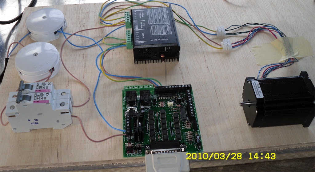

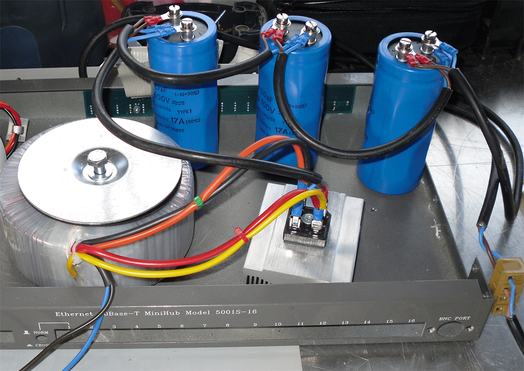

    Managed to get doing a wee bit today.....
    I wired up the unregulated power supply, outputs 58Vdc
    I also wired up the optoboard, M752 driver and one of the steppers, unfortunately I couldn't get the motor to turn YET !!! made the relevant settings in Mach3, but no joy. Is it a null modem cable - think so, it's an old laplink cable. Tested using a laptop, the parallel port appeared as ECP port. Opto and driver boards show power leds fine, on power on the stepper "clamps"
    Enjoy the pics.

    Quote Originally Posted by compfranon View Post
    I hope you have made some progress but thought that a couple of things might help. First off, I guess that your comment about "null modem" is a red herring, or at least I hope so. A null modem cable only ever refers to a serial comms cable. All this is very old hat now and you rarely see them. It was all about whether the transmit and receive lines were straight or twisted (one only of each) The vast majority of laplink cables were serial, so if it really is one of those then you have the wrong cable - but then you would have had to hammer it quite hard to get it to fit a breakout board!
    Even genuine parallel cables can be insufficient. Some were produced for restricted use, typically old printers, and don't have all the conductors. For cnc use you need them all. It is worth checking the continuity of all the conductors in the cable.
    On a more constructive note, this thread on the build your own CNC forums describes one guys attempts to overcome a similar issue and has helpful lists of his parallel port settings.
    http://www.buildyourtools.com/forum/post/1049298
