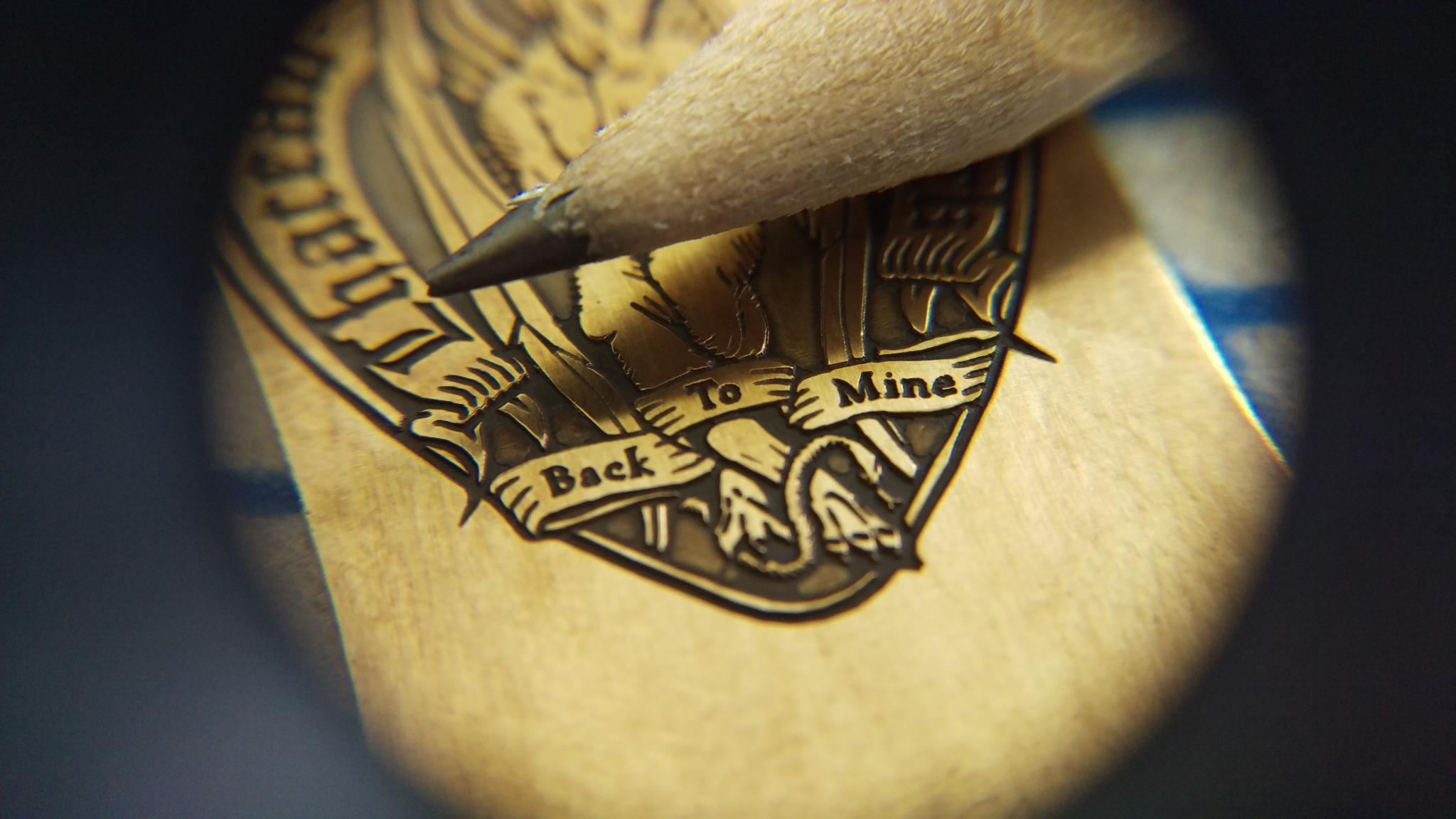

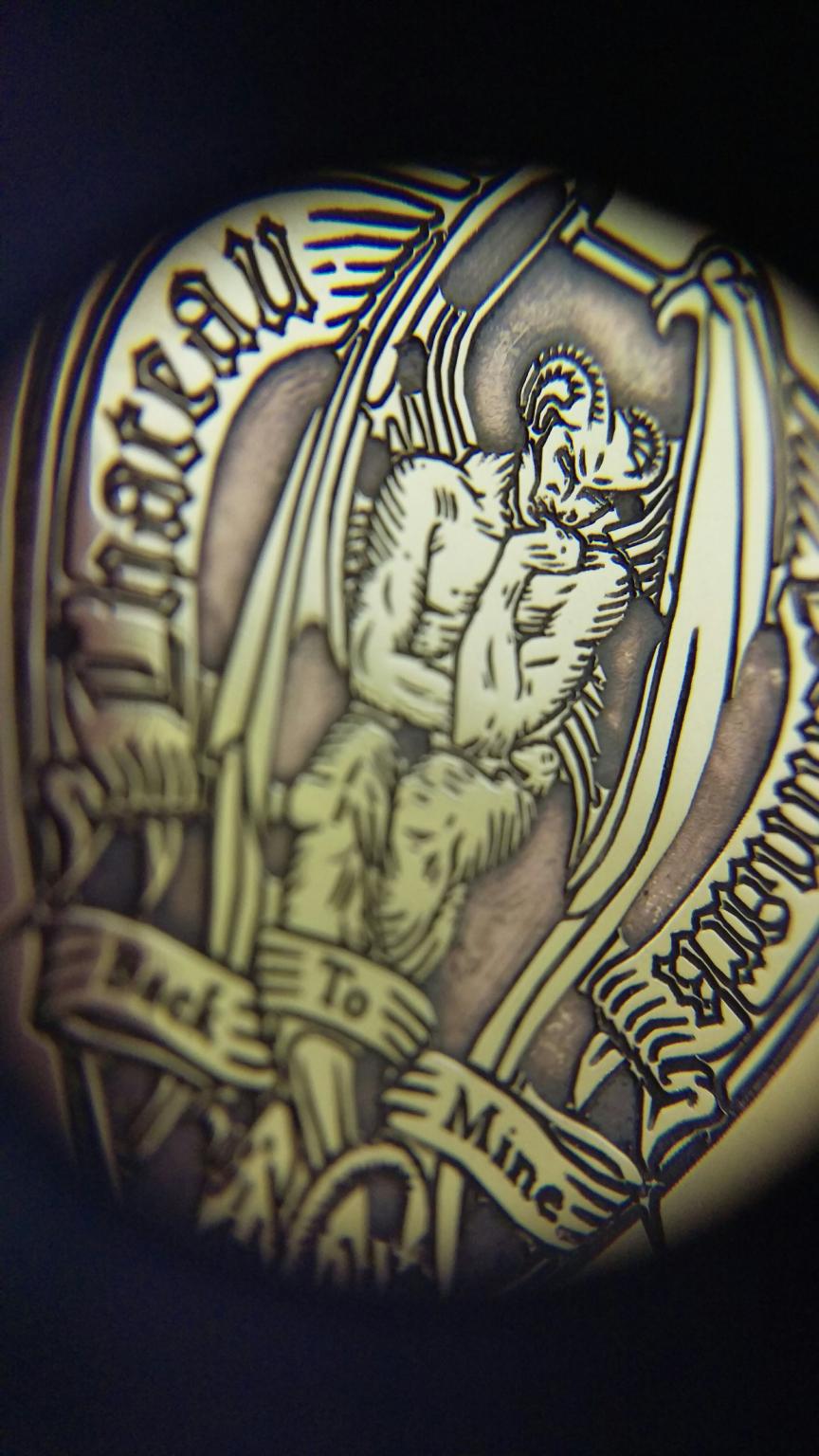

    I've been engraving a bit of brass recently (pics attached below) - and you really do want something that's accurate and robust - particularly squareness and accuracy on the Z, as just a bit of variation can spoil the line (too thick or too thin). The good news is that you can build something that'll do the job at a decent price. It'll last you and you'll learn something and have fun in the making of it.

    Nice work there pal (or should it be Wal? lol) - what sort of cutter did you use for that?
    Standard four flute carbide, 90 degree chamfer mill. The cheap engraving tools aren't sharp enough for this level of detail. I also tried the super sharp engraving tools that you can pick up for around £8 a go - a waste of time - the tips break off within seconds of starting the job..!
    EDIT - in addition I also used a 0.6mm square end mill to clear the larger areas of the design.
