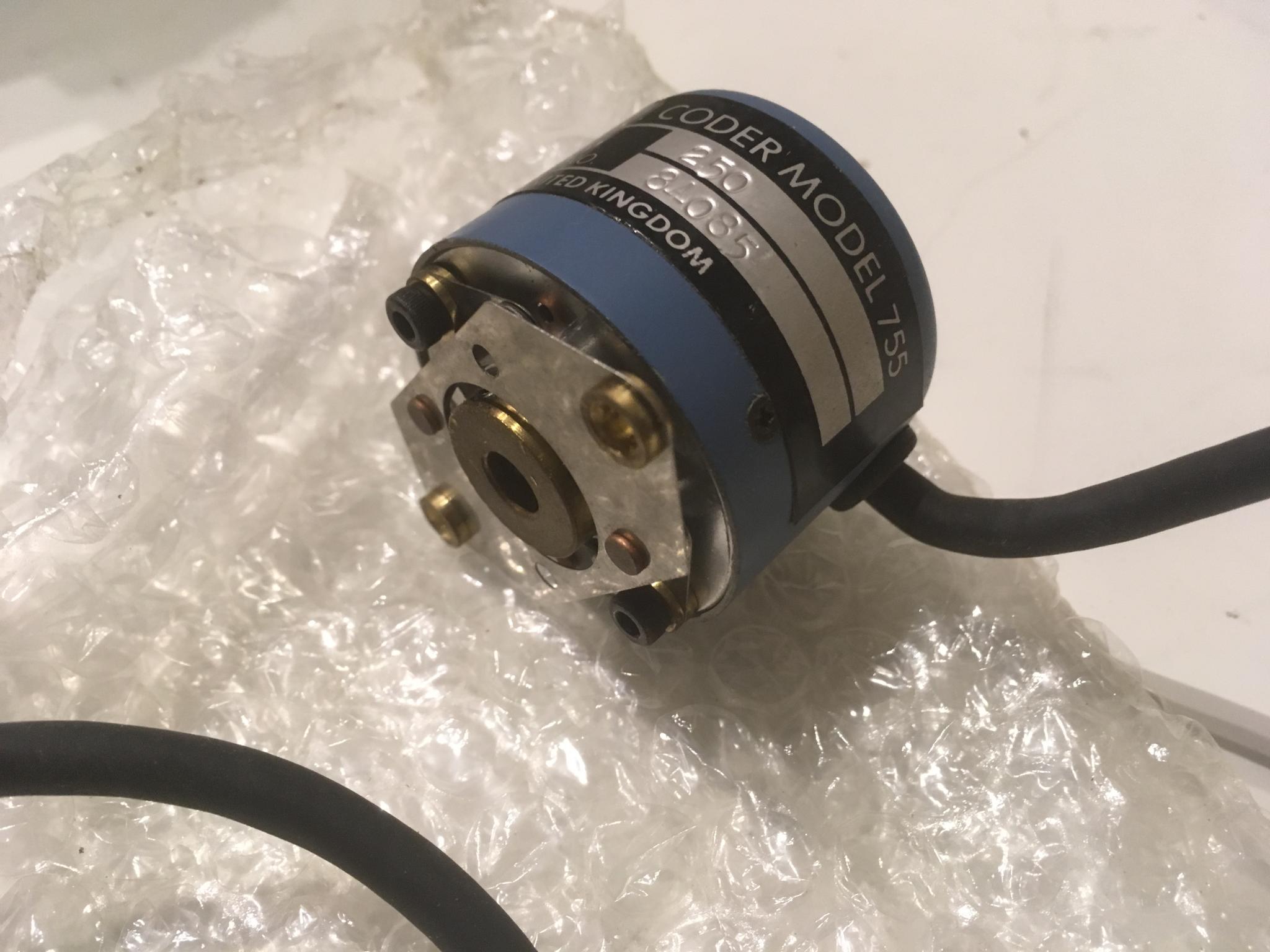

    Do you know if the encoder below are quadrature type?
    Accu 755 1000 pulses/rev

    Would you recommend to follow this route to a newby or the risk of failure is too high?

    I would guess that is a quadrature output incremental encoder, however searches have not found any manuals for a 755 encoder.
    How many wires does it have?
    Ideally you want encoders with differential outputs, which means you're looking at a minimum of 6 wires (+V, Gnd, A-, A+, B-, B+), plus possibly an index pulse (Z-, Z+).
    Everything has the potential for failure, but provided you're willing to learn, then most things are possible.
    9 wires;

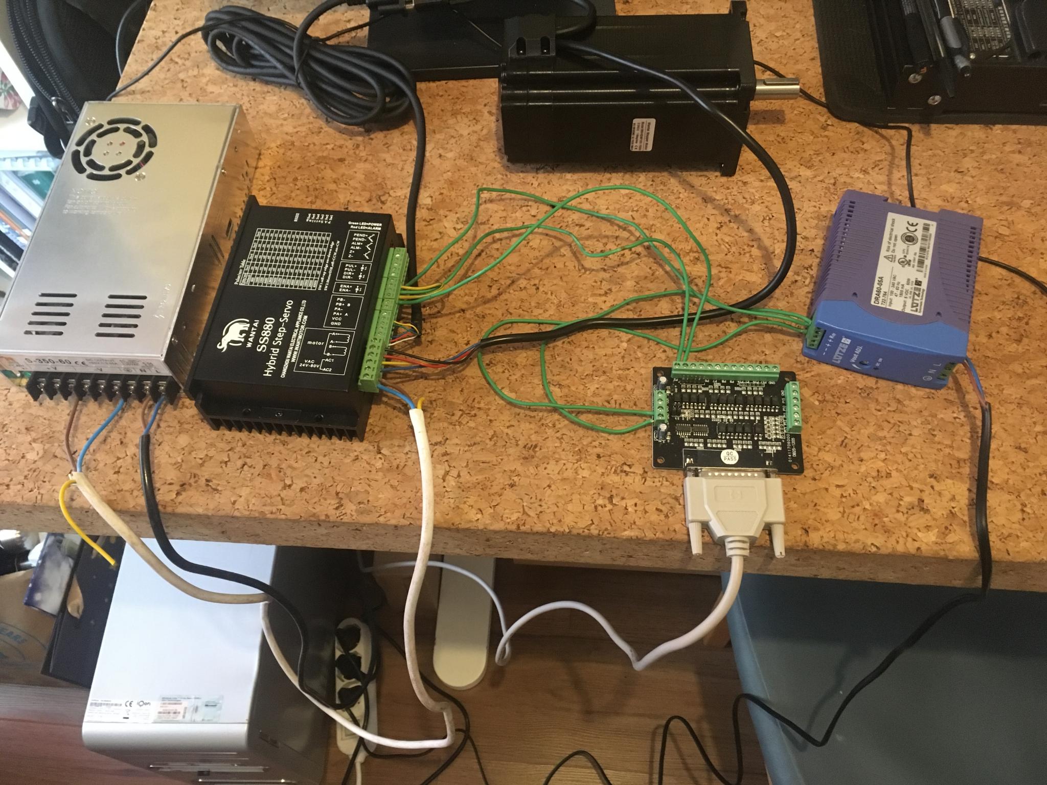

    I’m a bit worried to follow a servo based approach;
    I’m uncertain on what to do...

    Here I’m with some updates;
    all new electronics and motors;
    looking at the coupling

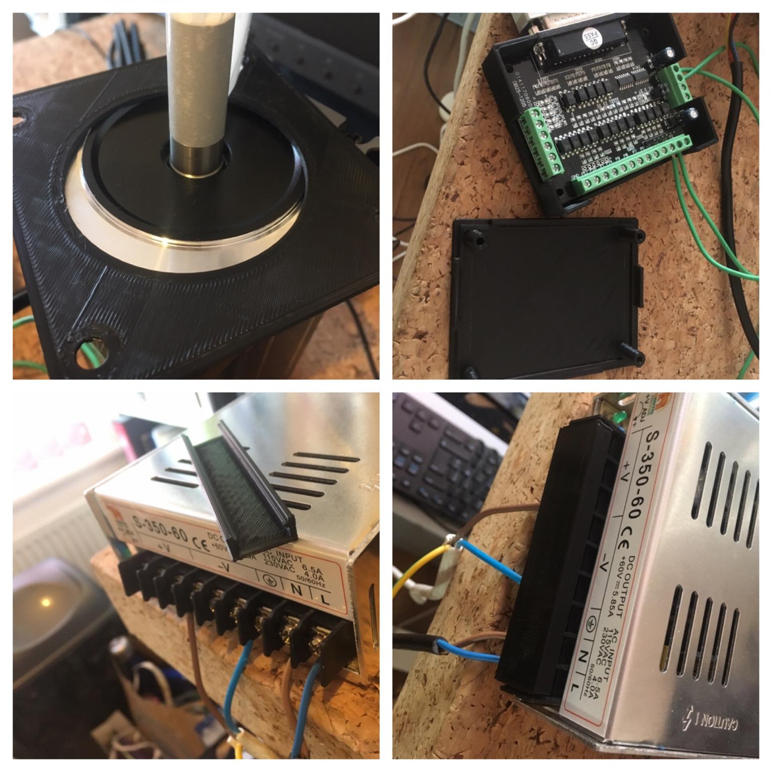

    Today I worked on some stuff mainly for safety;
    - plaque to allow the motor to sit perfectly flush on the Cnc frame (there is a 2mm step on the moto housing)
    - cover for the power supply, so that the risk of touching the 220v cable is lower;
    - case for the BOB (not my design)
    I’ve also made a mask so that the new motors will be perfectly centered respect the old motors.

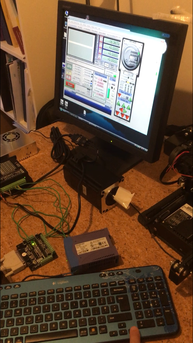

    machine perfectly running thanks to a colleague
