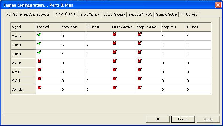

    Yeah non of the pins are correct if i operate X axis my Y axis moves etc hell knows why !
    Im in the process of finding the right pins for the right axis. so far i have
    X - Pin 8
    Y - Pin 6
    Cant find the z axis yet. also the motors are only going one way any ideas?

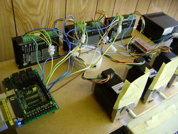

    I am using the same breakout board so should be able to point you in the right direction.
    What do you have your axis pin settings set at in the Mach3 software?
  7. #17
    Hi Steve,
    I think i have it now but if you could run my image past your settings it would be appreciated.

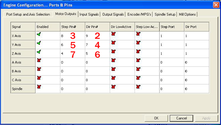

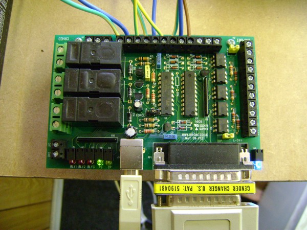

    Checked my settings and attached a jpeg showing what mine are set to, your pin outputs are completely different to mine to the point were I can't see how it is working at all! Are you sure you are using a uniport board? can you post a photo of it. This could be down to your wiring though, I would just double check your connections again.

    Sure here are a couple pictures
    I will try my set up with your pins and let you know the outcome.... bare with me.

  10. #20
    That's not a Uniport board.
