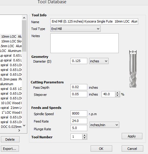

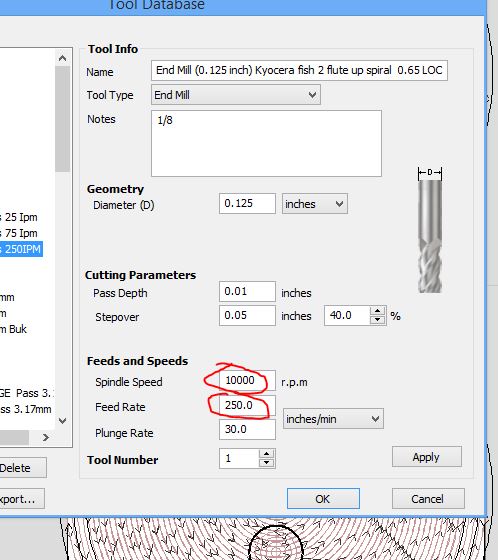

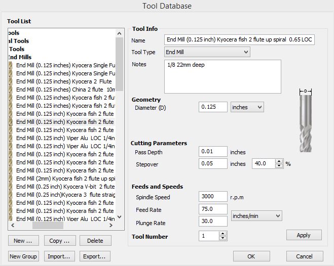

    I have similar machine, its not strong but does the job. As a starters do same depth of cut as your bit diameter and you will be OK, you could do maybe even aluminum, but you have to scratch it.
    Here are some speeds and feeds which can serve you as starting points.I lost with these a couple of weeks and a lot of broken bits. For this type of machine they are OK, even if many may disagree:
    everything in imperial,1/8 or 1/4 it doesn't matter as usually the machine is the limiting factor here , not the bit , though more careful with longer or thinner bits :
    soft plastic , its scratching but if you go deeper with flimsy machine, it melts, better use single flute if speed is needed.

    MDF,wood, works for phenolic plastic also, composite panel
    Harder wood

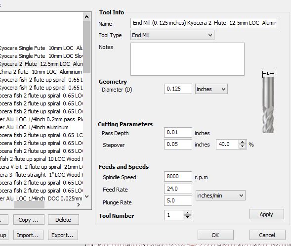

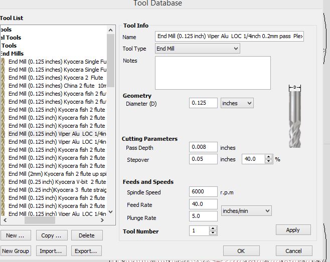

    Aluminum, i told you its scratching. You could change the depth of cut. 8000rpm is pretty the perfect speed for this material
    with 2 flute
Name:	aluminum 2 flute.JPG
    with 1 flute, which is better in my opinion
Name:	aluminum1 flute.JPG

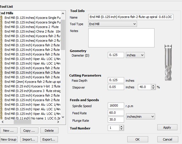

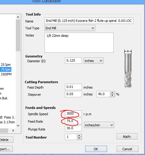

    you could variate things if need job done faster up to where drivers, machine, rigidity holds, see 2 examples below:
    Means as soon as the CL chip load stays the same its Ok.

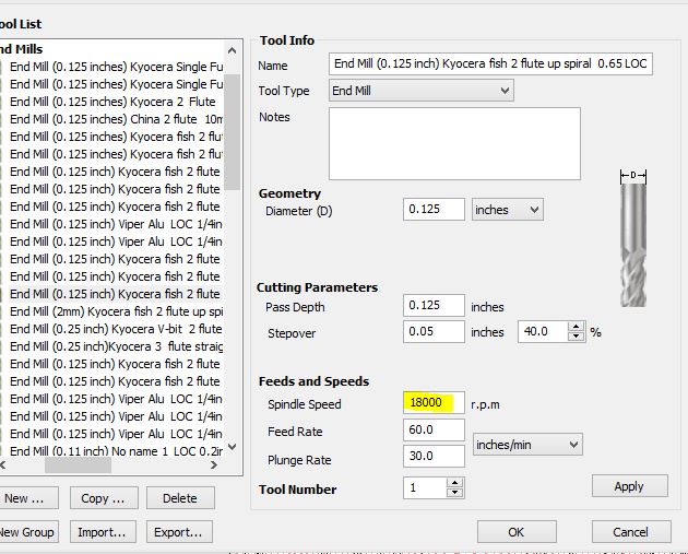

    However its worth noting that is not a good idea pushing the spindle more than 18000RPM if you want to last. The bearings i mean.

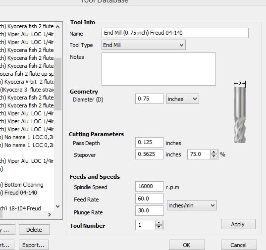

    3. Bigger shanks are better,less chatter, but more expensive. Use them for precise jobs. Or paid ones. Sometimes i prefer using 10x 1/8 bits 1/8 shank, than 2x 1/8 bits with 1/4 shank, as they cost exactly the same, but 10 bits last longer than 2. Especially on not so sturdy machine. Its a compromise of a kind. Same with the V cutters.
