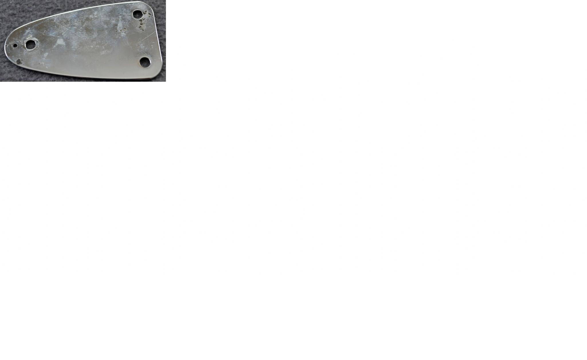

    Is this something that is reasonable to ask a hobbist/machinist to make as a one-off (see attached picture)? It is roughly 10cm by 5cm by 0.15cm. Although this one in the picture is chrome plated, I am not bothered about it being plated. The 'real' plate also has a logo embossed on it, but I do not want that, as I don't want it to be a rip-off.
    The background to this is that this is a neck plate for a discontinued bass guitar (Musicman Stingray Pre Ernie Ball). The original neck plates don't come on the market very often and when they do, they are expensive. So I want a temporary steel plate, in the same size, that I can use on a vintage guitar that I am assembling, until an original plate comes on the market that I can afford. So the replacement would need to functionally work - it just would not look like a true original.
    I hope that makes sense? Let me know what you think and thanks for any help in advance.

    Perfectly sensible request to make - post it in the RFQ section with a bit of a drawing - better if you can offer a DXF file as well. You might want to specify the material otherwise you'll likely get people offering between mild-steel and aluminium - on second reading you mention steel but any grade/stainless? (the latter being much harder to machine).
    EDIT
    Though to be honest for a one-off, easier to cut to rough-size and finish off on an abrasive belt.

    If you had an accurate DXF (or some form of file format suitable for getting accurate dimensions from), it should be a quick job for somebody with a CNC plasma table, followed by a quick buff on a linisher to clean up the edges.
    Failing that, it could be done by hand. Biggest issue is the relatively large holes in 1.5mm sheet may cause the sheet to twist if you're not careful.
    It's the kind of shape you could do just with a hacksaw/jigsaw, followed by a file.

    The main thing about the neck plate is the accuracy of the bolt holes, the outline does not have to be super accurate. So you could put the guitar on a piece of paper and mark the hole positions, the outline could be just a guess based on the pic you provide (which is easily found on t'interweb).
    However is it form or function you seek, because the function of the neck plate is to stop the bolts (or screws) tearing through and repair washers (penny washers) would do that job until you found that hen's tooth of a pre Mk4 plate. But it certainly wouldn't look pretty

    Finally a question related to my job. As a guitar maker I would recommend that you cut that out of a piece of steel 1.5 mm should be thick enough with a fine tooth piercing saw. For a one off it is overkill to do it on a cnc. It would take about 30 mins to cut that out. I would make sure that the edges especially underneath are rounded over as screwing the neck down can put enough bend in the plate to crush the laquer. Most of those basses were ash which was quite hard but if you have an alder one it's a lot softer. I checked out the prices on the web and the parts dealers are taking the piss with the prices they are asking. Good luck.

    I would keep clear of penny washers as you have a good chance of crushing through the lacquer!!

    Yes - the plain-old washers was an option I was thinking of. Good to hear that you also think that is an option. Thanks.
  13. #9
    Yes - that was my thoughts as well. I was thinking there must some rubber washers that might do the job. However, I am going to head down the route of seeing if I can get an equivalent made before I seriously look at using washers. And thanks for advising that it was too small a job to justify using a CNC - I thought that might be the case, but I didn't know what would be involved. Lastly the only original plate I have found, for the year I need, is advertised at $180. So you are right in that respect as well.

    You could try this
    https://tonetechpro.com/guitar-parts...in-finish.html.
    It looks like there's enough there to trim down to size. You just have to check the spacing on the main 2 screws. If you're drilling out these plates make sure you've got them well clamped down (basic metalwork!)
