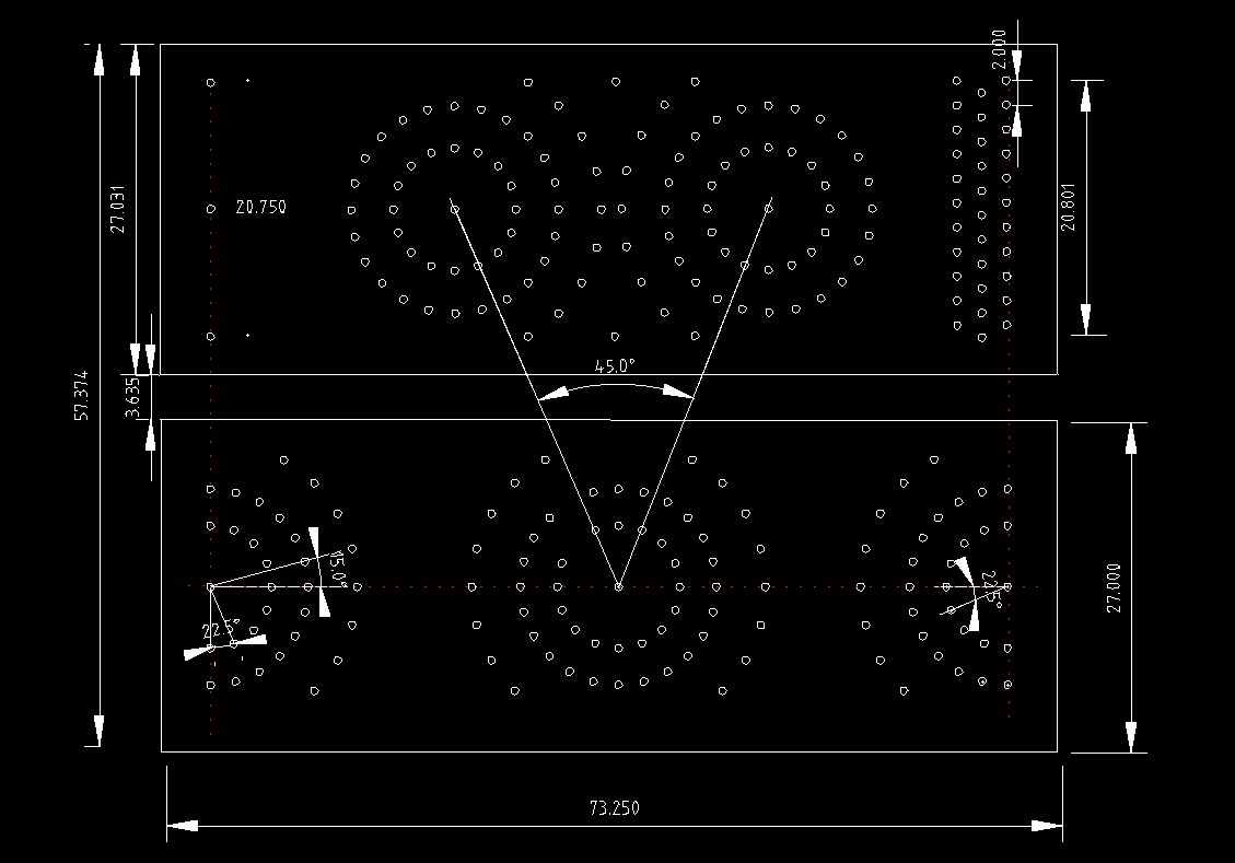

    One of the first items is to make a few fab/jig tables similar to the one in your video, 12 - 25 mm thick. They will have custom hole patterns not the standard square pattern. I figured since I'm going to build a cnc table why not cover that problem too. Essentially replace the mag drill and take a 12 hour job to half that maybe less. Someone will still have to sit and chip watch. I included a sample of one table idea.Click image for larger version.

    Plenty accurate. It's frustrating being old school and from the U.S. I have to constantly convert measurements as I read. I'm always thinking tenths and thousandths. The accuracy isn't that important probably +- .25 mm between centers. Thanks, I'll look for that spreadsheet.

    Neale I was hoping you might reply. It's good to hear about the steel cuts, that is good news for cutting ipe, an extremely dense hard wood. As far as cutting the holes I could have 300 or more in 12 - 20 mm steel. Most holes are 16 mm. I put an image of a typical table jig in a previous post. The reason they need watched is because it doesn't leave chips it makes birds nests, and a lot of them. This is a stock video of an annular cutter and mag drill https://www.youtube.com/watch?v=N7Pef3zFj7Q in action. It only takes about 30 seconds to drill but a long time to clear and re position. If you look at the machine in the video I'm thinking of taking that motor and mounting it on the z axis for the drilling spindle, and a second z axis for routing.

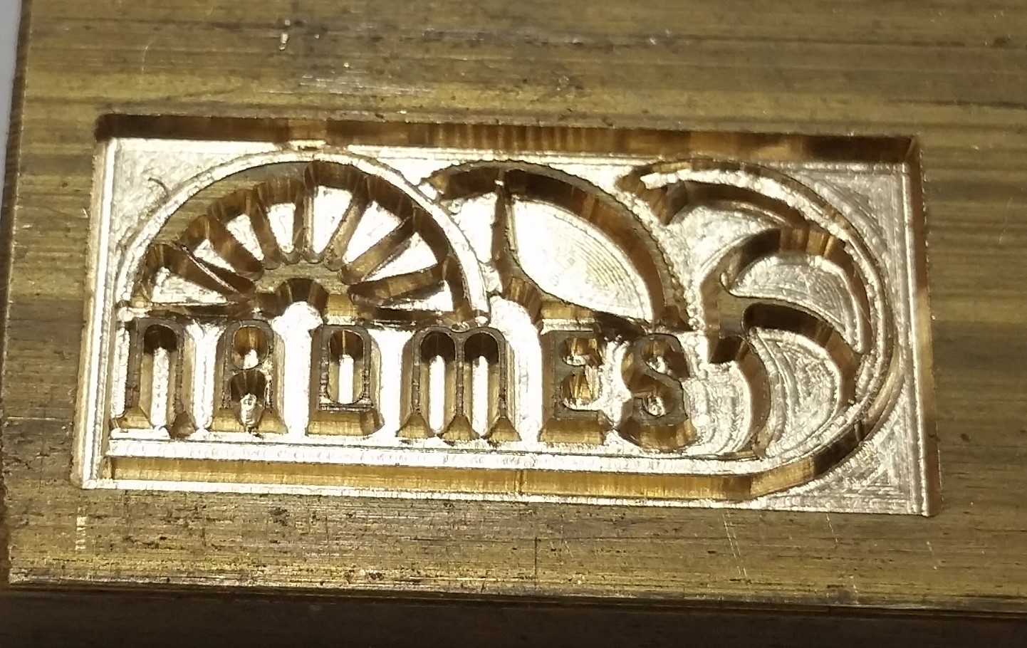

    All machines are a compromise and that's why a lot of us build our own - we can build to make those compromises in areas that don't matter too much to us and focus on what we do want. I wanted a machine capable of good 3D detail performance for engraving. Below is a first pass (don't have picture of final version) of a brass master I engraved for my local model engineering club. The recess is approximately 20x10mm, so the level of detail isn't bad for a machine designed to handle 4'x2' sheets of plywood. To do that using 3D V engraving needs good acceleration in all three axes; max cutting speed is only of academic interest! But I can also move at 5000mm/min when needed. On the other hand, you are looking to mass-produce large holes in steel but accuracy is not as high on your list, so while you are welcome to steal any ideas from my machine (as I did from others!) I'm not sure that you want to copy it.
