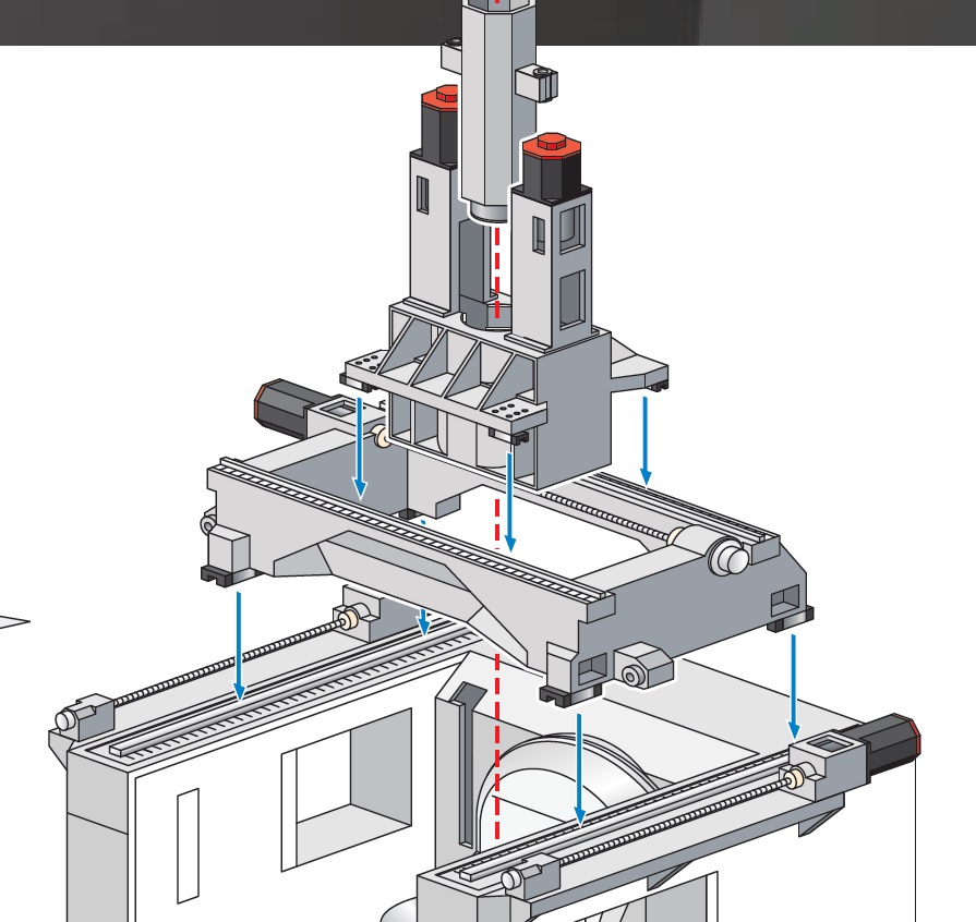

    I've watched all the videos of the MK4 and think the dual box design gantry may serve my purpose. Here's the pie in the sky.
    A multipurpose machine, mill, drill and plasma. Forget the plasma part for this discussion. I would like to bore mild steel 10 - 15 mm plate. I figure I'd probably have to change out the z axis spindle depending on the operation, a lot of details would need to be looked at there but now my question?
    Could a dual box design like routercnc MK4 generate the forces needed to drill a steel plate using an annular bit? Holes would be 10 to 20 mm. I've got a need to drill large plates 1200 x 1200 mm.

    With the right spindle on my machine it probably would, but the reason I went with that overall layout was I wanted a large cutting area for sheets of wood, but still be able to mill with it.
    If you don't need anything that large then a either a regular mill style (column at the rear XY table in front), or a fixed gantry with moving table would be better.
    Either way you would need a spindle with high torque and low rpm, in the hundreds of rpm for the annular drilling.
    Fixed Gantry won't give me the versatility. I'm thinking of a spindle motor/gearbox like from a mag drill. The delimma is z axis design. Yours is the closest to what I've imagined but can it be modularized. Something I could swap out for high speed operations. I've even considered electro magnets to lock it all down during drilling. It's probably not necessary with your design although I don't think I would use any aluminum.
    Thank you for your thoughts. You've built a great resource here.
    Depending on the accuracy you need to hold over time if you swap out a spindle then it might not go back in fully trammed. Maybe you can provide some kind of alignment pins or something, but it needs some thought.

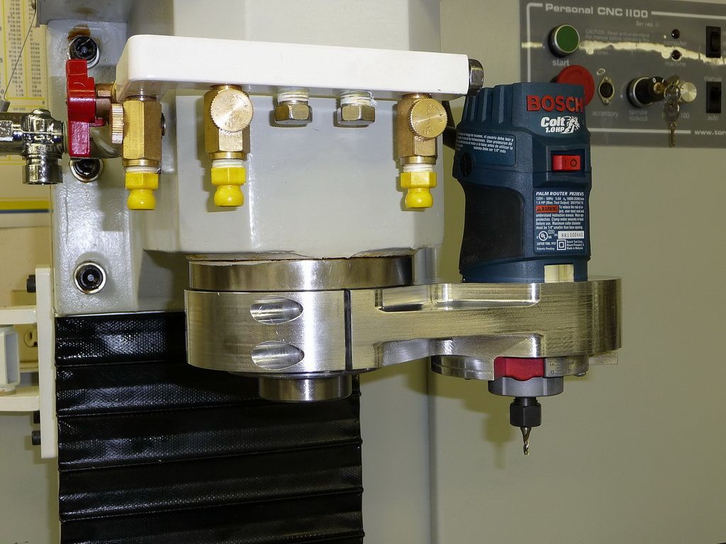

    Therefore another option is to have 2 spindles - have the low speed spindle in the main housing. Then on the lowest part of the Z axis have a thick plate hanging out the front with the high speed spindle in. This is cantilevered out, which is not so good, but might be good enough for the high speed lighter work. Some Bridgeport owners do this to give both options. Like this but hanging out the front ahead of the gantry beam:

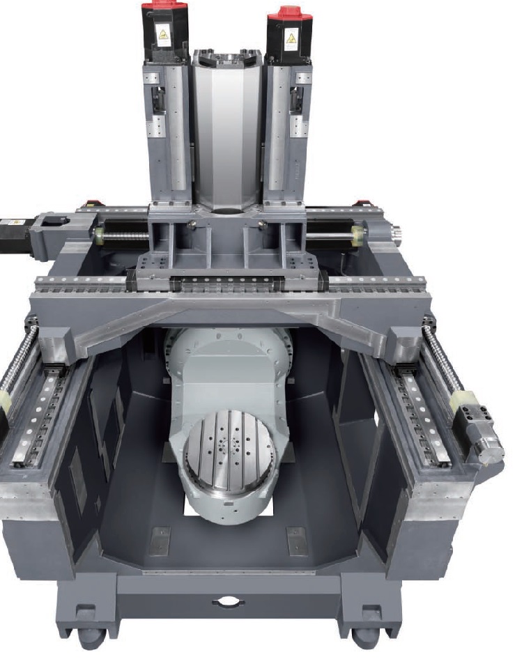

    If you want all steel construction have a look at the Mori Seki 5000 for ideas:
    Yes I've seen the Mori. A feat in machining. On a more realistic feat, at least for the retired hobbyist I got the idea from https://youtu.be/8OTwT0WFBmg Adam Savage Test series. A dual head plasma router. Kind of like you suggested but I don't think it could handle the forces. I'll work on some concept drawings and get some opinions. Thanks again.
