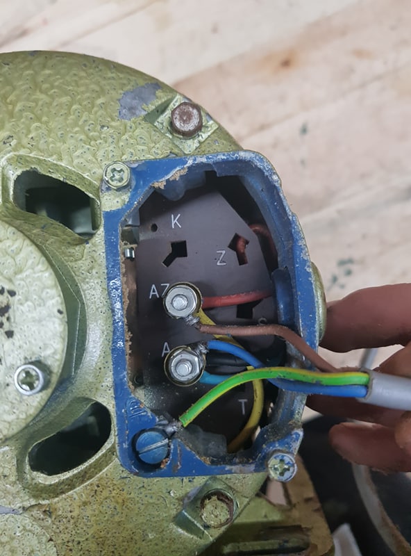

    I purchased a cheap motor controller for the drill press as it's a pain to change the belts. There is very little explanation on what colours should go where. So far I've established that the yellow is ground and red is then neutral. The other colours then have continuity with live.
    I've got some images here to show what I've got to try and figure out.

    This is the cover plate for the motor showing the wiring diagram.
    Any help would be most appreciated.
    Rob

    That speed controller is for a DC motor, not an AC motor.
    The only way to reliably control the speed of an AC motor is via varying the frequency (aka VFD).
    That speed controller will likely just be a basic SCR circuit, which is designed to run DC motors from an AC source.
    It's a 400W 220V controller for a AC220V 50/60HZ motor.

    That's what I managed to find also, I'm only stumped because my motor does not actually use a capacitor. It's an old Hawker siddeley one, at the moment I've rewired it back up with a new cable and given the machine a good once over while I had it in pieces. Runs smoother now for some reason!
    Not to worry, I'll try and get it to run on my Myford as that has a capacitor.
    Thank you anyhow!
