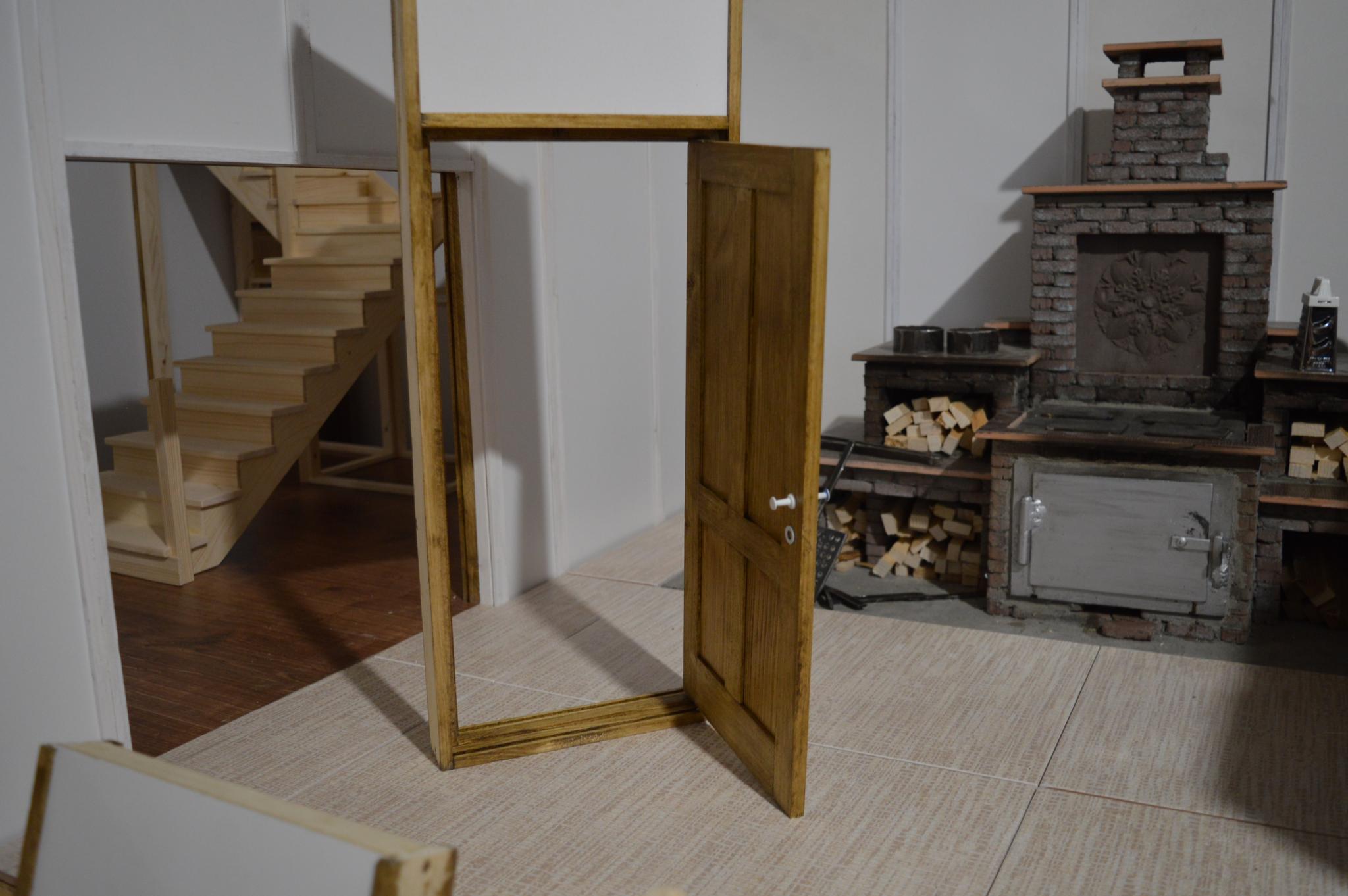

    I build miniatures and film them, next to pets, as a hobby. The size of the pets forced me to go with 1:5 scale. That is why the smallest doorway has a width of 16-17cm and I need a robot body that can fit through that easily, and I would go with 12-14cm for that. The height of a door is 40cm, but in order to make the robot cute-ish, I would have him a bit more than half a door height. Click image for larger version.
    The structure/platform that will house all miniatures will take me until march to complete. It is designed with a thin floor and ceiling, and tested, that I can move a max 2kg object, with the help of neodynium magnets. As I film them, I need for the robot only the illusion of movement, and not necessary the actual robotics. This would be nice just to entertain the kid part of me, but it is optional, and I will easily dump it if there is not enough space.
    The tilt/pan option would be great to save me from reaching in the frame each time I need him to turn his head or look up.
    The most important part, which is not defined completely as design, but absolutely sure as a functioning principle, is the function3/stepper/4position thing. Even if the proportions of the robot will change very much, it will still include this in a form or other.
