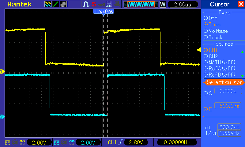

    So I've just scoped the DDCS. An axis setup as per my machine, 1610 screw, 16x ustepping -> 320 steps/mm, max speed 10000mm/min.
    As expected step frequency is ~53kHz, half period of 9.375us. Nyquist/Shannon tell us that this needs to be sampled at a minimum of 2f, i.e. 106kHz for perfect reconstruction. Puts an upper bound on my mirror code latency of ~9us, so to be safe say 5us. This is 80 cpu cycles, will it fit?? Should do, got to wire it in and test.
    DDCS defaults set dir 7000ns (7us) ahead of step therefore code running at 5us will always see this. EM806 only requires 2.5us but configuring DDCS to deliver this will risk breaking the contract woth EM806.

    So here is a baseline, the basic axis mirroring with auto squaring, but without I2C. Lag is 600ns after a lot of messing about I just stuck the logic in a lookup table and deleted all my code ;-) Yellow trace is step output from DDCS running at 10000mm/min, blue trace is the arduino step output, lag is shown in 'dt' bottom right.

  9. #117
    You're not going to get better than that!
  10. #118
    Quote Originally Posted by devmonkey View Post
    Hahaha love it. Sometimes 'ugly' solutions are just the best.

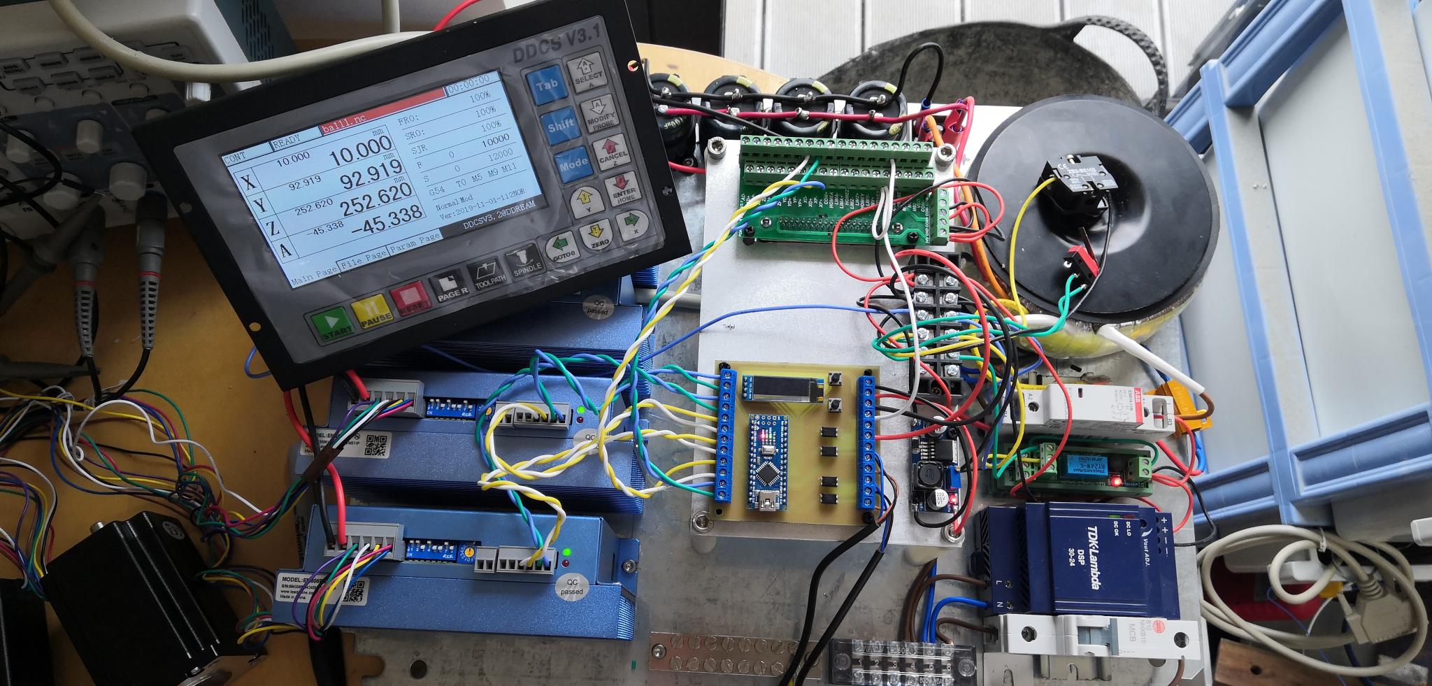

    My dual motor homing / squaring board is now working with the DDCS. Video clip below. DDCS was told to 'home' the X axis:
    1. Each motor stops when its respective home switch is activated,
    2. Once both home switches are activated the board signals home to the DDCS,
    3. DDCS now backs X away from home searching for switch release,
    4. If one motor's home releases before the other this motor is stopped until both home switches are released,
    5. Once both home switches are released the board clears home back the the DDCS and DDCS zero's X co-ordinate,
    6. DDC now moves X a pre-configured distance away from home.
    This logic only activates when a home switch is hit and the machine is travelling towards home. If travelling away from home either switch hit signals the DDCS (i.e. it behaves as a limit switch).
    The only downside of this is that in normal operation driving the machine past home in the X- direction requires both switches to activate before limit- is signalled. This is not a problem unless one of the switches has fallen off.

    Call me stupid, but what exactly do you adjust to make the gantry square once the whole sequence has finished? What is the purpose of step 4? Do you have separate cotrol of the two X distances in 6?
