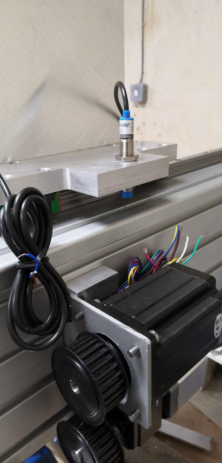

    The next step is work out how to bury these proximity sensors in the machine, the Z will be a bit tight and I may need to source a much smaller switch.

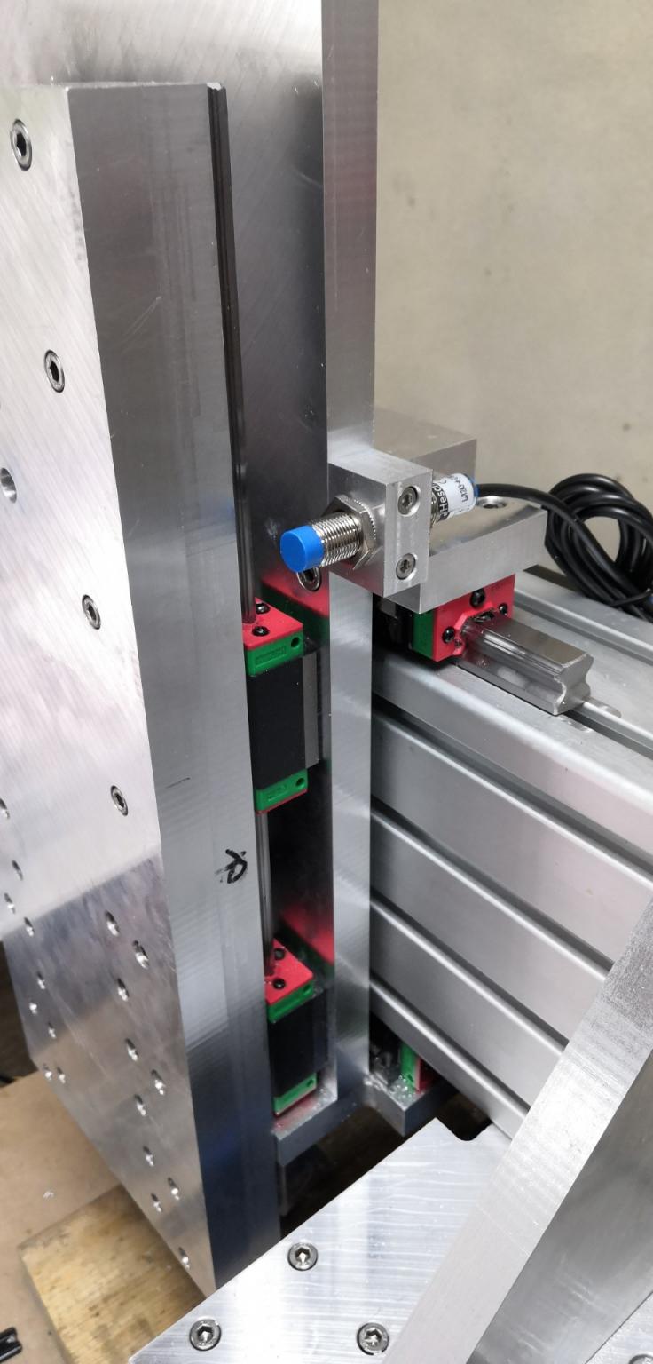

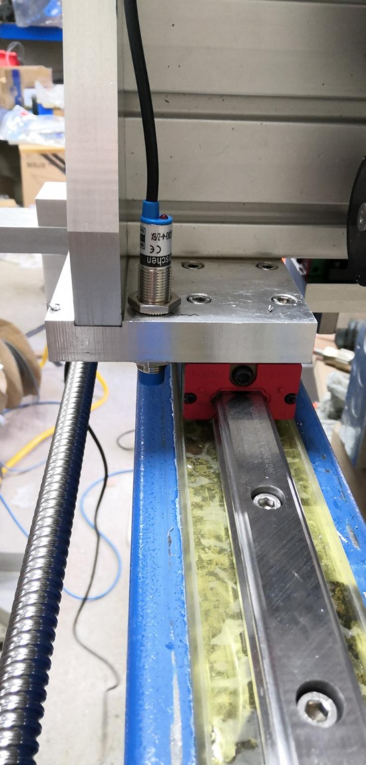

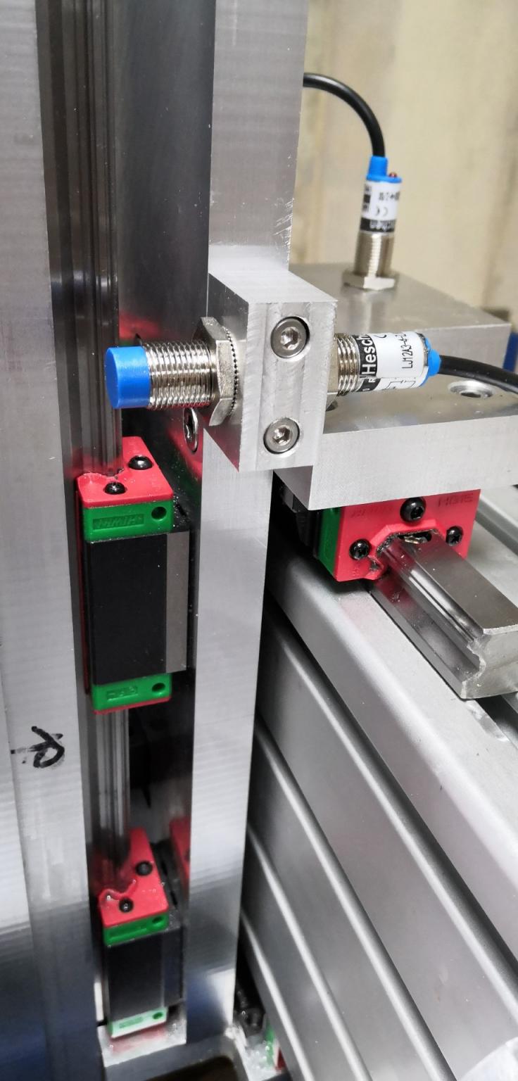

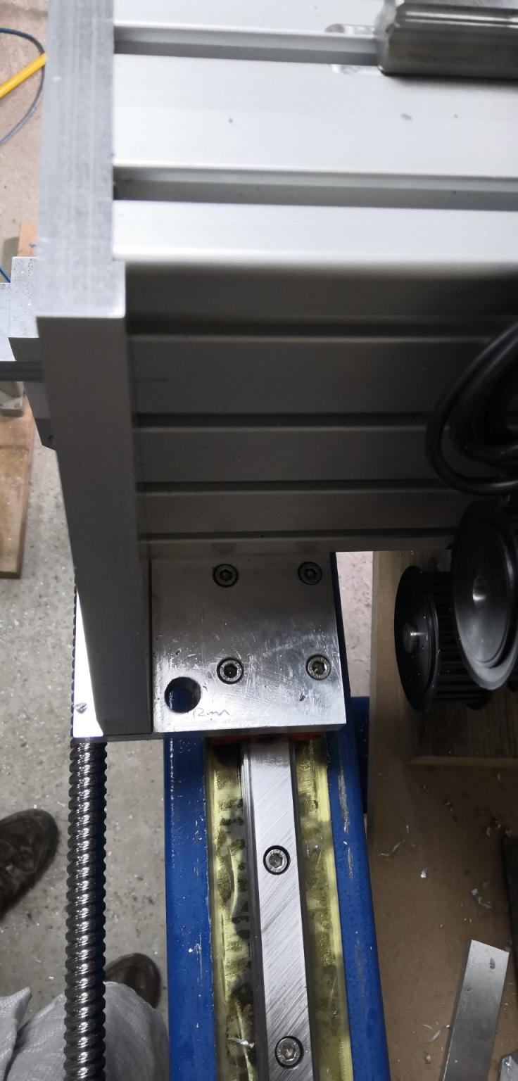

    All home switch fixings are now done, it is amazing how long the little jobs take, this was a whole afternoon. Milled up a little block to hold the Z switch, decided it would be better outside of the axis rather than inside regards adjustment. Then had to drill two very awkward 12mm holes in the X bearing plates with a portable drill, for this I had to mill up a drill guide, still easier than dismantling the gantry.
