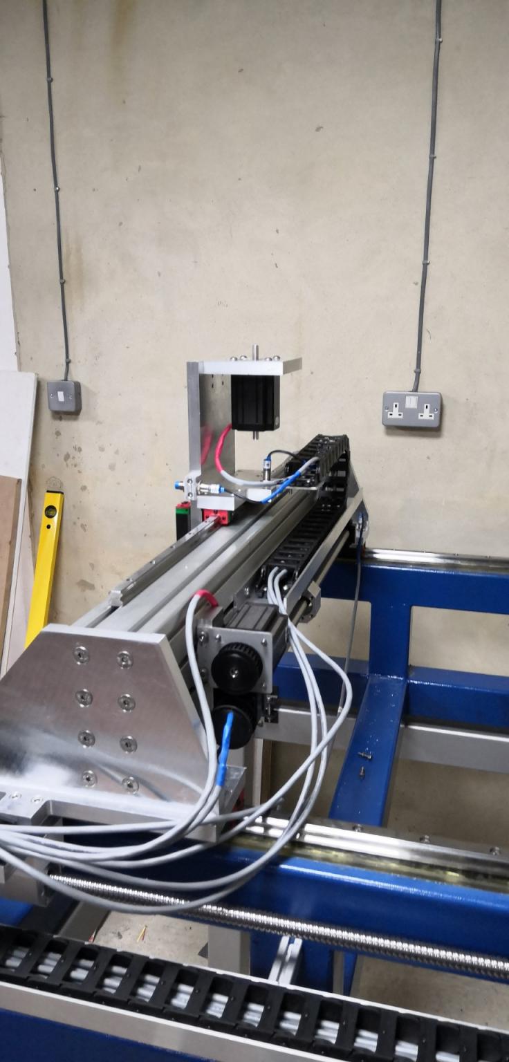

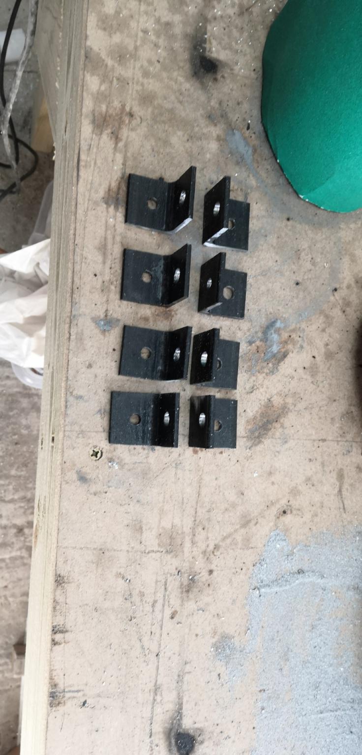

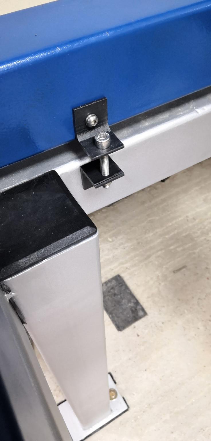

    Progress update:
    Stand is bolted to the floor and machine is clamped to the stand. I cut some little bits of angle and use M8 bolts for the clamps. So first the stand was levelled as best a possible with some composite slate tile shims and bolted to the floor. Then the machine was levelled on top of the stand (it has an M12 bolt threaded into the bottom of each corner) and checked that each bolt was bearing weight (attempting to avoid twisting the machine), then finally it was lightly clamped at 4 points to the stand.
Name:	IMG_20200616_103619 (Large).jpg
ID:	28401 Click image for larger version.
Name:	IMG_20200616_113459 (Large).jpg

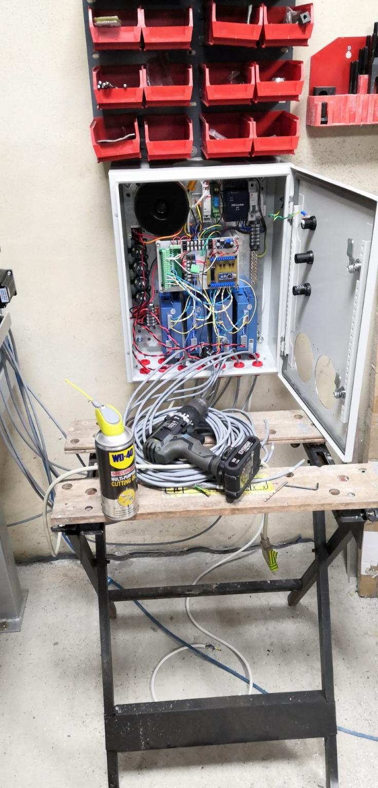

    I cut all the cabling to length and took it indoors to solder all sensors and motors, this took a few hours and rather a lot of heatshrink.
    Next I fitted all the motors and sensors to the machine and started work on the enclosure.

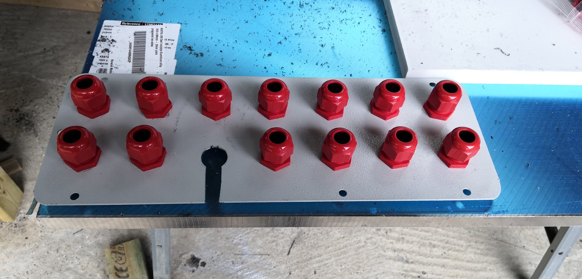

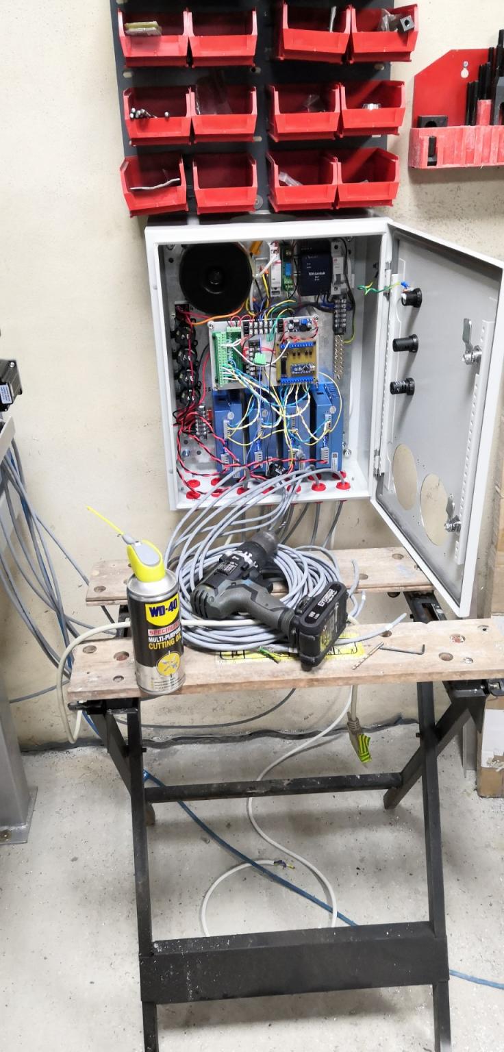

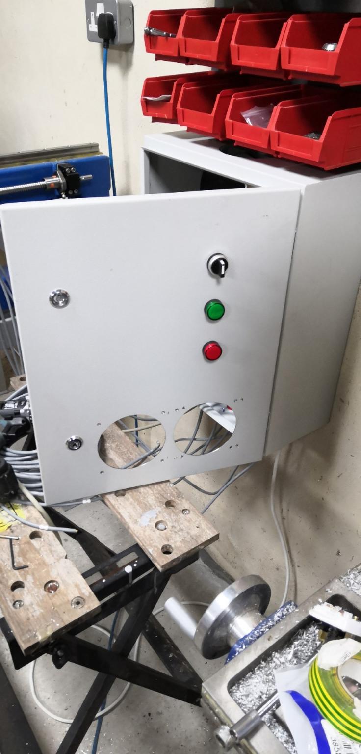

    A few trips to screwfix to further increase my holesaw collection, then an unpleasant afternoon drilling fan, exhaust, switch, indicators and gland ports in the steel enclosure. Now mounted to the wall and cabling fed through. Will do final wiring tomorrow and maybe the first machine moves!
Name:	IMG_20200617_124738 (Large).jpg
ID:	28403 Click image for larger version.
Name:	IMG_20200617_163849 (Large).jpg
ID:	28404 Click image for larger version.
Name:	IMG_20200617_163901 (Large).jpg
    That ugly slot next to the glands is for the DB37 control cable to go to the DDCS control box.

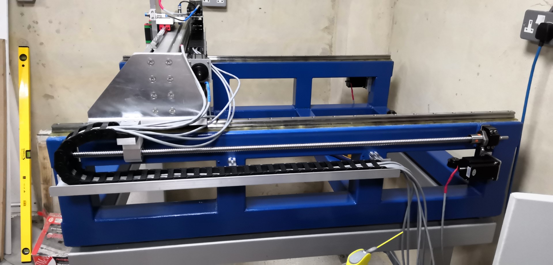

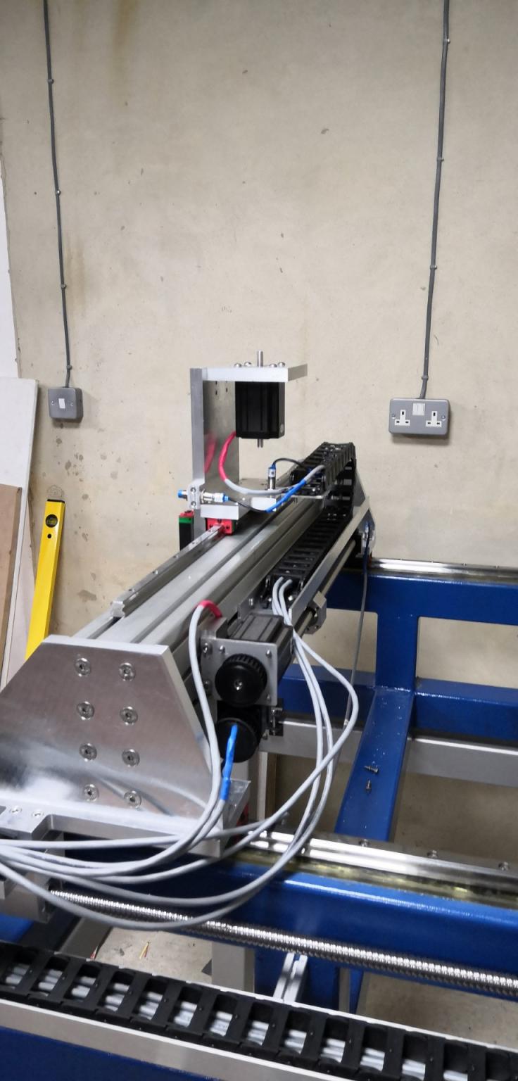

    Finally both drag chains were fixed.
Name:	IMG_20200617_163907 (Large).jpg
ID:	28406 Click image for larger version.
Name:	IMG_20200617_163911 (Large).jpg

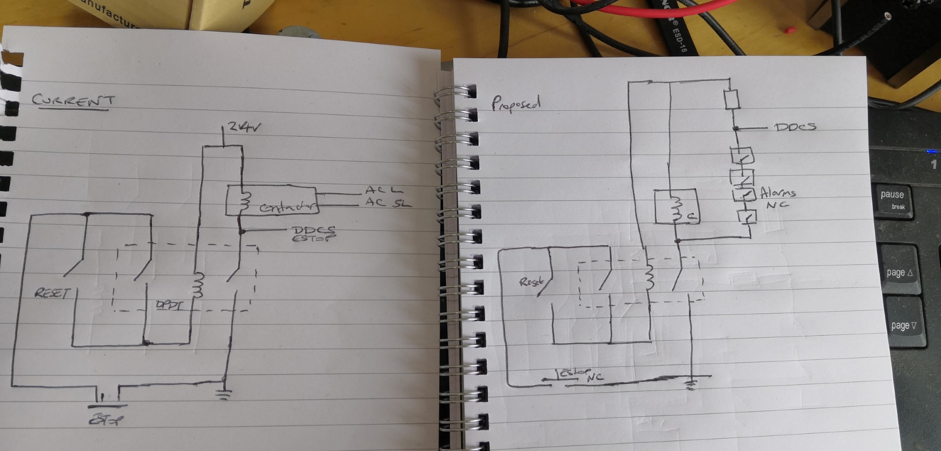

    How do people usually wire the alarm outputs of the drivers?
    My plan was to place these in series with the estop but this wont actually work for me. Reason being estop unlatches the relay that switches the main contactor that switches AC into the driver PSU, this means that the drivers are unpowered until reset is pressed latching the relay, however the relay wont latch as the drivers are unpowered therefore cannot switch on their open collector alarm outputs breaking the estop circuit.
    The only thing I can think of is to add another relay in series with estop, via the normally closed contact and then have the driver alarms open this relay, this has the downside that you don't know if the alarm circuit is intact until it doesn't work.
    I have wired fault outputs in series and taken that to a "servo fault" input on the motion controller. Partly for the reason you give - can't put power on the drivers via the safety relay until there is power on the drivers - and partly because I classify "fault" signals into two categories. Personal safety - when you hit estop you really want it to stop NOW so that is a safety relay task (mine cuts driver power, driver enable, and signals motion controller), and machine issue - driver fault, limit switch - and I'm happy that motion controller firmware can be trusted for that. Does DDSC have "driver/servo fault" input(s)?

    My solution is similar to Neale's. The UB1 board I use has a simple safety-relay circuit, so the first 10 or so inputs can be linked to close a relay. My driver's fault signals feed into this, alongside my VFD's fault signal and a signal from my e-stop circuit. The driver's enable line is linked to the relay output, so if one drive faults the drives remain powered but not enabled. Same happens if the VFD drops out, or I hit the e-Stop button (but that also has the effect of killing the power to the drivers directly).

    The DDCS has two estop inputs but one is difficult to access on the MPG port. I have an idea how to sort this now. Currently I use the output of the safety relay to switch the low side of the contactor coil and also signal low to the DDCS estop input which is configured to go into emergency stop if this signal is high. I was looking to integrate the alarms on the estop switch side of the safety relay but this is wrong, instead I can put them on the output side. Take a resistor to +24v then series the NC alarm outputs via the same safety relay contact to ground. Take the DDCS estop input from the resistor.
    With this configuration the alarms will only estop the DDCS not the contactor, but when the safety relay is tripped both DDCS and contactor will estop. Million dollar question, do I need a diode to prevent current flowing from emitter to collector through the alarm NPNs into the DDCS input when the safety relay is open? My analogue electronics is extremely rusty.

    Analogue is easy, just work out where the current will flow. Ohm's Law plus Superposition Theorem equals The Answer.
