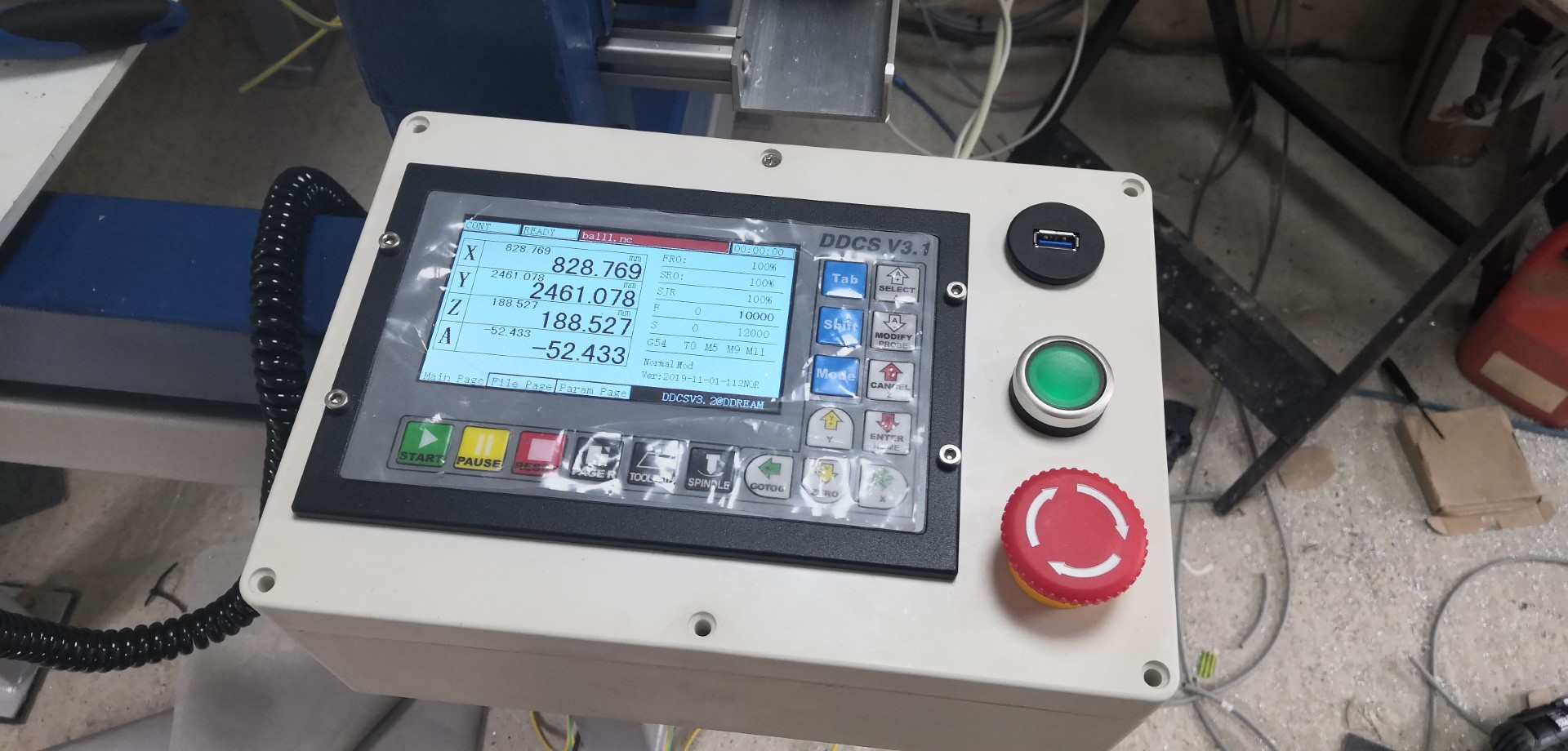

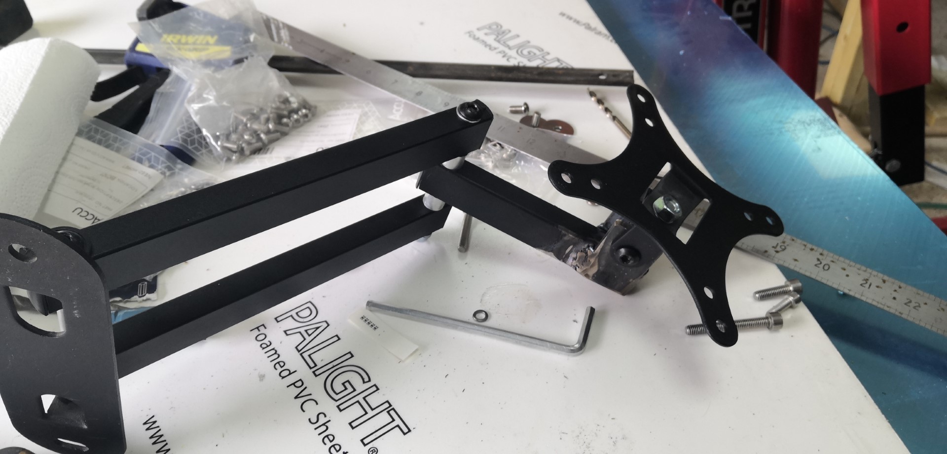

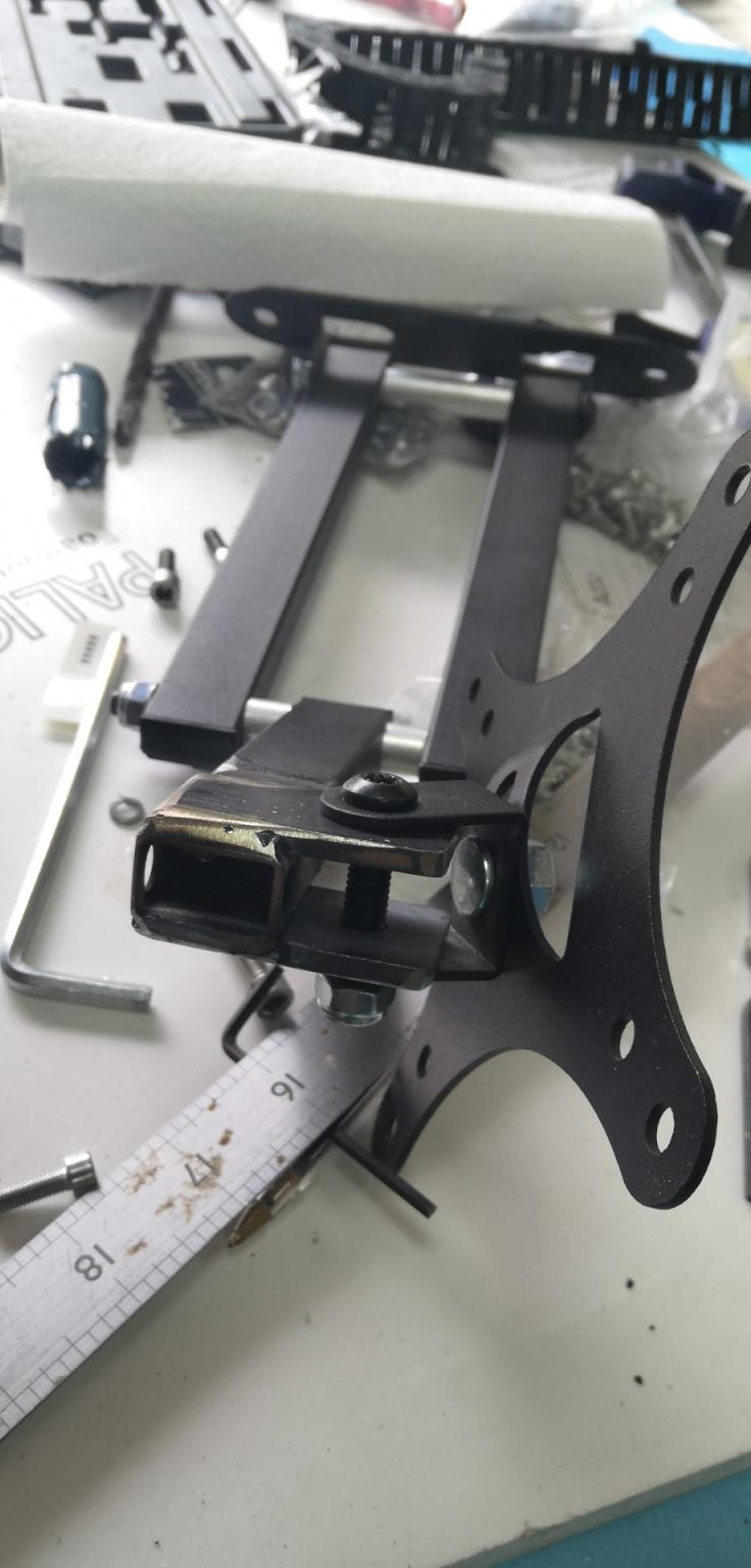

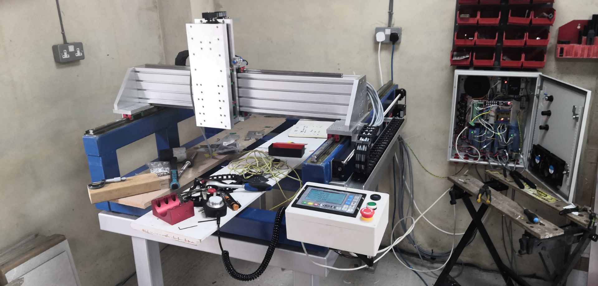

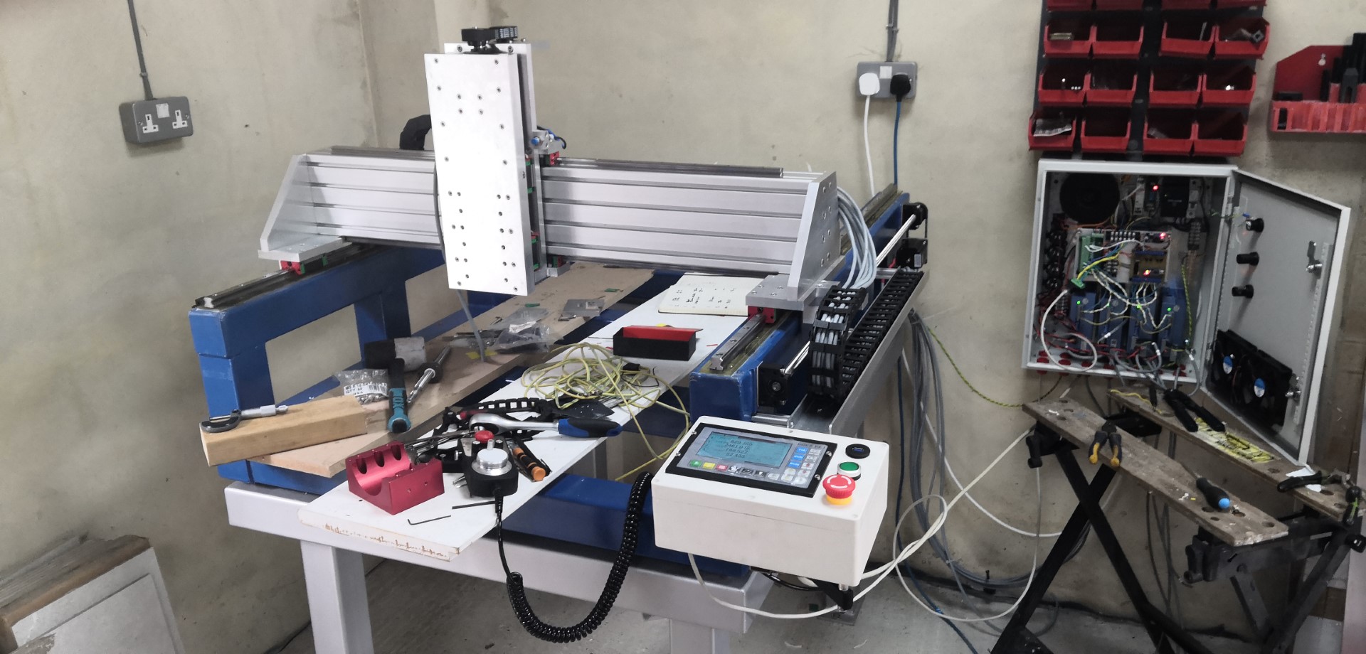

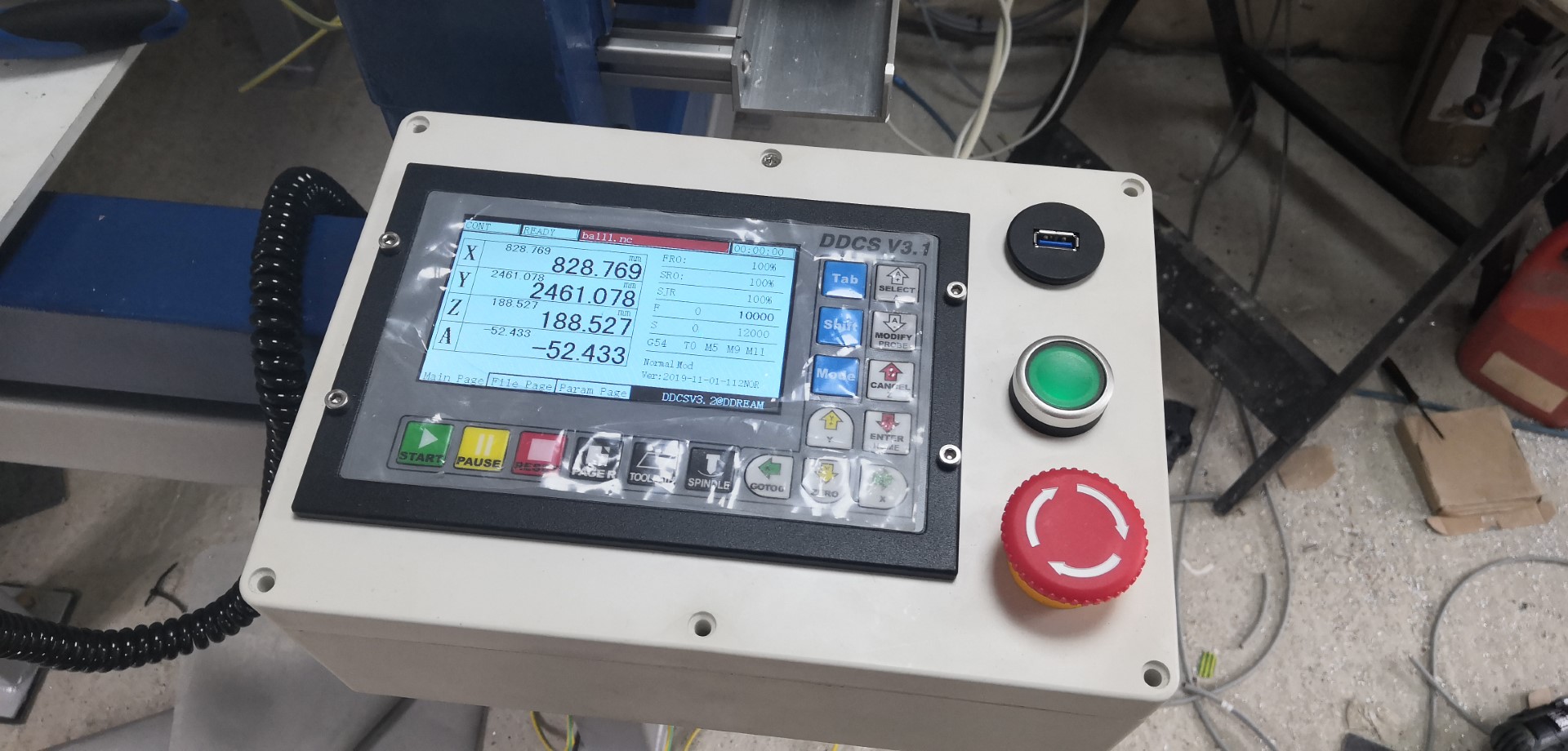

    Progress update. Today was spent putting some controls in a box and attaching it to the machine. I used an old TV mount and made some crude alterations to it with the welder.
Name:	IMG_20200620_144417 (Large).jpg

    I also soldering up the MPG connections which was a massive pain in the rear.
    First moves:
  7. #157
    Great when it reaches that point - gives you the drive to get it finished!
    Seems a little slow when jogging with the MPG - is that a "settings" thing? Mine winds back and forth a bit faster, but there's also a "step size" switch on the MPG that effectively changes jogging speed.
  8. #158
    Yep the DDCS lets you configure the step size per MPG tick for each of the three speeds on the MPG but I haven't configured it yet, so it is defaulted to 4 microns or something ridiculous. Sounds rough on the lowest setting as it is below the precision of the machine.
    Still got to rig up the home switches and solder all the cable shields on, then I can tune the config. Also need to dig out my old VFD and see it it still works, it may have been exposed to the elements.
    Then cut the plate for the bed and get the machine to drill itself....
    Before going much further I will run some complex toolpaths in the air so see if the DDCS is any good, I have no reason to believe that it isn't but want to know sooner rather than later if I need to switch to a PC, hopefully it will be fine.

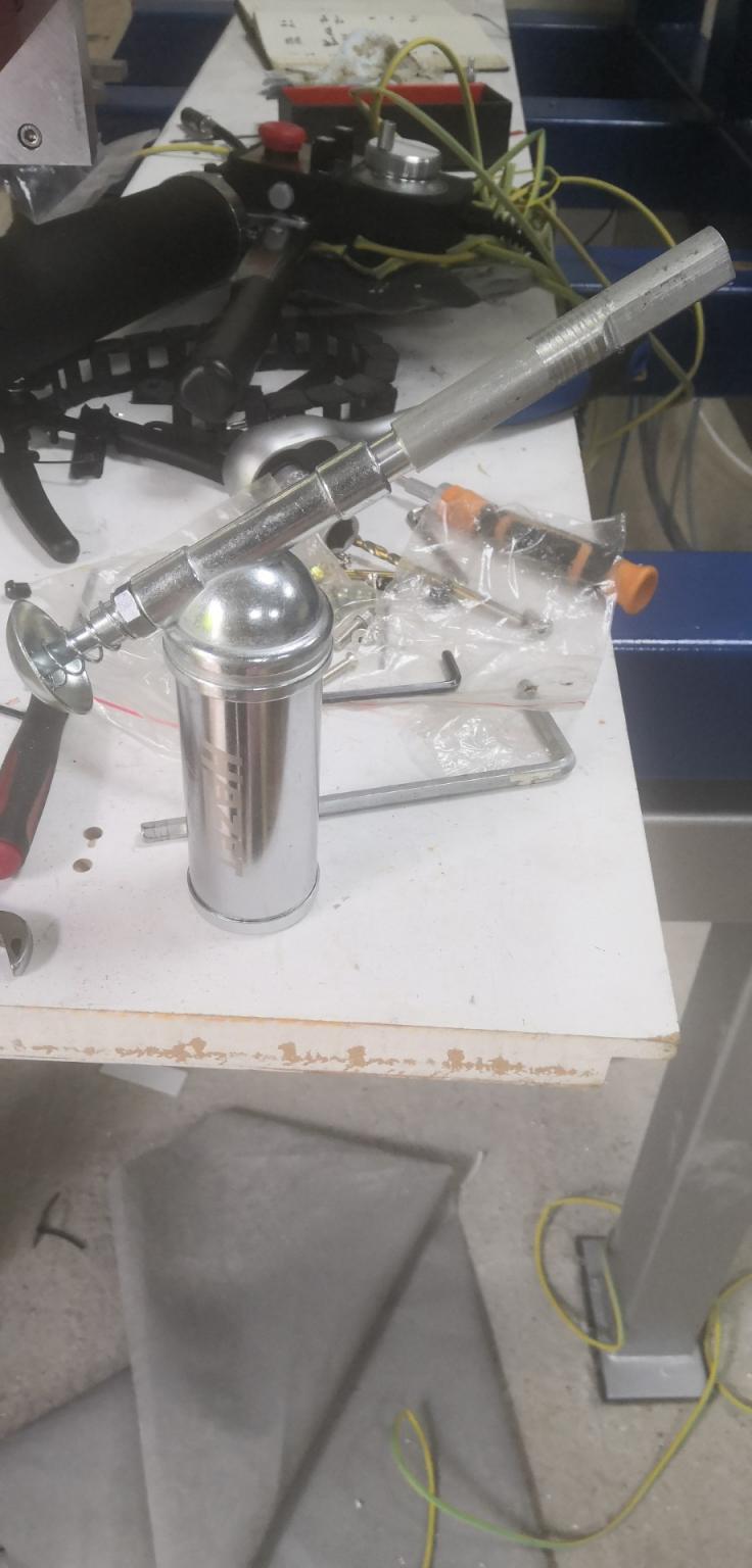

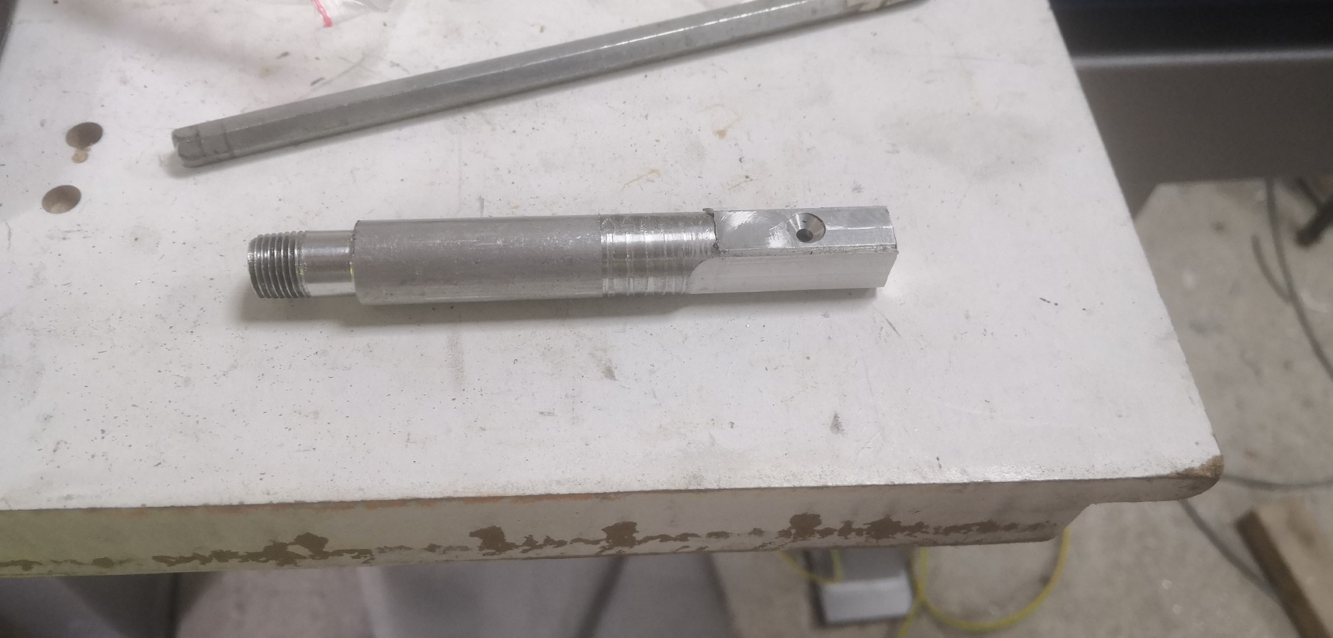

  9. #159
    I ended up fitting the tiny hiwin grease nipples to the HG15 carriages, these are a pain. Today I knocked up an adaptor from a piece of aluminium, it works but only about 50%.
Name:	IMG_20200621_114716 (Large).jpg
ID:	28429 Click image for larger version.
Name:	IMG_20200621_114855 (Large).jpg
    I've read the hiwin instructions for moving the grease point to the side of the carriage by piercing one of the blind holes in the green plastic molding, has anyone tried this? It would greatly simplify greasing my Z axis.

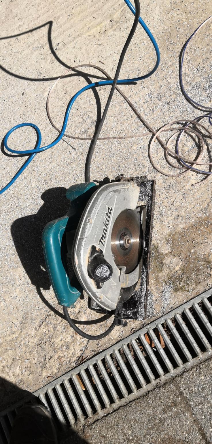

    VFD is working, quite surprised by this as it has been 'outside' for a couple of years. DDCS is controlling the spindle on/off and speed.

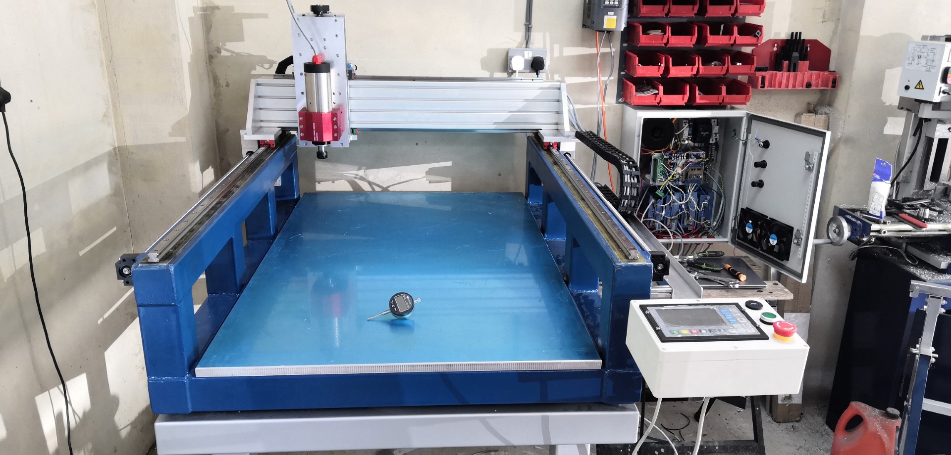

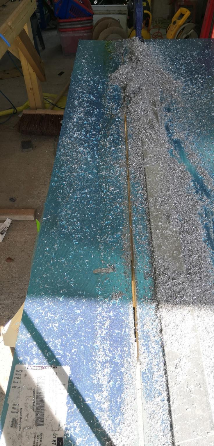

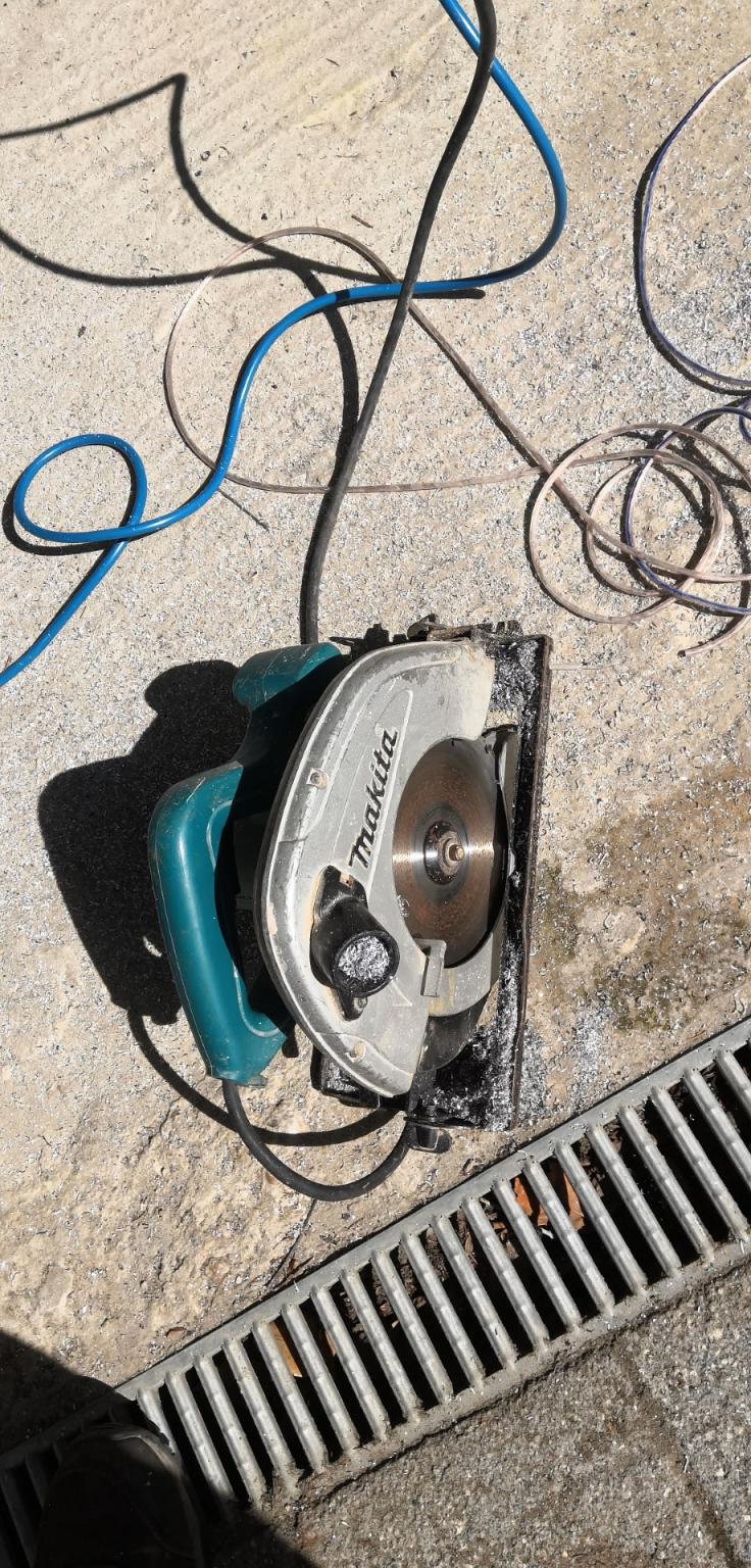

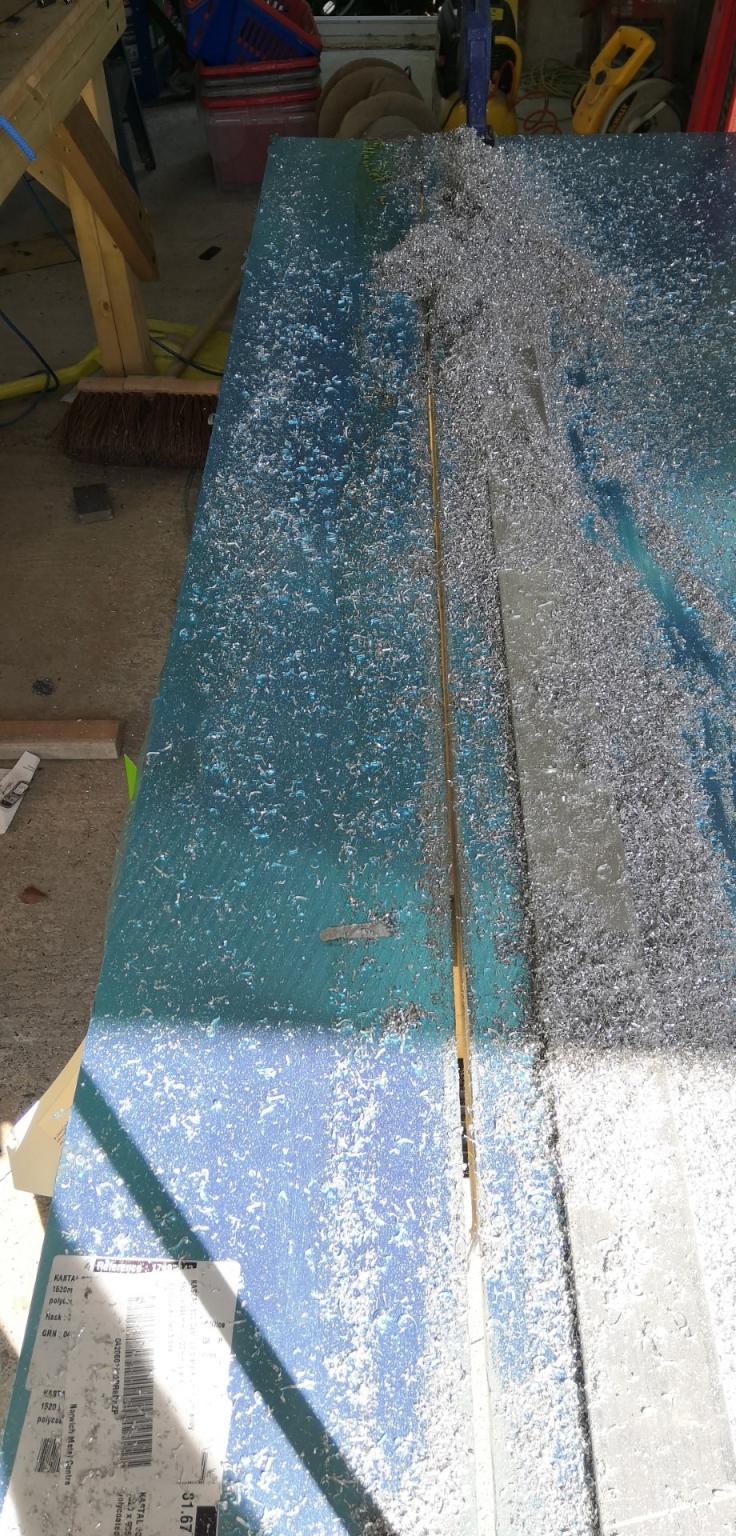

    Today I cut the 20mm plate for the bed. The blank weighed 80kg which is too much to safely manoeuvre around the table saw so I just my very old and rough circular saw, lots of fluid, lots of smoke, but it did a pretty good job.
Name:	IMG_20200623_095330 (Large).jpg
ID:	28447 Click image for larger version.
Name:	IMG_20200623_095327 (Large).jpg

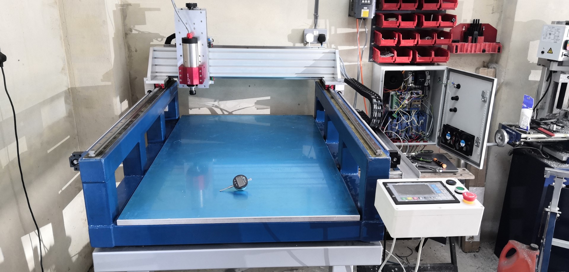

    I took the edge off with a chamfer bit in a wood router, the bed sitting in place:
Name:	IMG_20200623_143329 (Large).jpg
    I took the a rough height map with a DTI clamped to the Z. As expected from bringing the rails into plane with laser and epoxy I have around 1-1.5mm total error (this was the frame error before pouring epoxy). The cross members of the frame are also not perfectly in plane and would require a little shimming under the bed.
    I'd rather have the bed closer to planar that this, although the eventual spoil board skimming will fix it, so I'm contemplating attaching some shimming material to the cross members and surfacing this then bolting the bed plate down on top.
    Another thought is to float the bed plate on some rubber washers and compress them until the DTI reads zero everywhere.
