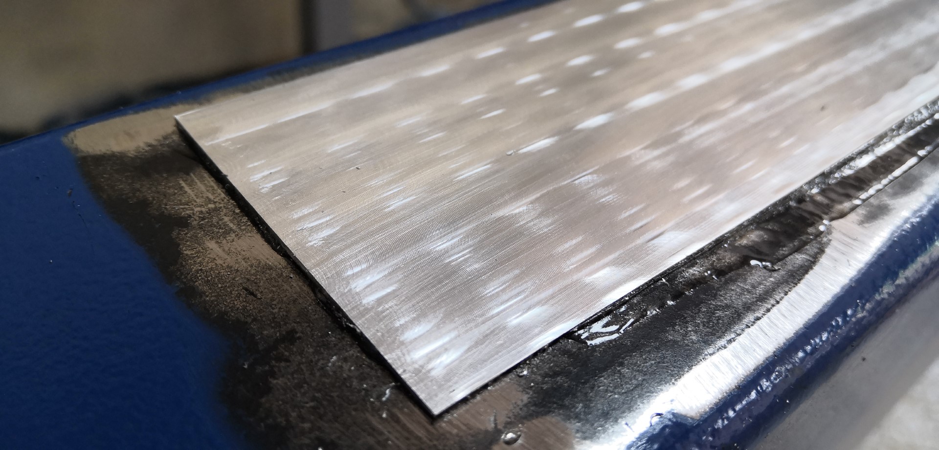

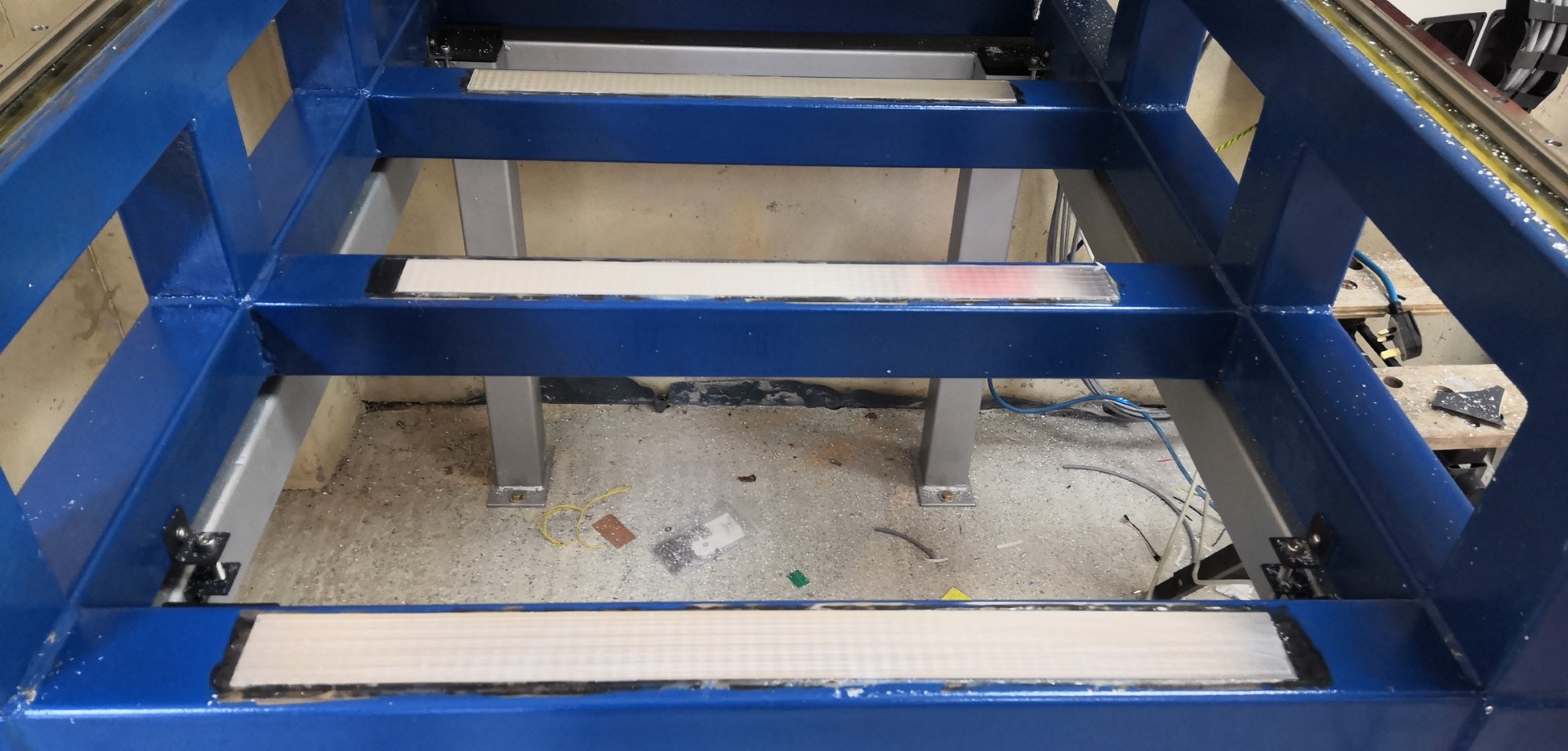

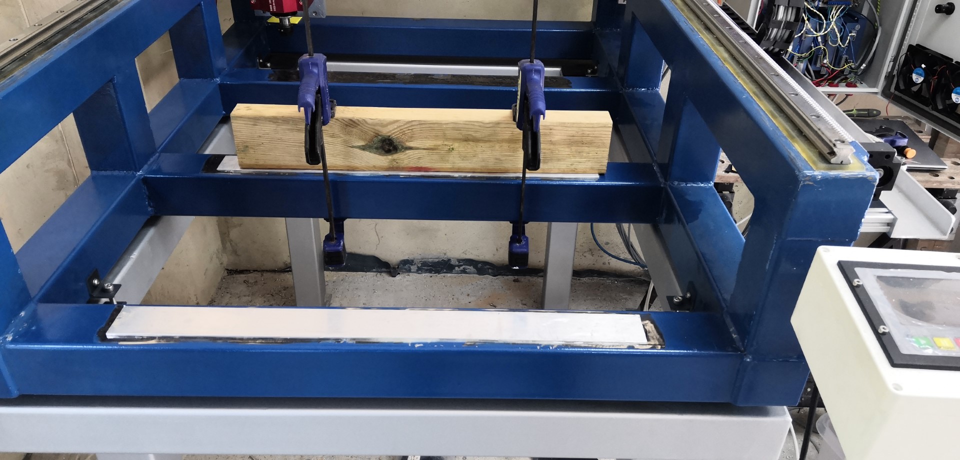

    Thanks for the ideas guys. I went ahead and epoxied some 2" x 1/8th aluminium strip to the 3 cross members that are machinable from the gantry. There is around 60mm outside each of these which will be shimmed manually. The rear cross member cannot be machined as it is under/behind the gantry as Jazz says, so this will get manually shimmed as well. Quite easy to do with a DTI n the Z as 90% of the bed plate is supported by the milled strips,

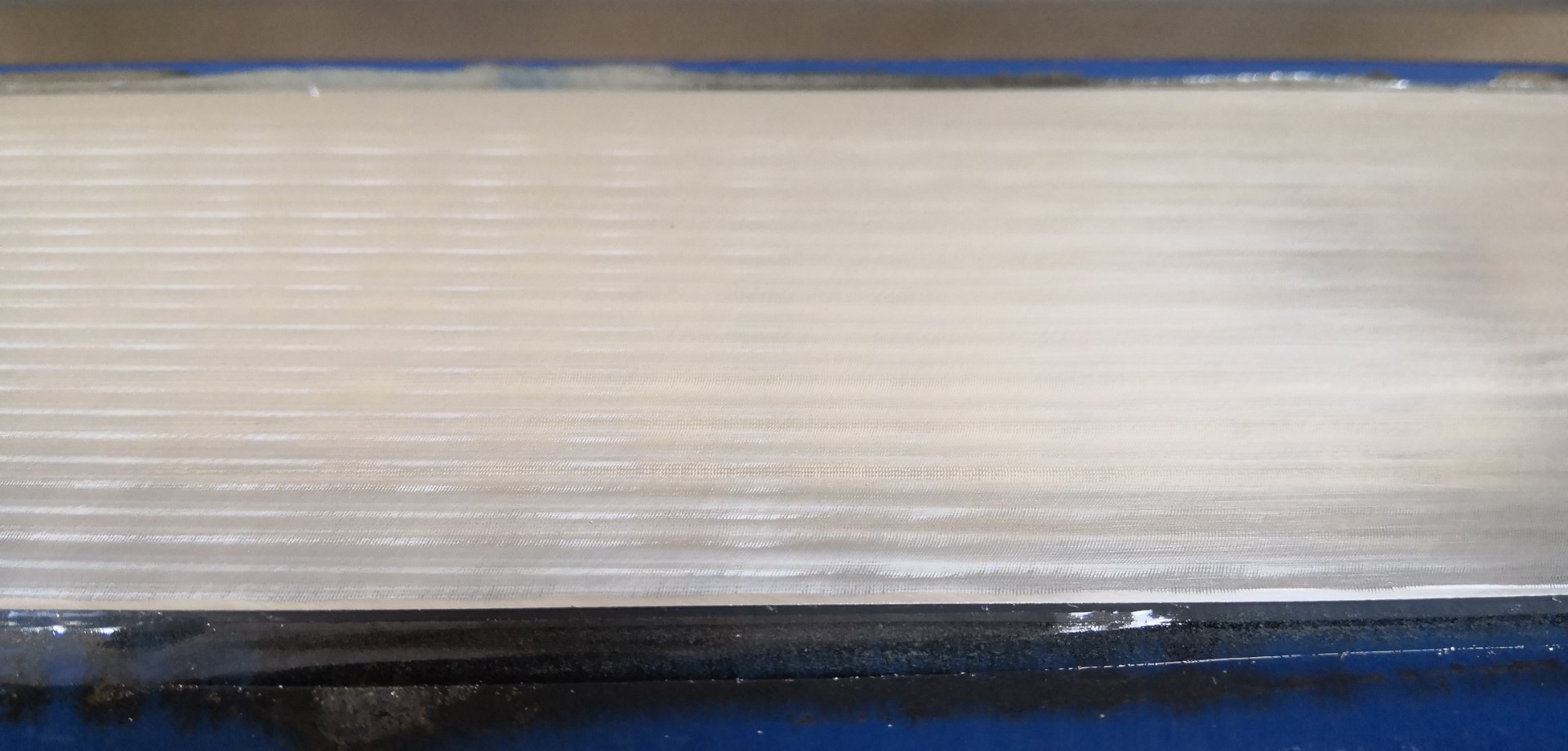

    So the exciting bit was getting the machine to machine itself, first time it has cut anything:
    Finish was superb for chewing gum grade aluminium, thickness of thinnest final shim is ~1mm.

    I used an 8mm 2 flute carbide bit, there is no scalloping which means the head is in pretty good tram (I can't tram it until the bed is on). I ran the tool path twice, initially to bring all 3 strips down to height then dropped the Z 0.1mm for a finish pass.

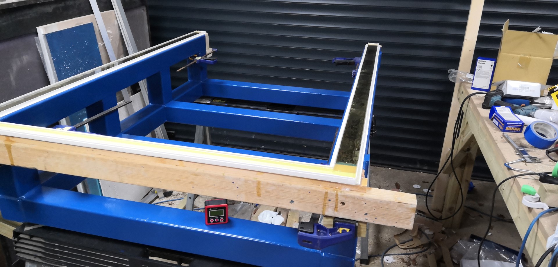

    Hi Clive, yes there was a moat, I put it outside of the frame at one end. The rails are planar within 10um, I checked them with my laser software. Or at least they were when I fitted them, they have probably drifted a bit as I've hoisted the machine around the shop a couple of times since then. I will recheck them at some point.
    I didn't post anything about how I did the pour but there are two important points I'd like to pass on to get the best result,
    1. As per Boyan's findings the moat should be outside the frame, close to the same cross section as the rail support epoxy and the pour should extend beyond both ends.
    2. You must use non-absorbent material for the moat and dams, anything else and non-linear capillary action into the material will mess things up. I used 10mm pvc angle for the dams and pvc trunking for the moat. The dams were stuck to the frame with thin toffee tape which worked well (didn't leak) but was a pain to get off.
