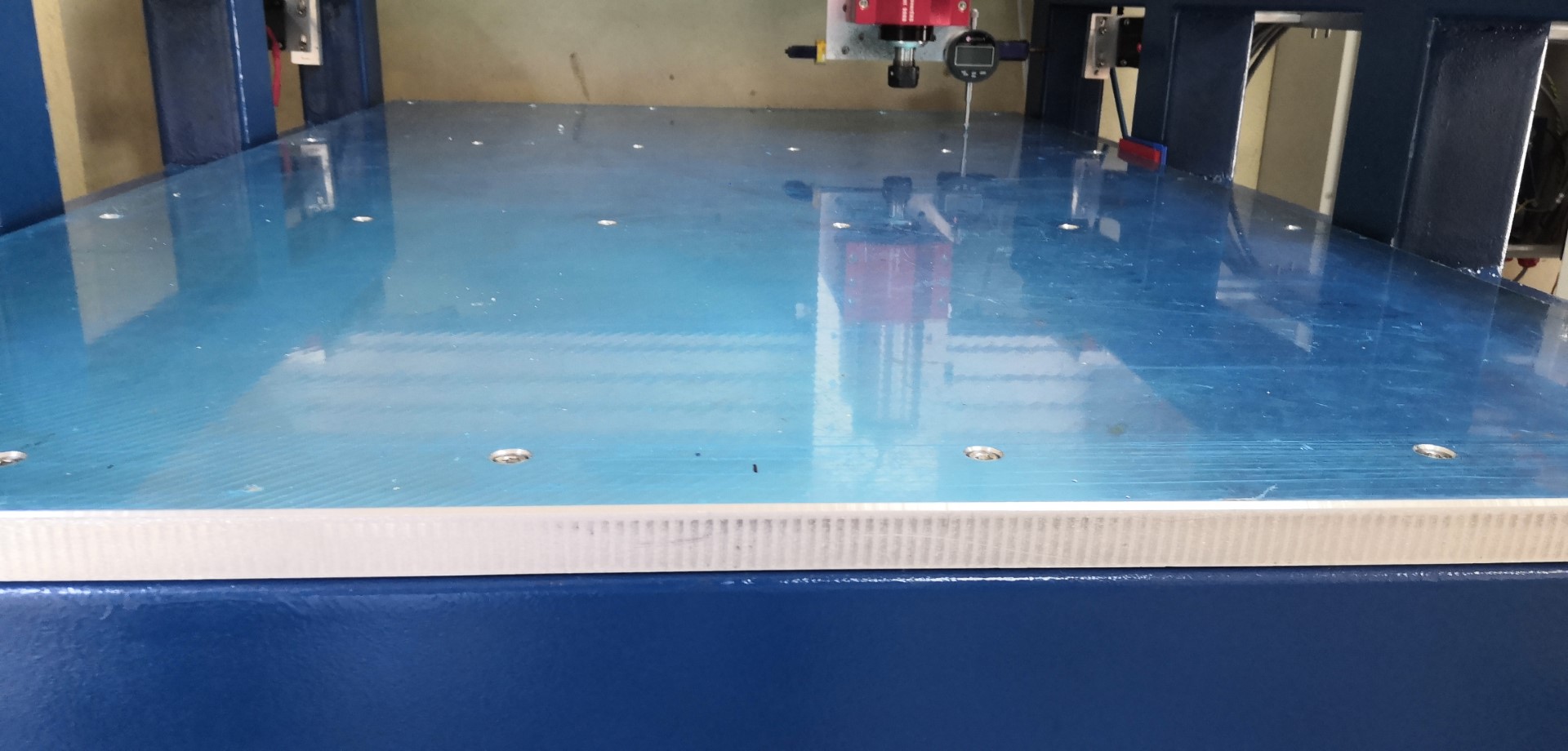

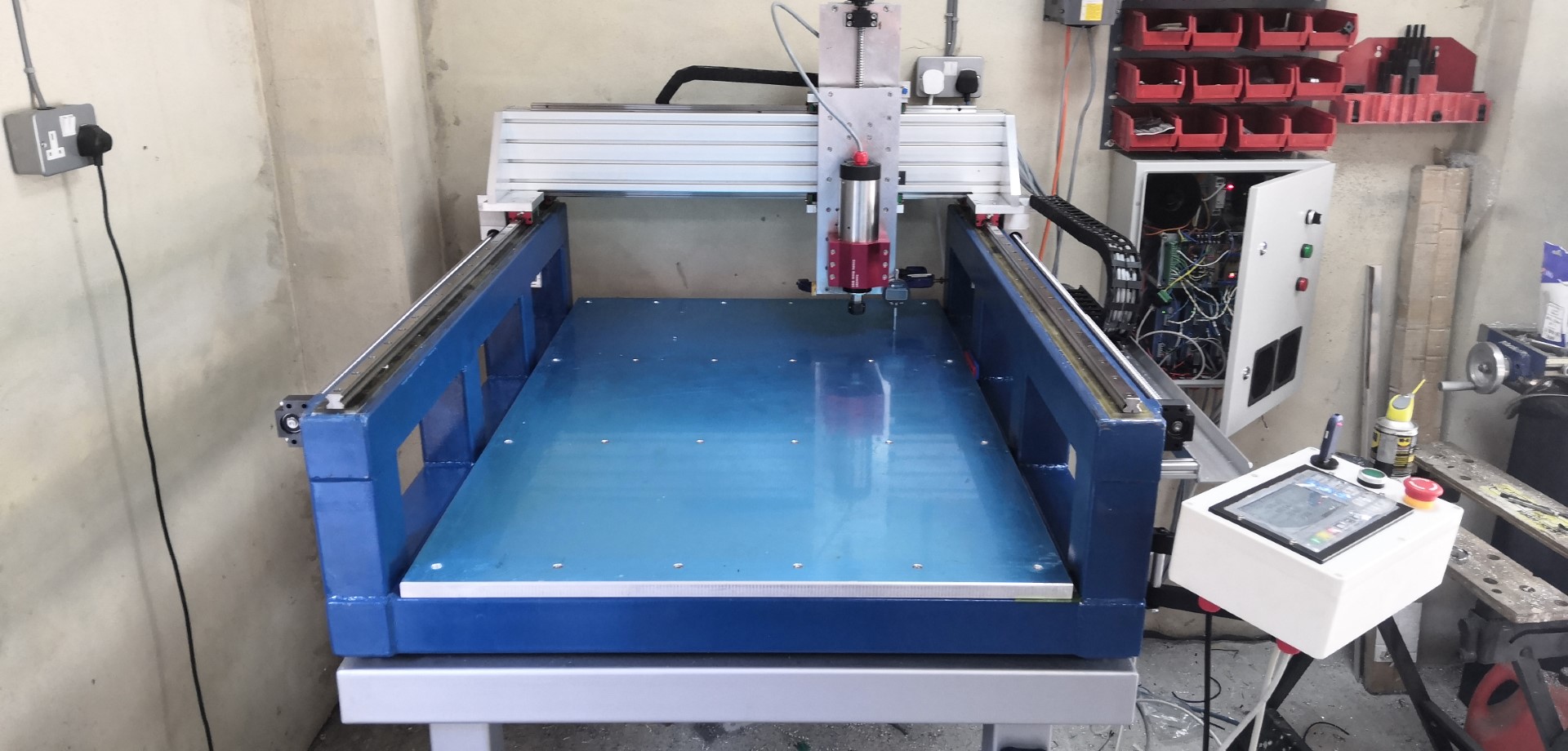

    I was going to drill the fixture holes before finally fitting the bed, but I agree it is better to do it afterwards once the machine is properly aligned. I haven't squared the gantry yet, nor properly defined zero. Will get the bed fixed to the frame in its final location, clamp on a sheet of MDF on top to square the gantry, define zero then finally drill the fixture holes.
    I'm also toying with the idea of redefining my long axis as Y and the gantry axis as X so it lines up with the natural way of looking at it from the front and the axis orientations match the DDCS buttons, otherwise I'm going to make a mistake. I would define zero as front left.
    I have drilled and tapped the bed and frame, and bolted to the locations where I had fixed and milled the aluminium strip. Reads within +/- 0.01mm everywhere in this region and there is a 0.02mm droop towards the as yet unsupported rear end. I think rather than try and shim the unsupported bits with shim material I'm just going to squirt some structural 2 component polyester resin in there, it is close enough and I will just make it worse trying to shim normally.
    In the picture you still have the protective coating on the plate so you can't trust those measurements if you did it with that still on.?
    The covering is tight and uniform so I think I can trust them enough, I DTI'd the milled shims first which was zero everywhere, happy that my +/- 0.01mm on the top is a mixture of error from the covering and the plate itself. Anyway doesn't need to be perfect as the spoil board will take up any error, if I need a very flat part for bolting a vice to I will skim the aluminium bed, I left the bolt heads low enough to do this.
