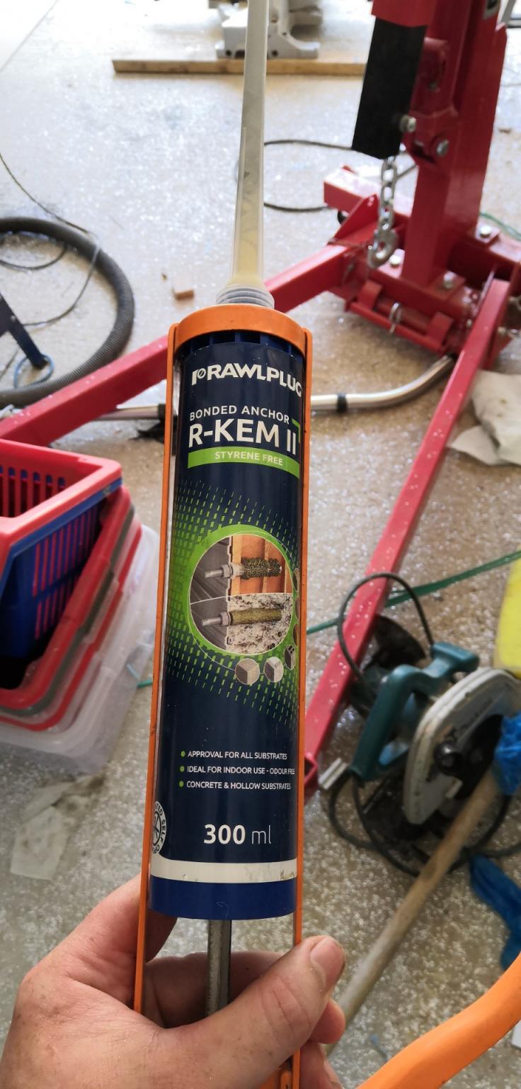

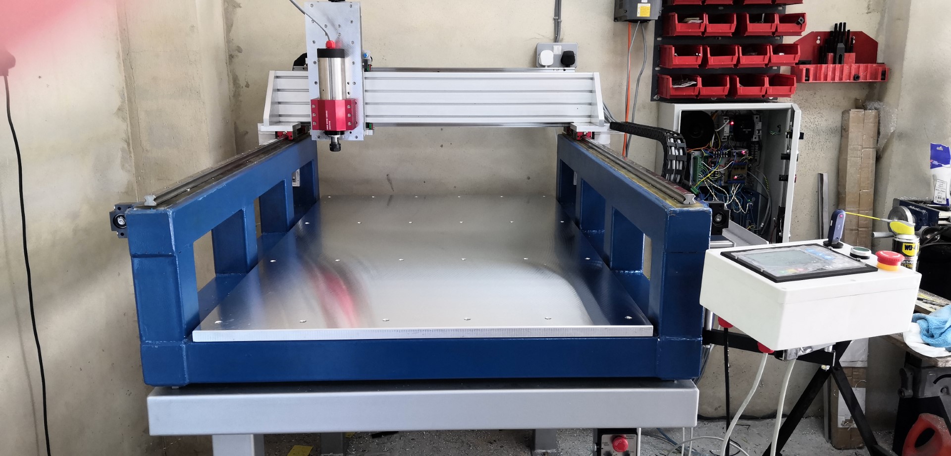

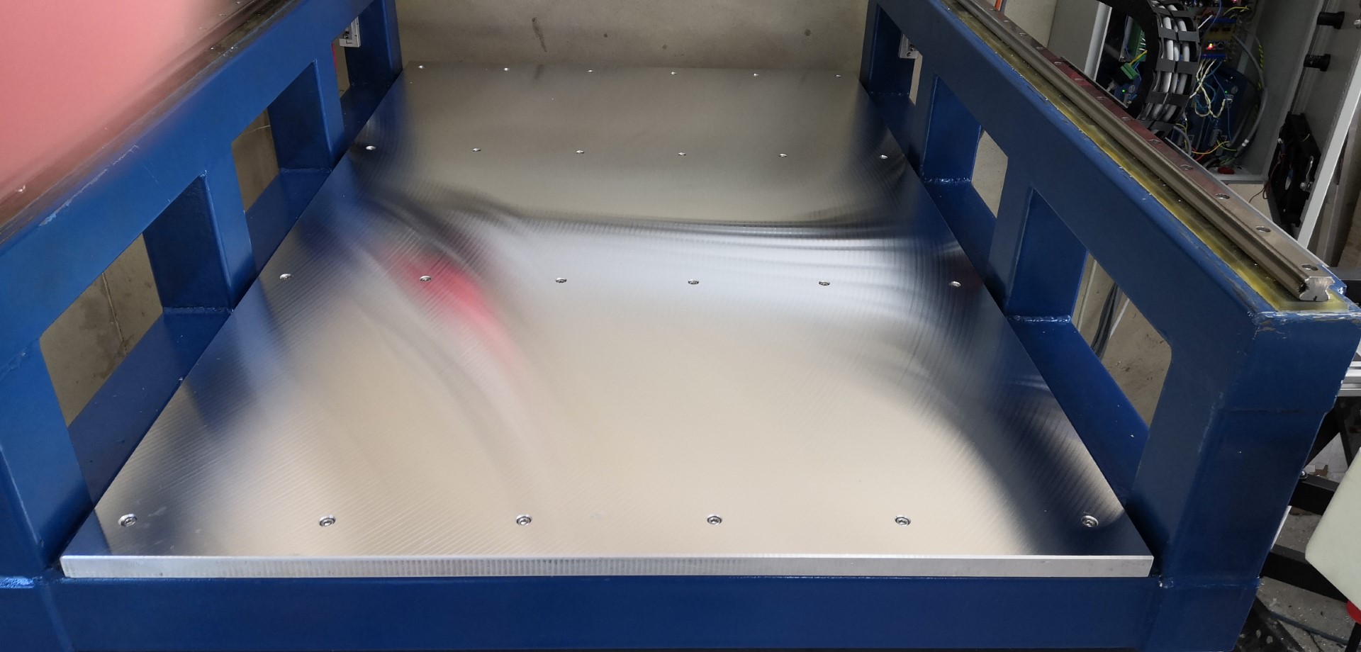

    Bed is now fully fixed. I reckon it is within 0.02mm total error, not that I really trust this digital DTI.
    The rear cross member and the outer edges of the other cross members that did not have the milled shim were done as follows. I laid some narrow strips of closed cell self-adhesive glazing rubber either side of each bolt hole. Then I re-placed the bed and tightened the central set of bolts down hard onto their milled shims. I then indicated the entire bed adjusting the outer bolts to zero, the glazing rubber provided a bit of resistance to bias the bed plate high so the bolts had something to tension against. Finally I got under the machine and injected some construction resin into the gap, this set hard in a few minutes as it is so hot today, it is basically bondo in a cartridge.
    The bed plate had a very thin film of WD40 on it to act as a release so hopefully it will be possible to get it off again should I ever need to., not sure the resin sticks well to the shiny aluminium plate anyway.

    This is the very last time that bed will look so nice!

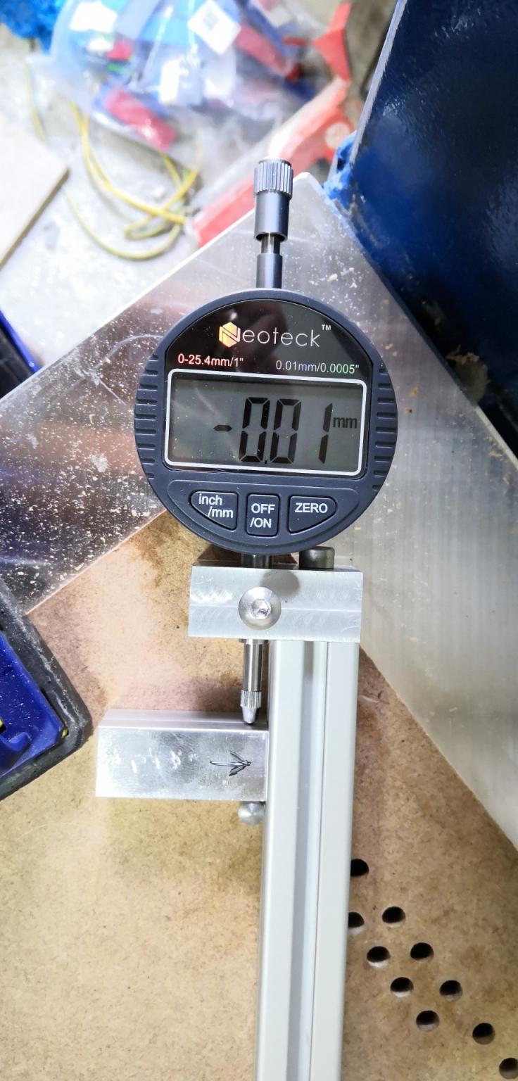

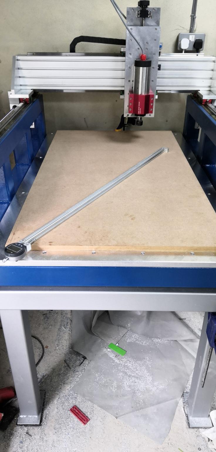

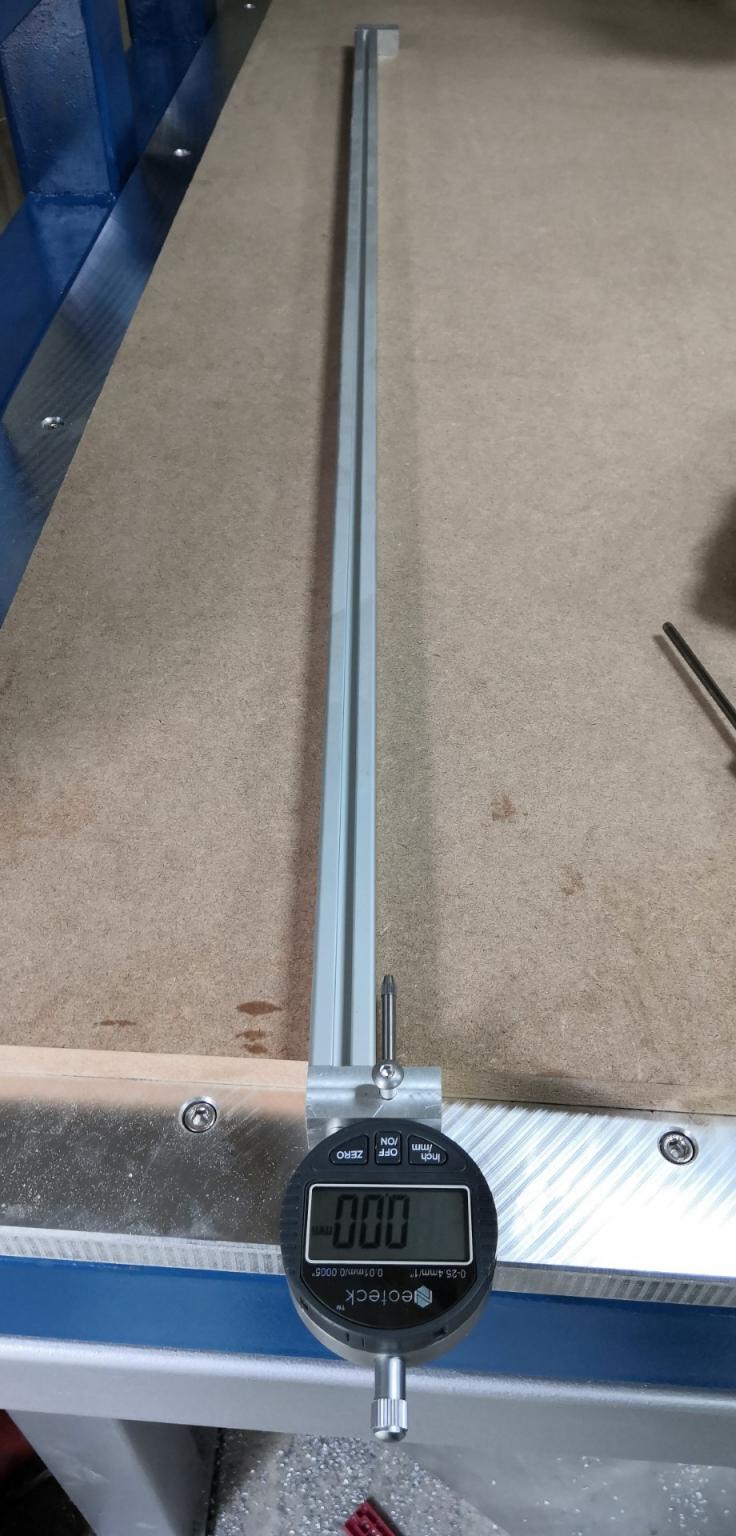

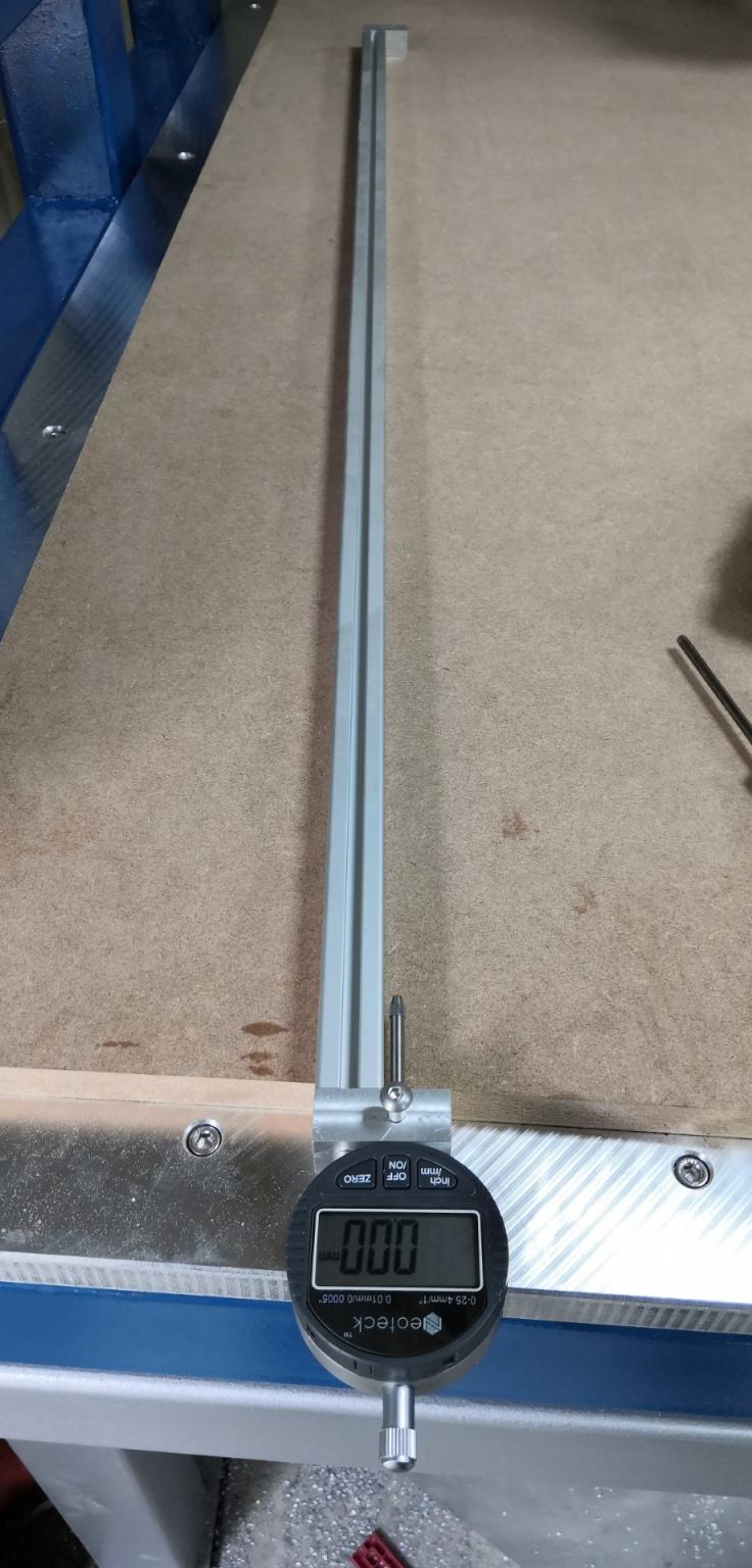

    I squared the gantry today. I used the method of equalising diagonals. First I had to make a measuring stick:
Name:	IMG_20200628_114528 (Large).jpg
ID:	28479 Click image for larger version.
Name:	IMG_20200628_114714 (Large).jpg
    Then I had the machine drill 4 holes in a rectangle and inserted dowel pins, zero'd the DTI on one diagonal then measure the error on the other. The arduino board I made for axis squaring only had 8 bits of step offset. This machine uses 1610 screws and 16x microstepping so 8 bits represents 255*10/(200*16) = 0.8mm of software correction to the limit switch. Therefore I had to get it close first by moving the proximity sensor targets first, I got the diagonal error down to 0.32mm.
    Fine tuning squareness was then done by changing the offset in the arduino code. After lots of messing around trying to calculate the gantry error angle then the actual number of steps to offset one switch I gave up. I just drilled holes with offset at zero, then with offset at 255, then interpolated the two errors to get the 'correct' offset (note this is not the correct way to do this but it works well enough over these very short distances). Plugged this into the software and low and behold:
Name:	IMG_20200628_161145 (Large).jpg
    0.01mm error over ~1000mm diagonals. Square enough for now, it is repeatable. Can't do better than that without a much better DTI and some measurement of backlash.
    Annoying sources of error whilst doing this were 1) a dowel pin that got scratched up pulling it out with pliers, 2) not having the DDCS home twice, this made it a little more consistent, don't know why.
    I also noticed that the EM806 stall detection is not working for a stalled start, it works fine if you stall a spinning motor. Is this something I can tune or is it just a limitation of sensorless stall detection?
