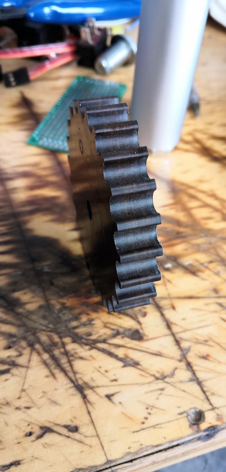

    I needed an HTD5 pulley for a project, this was a bit odd as it needed to be fixed to a spinning bearing housing rather than to a shaft so I decided to make one on the machine. I used the cambam trochoidal plugin for the roughing allowing the entire part to be milled with a 3mm endmill, took a bit longer but meant no tool change. Part was cut dry with air to clear chips, worked out really well.

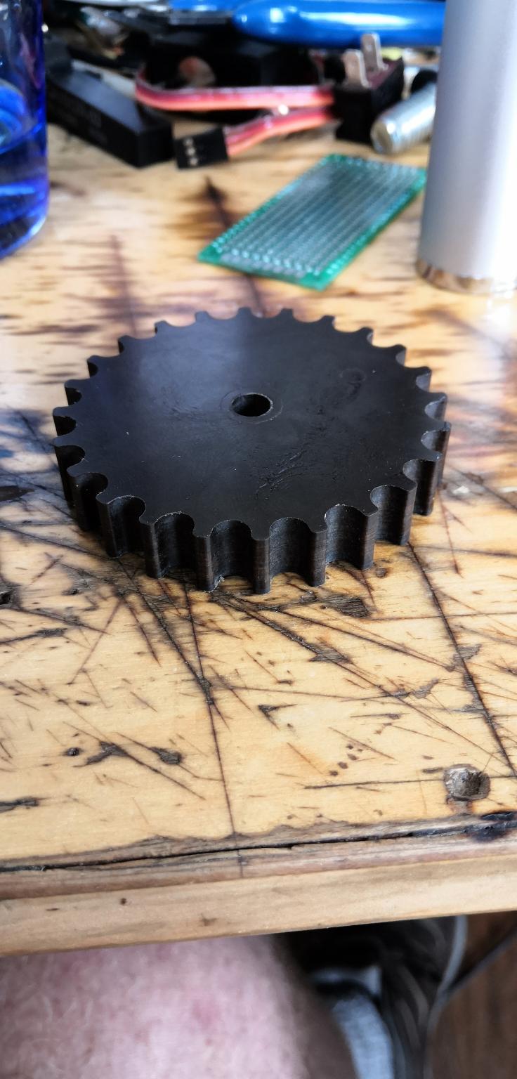

    Yesterday I used the CamBam trochoidal pocket plugin to cut out the teeth for a ratchet made from Jarrah hardwood. Conventional shallow cuts tend to take the corners off the teeth where the grain is tangential to the wheel so being able to do a 12mm depth of cut with a 2mm diameter tool is a bonus. I still had to redraw the original ratchet design (produced in Gearotic which will also draw HTD and many other pulleys for you) with rounded teeth to avoid some chipping. This cut used a two-flute straight cutter with a speed of 1000mm/min and a stepover of 0.15 (0.3mm) and the maximum 24000 rpm. This took about 25 minutes for the 110mm diameter wheel.

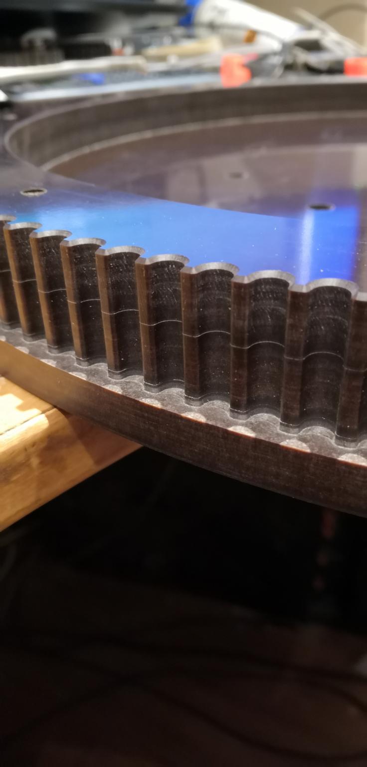

    Now I have a question for you pulley experts. I need to make a very large 157 tooth 8m timing pulley ring that will be fitted to the perimeter of a winch drum. The pulley needs to be made of a ring of material ~25mm thick with an outer diameter of 400mm and inner of 340mm. It could be made from aluminium, SRBP, delrin or even hdpe.

    I use a free command line dxf generator that can generate all of the main timing pulley profiles, super simple.
    I just cut an 8m test pulley in 10mm SRBP P1, if came out very nice and extremely strong teeth. I think I will use this material and laminate a few layers together then bolt through, it is pretty cheap stuff and locally available to me.

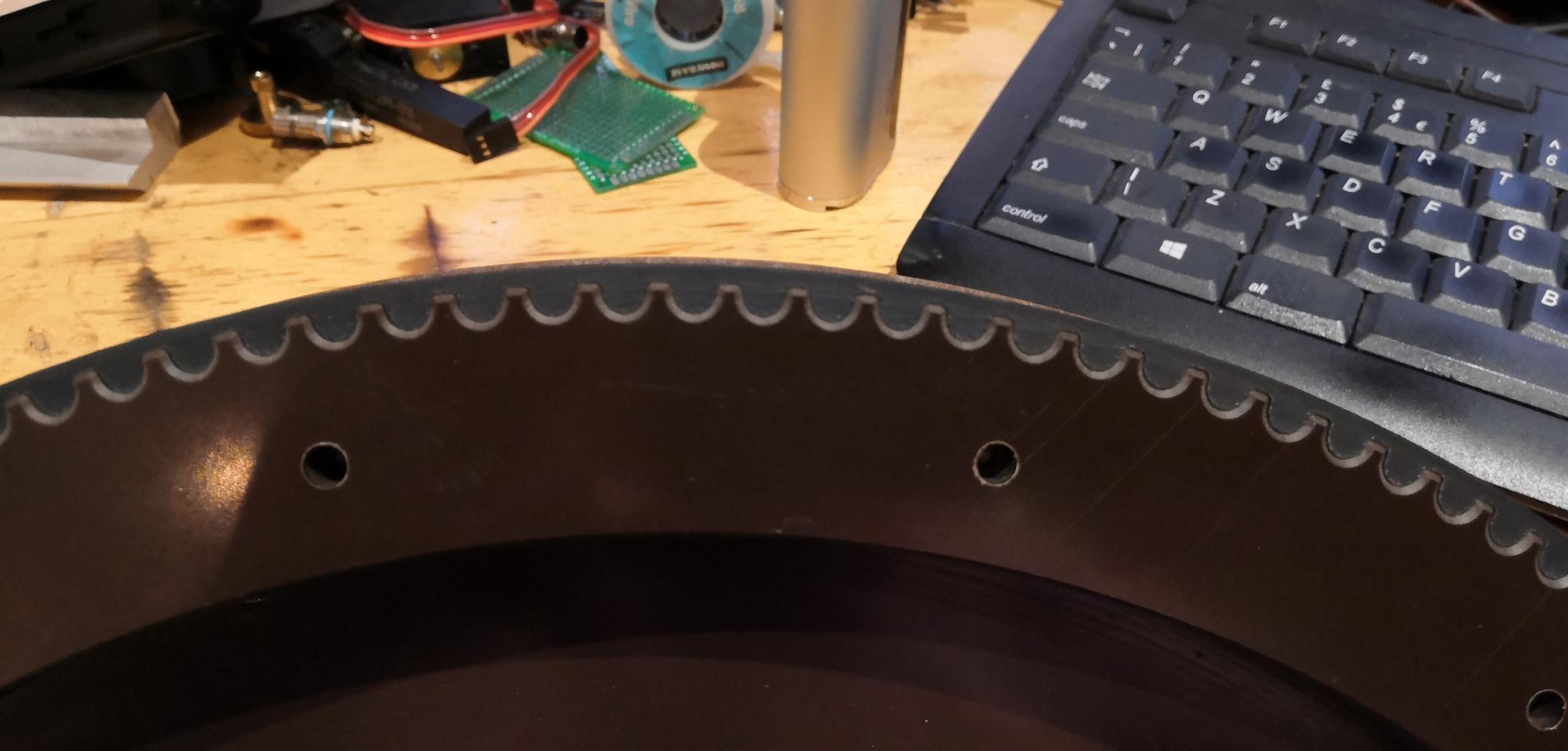

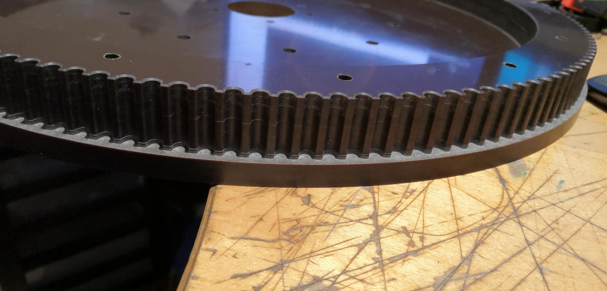

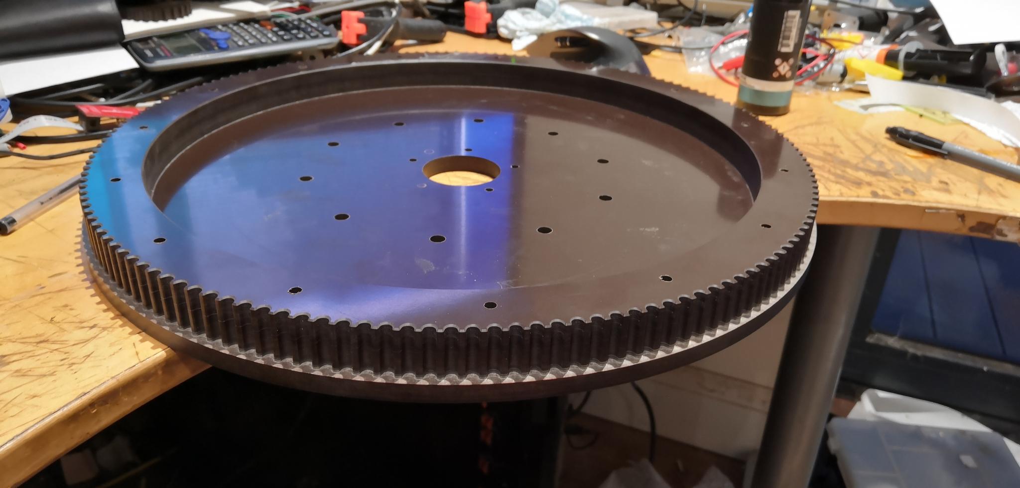

    I made the large timing pulley I was proposing today, it is a 157 tooth HTD 8M (20mm belt) for a project, pulley is ~400mm diameter. It was made from 10mm SBRP with 3 laminations at the rim. Turned out fantastic. I used screwfix cyano to laminate, this makes a very strong joint which you cannot get apart. It will never the less be reinforced with a ring of M5 bolts.

    What a monster? what's it for may I ask?
  11. #210
    It is for winching humans into the air attached to paragliders, this pulley forms one side of the winch drum and is driven at around 10kW by a 25kW BLDC motor under FOC control.
