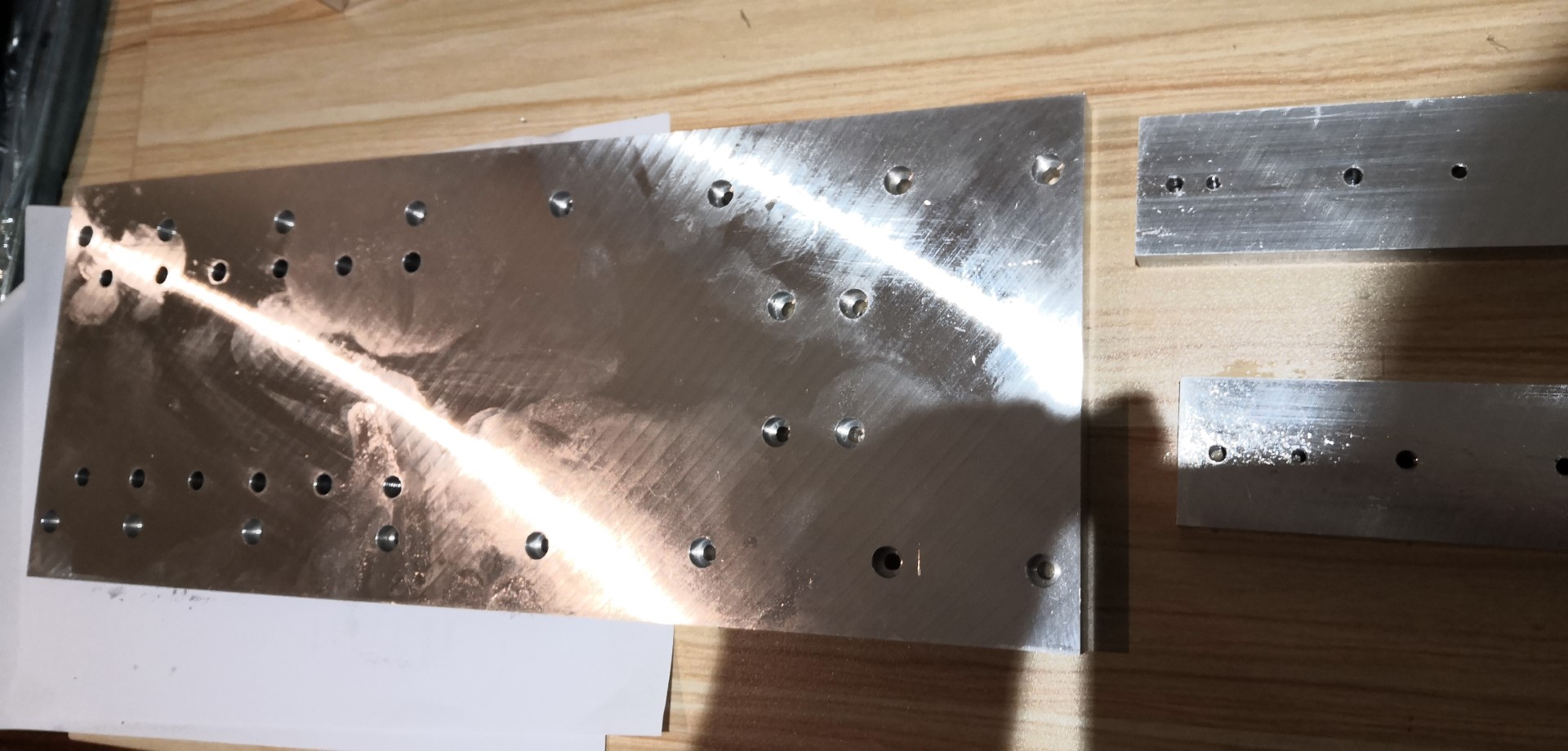

    I've started milling parts for the Z.
    Front plate and rail spacers finished, all fits well. These large plates take an age to mill out on my manual mill.

    At least drilling the holes accurately is simple with the DRO.
