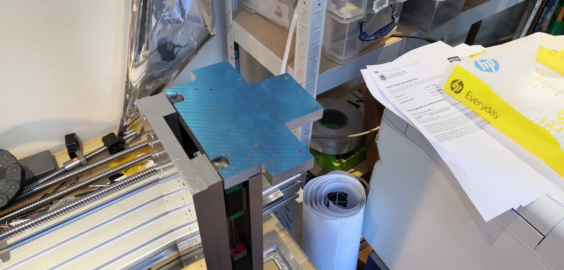

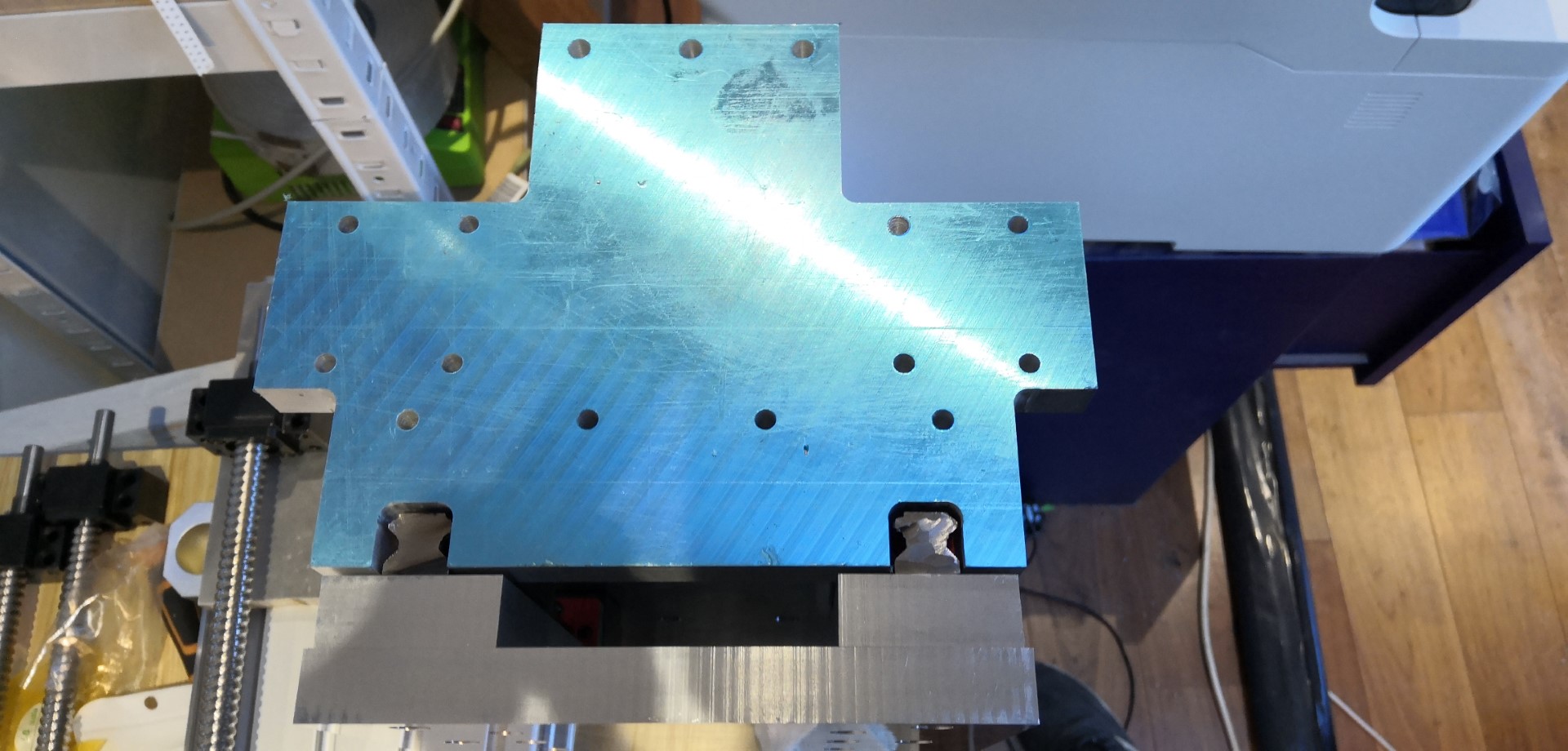

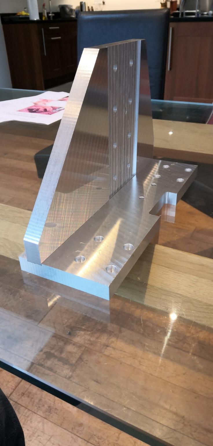

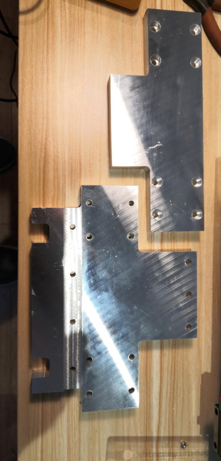

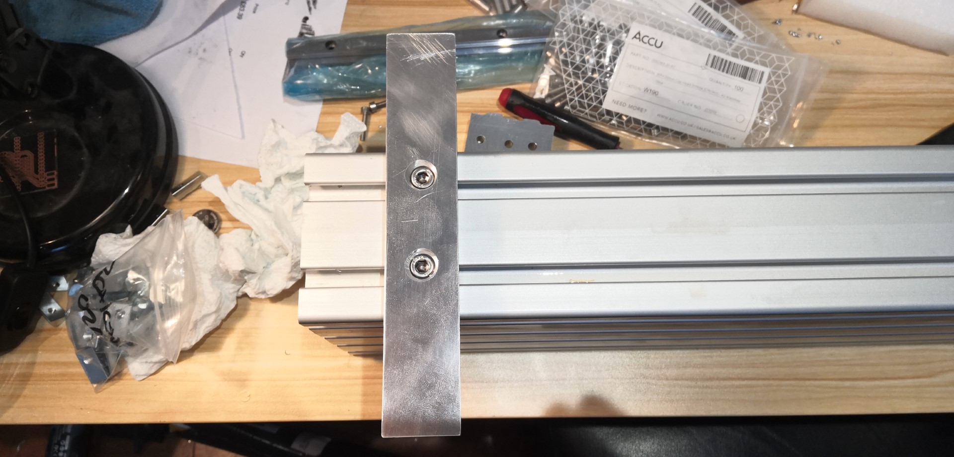

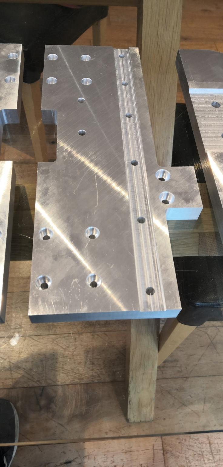

    Milled the Y bearing plates, just need to counter bore them. Lower plate wraps around the rails on the Z front plate to reduce coolant splash up inside the Z assembly, it is also recessed to accept the rear Z plate press fit so that it is easy to line it up with the upper Y plate. The row of 4 holes that will be used to bolt the lower Y to the rear Z plate are undersized as I want to use them as a drill guide for the tapped holes in the rear Z. The Z is too tall to stand on my mill so these will have to be drilled on the pillar drill or with the cordless.

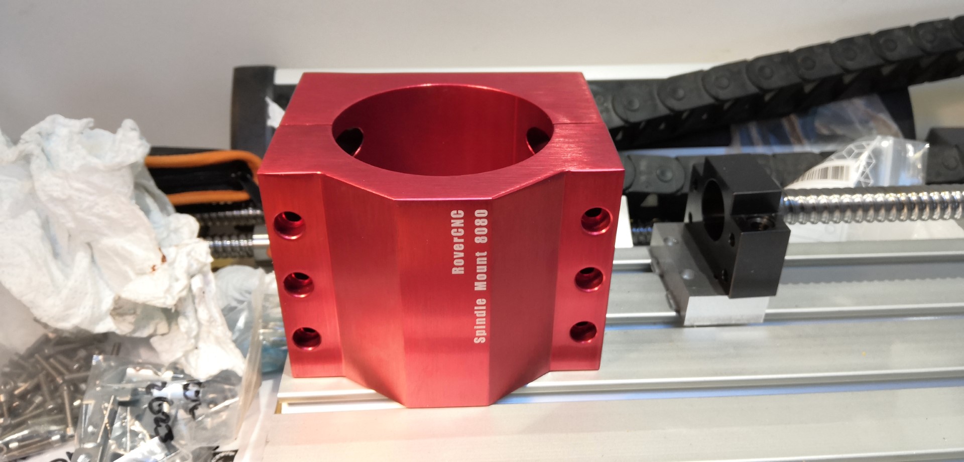

    Also the spindle mount arrived from Canada, very nice bit of kit.

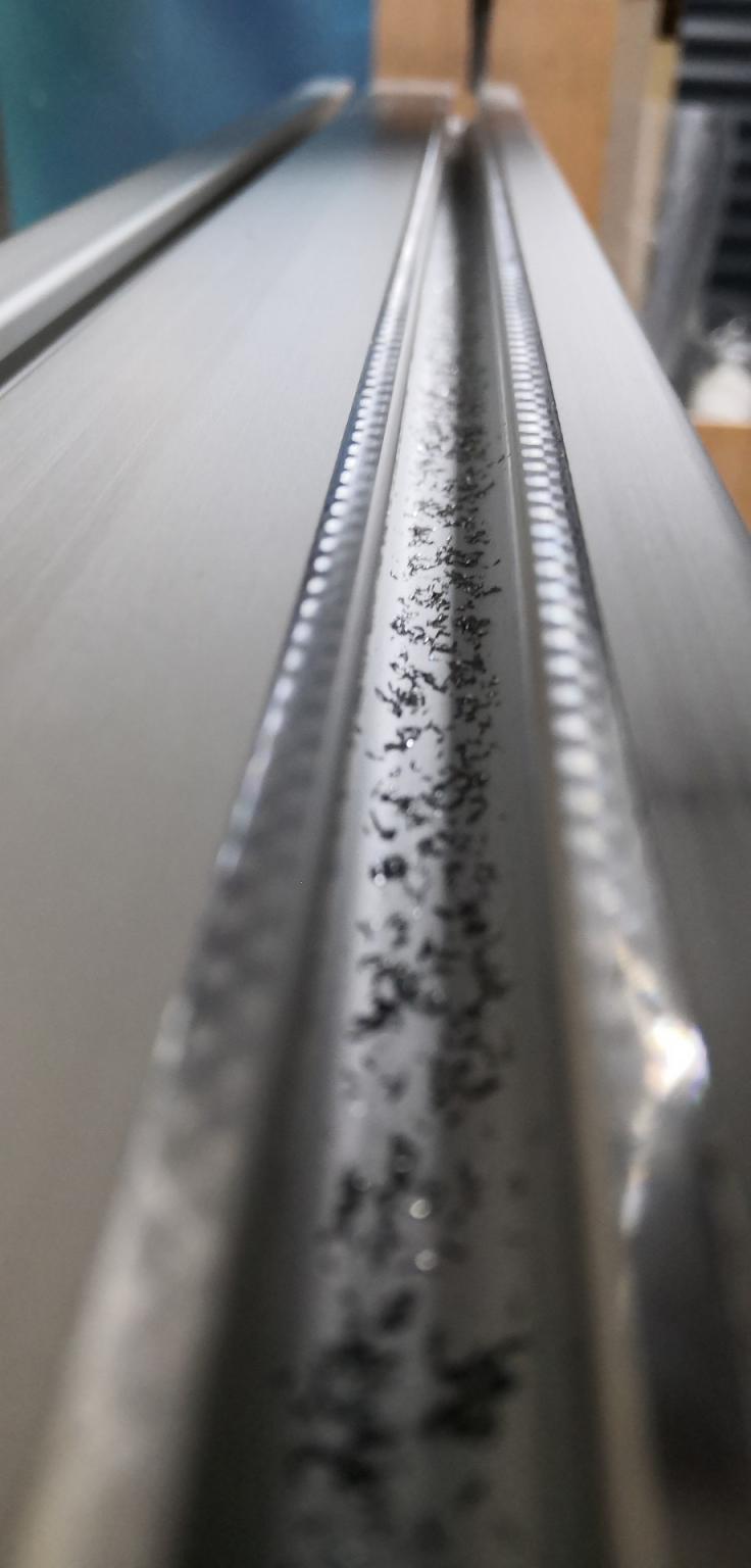

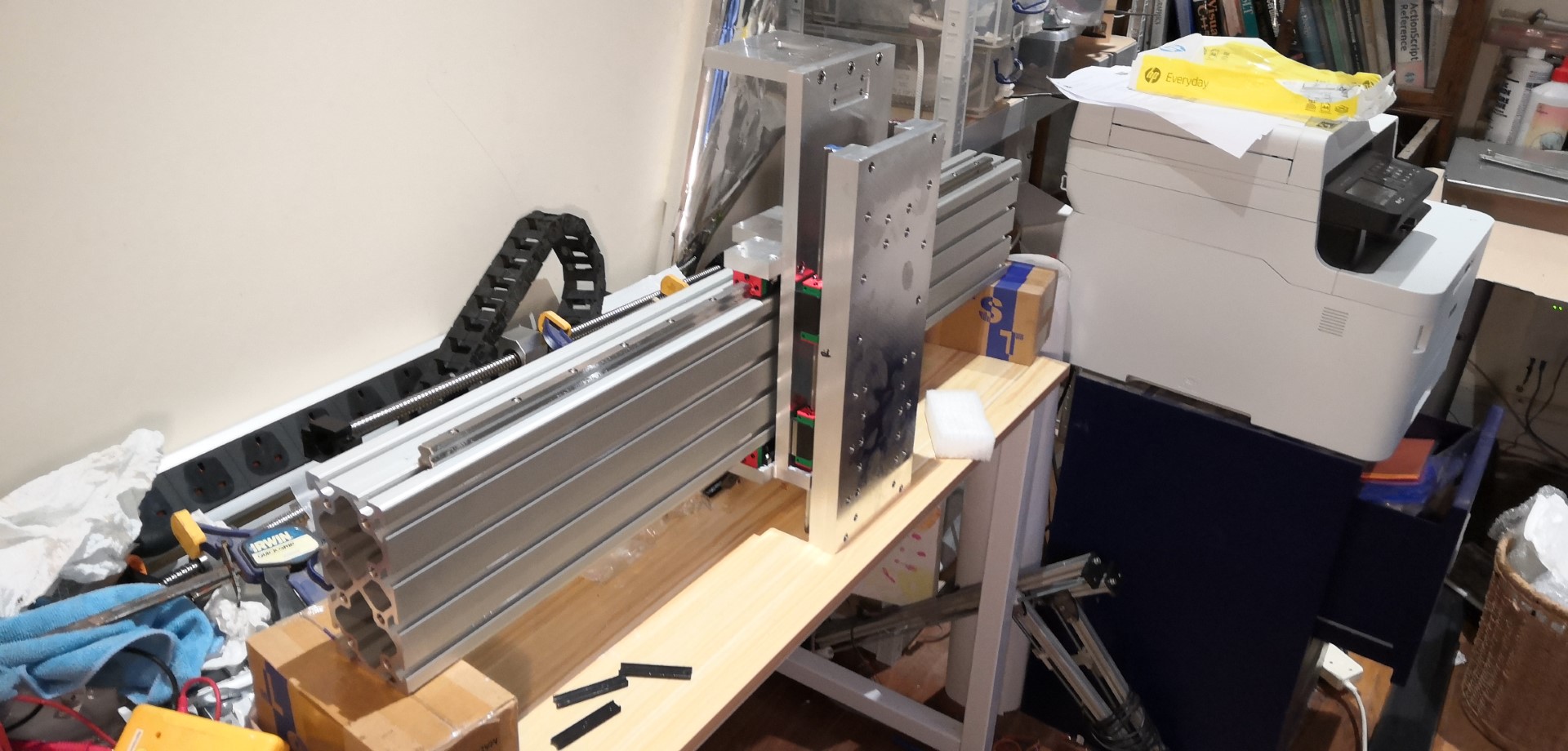

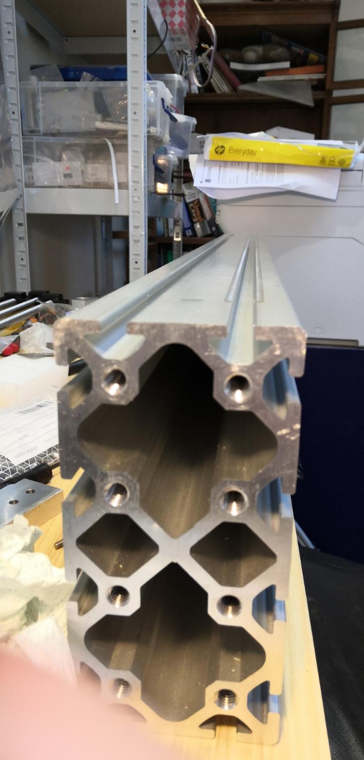

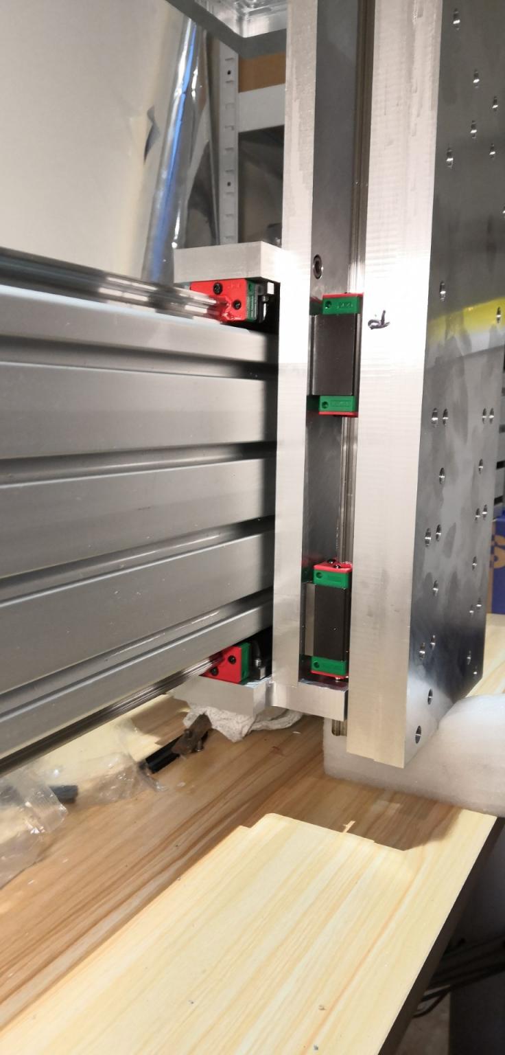

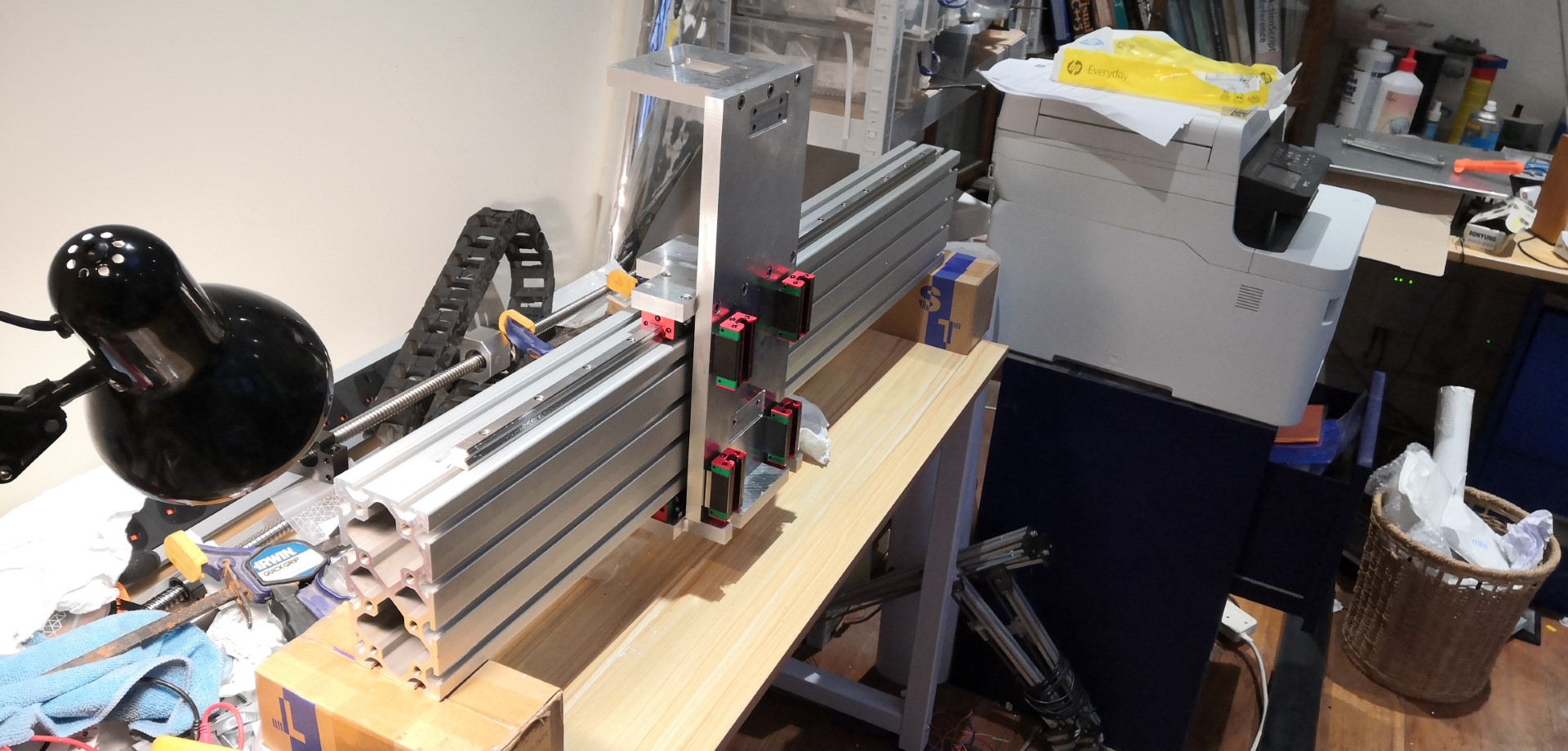

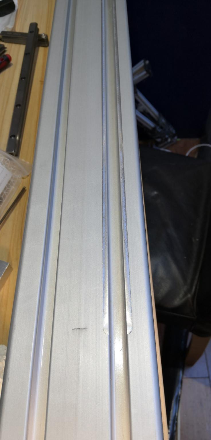

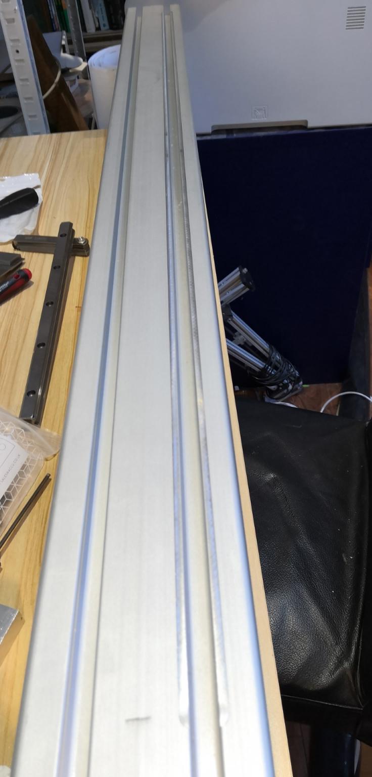

    Got the rails mounted on the milled gantry, worked really well. I've tightened them down but not yet aligned straight, for that I will mill up a couple of precision setting tools.
    I then finished the Y bearing plates and bolted everything together. Everything slides very smoothly with bolts tight, very exciting! The Y bearings have the same smooth action across the entire length with no hint of any variation so I presume the gantry milling was sufficiently parallel.

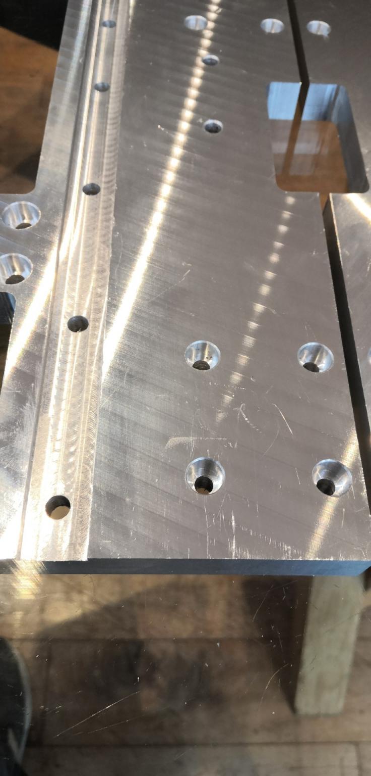

    One thing I need to do before too long is hit the corners of these plates with a sander, they are razor sharp and I keep bleeding all over the lovely shiny parts.

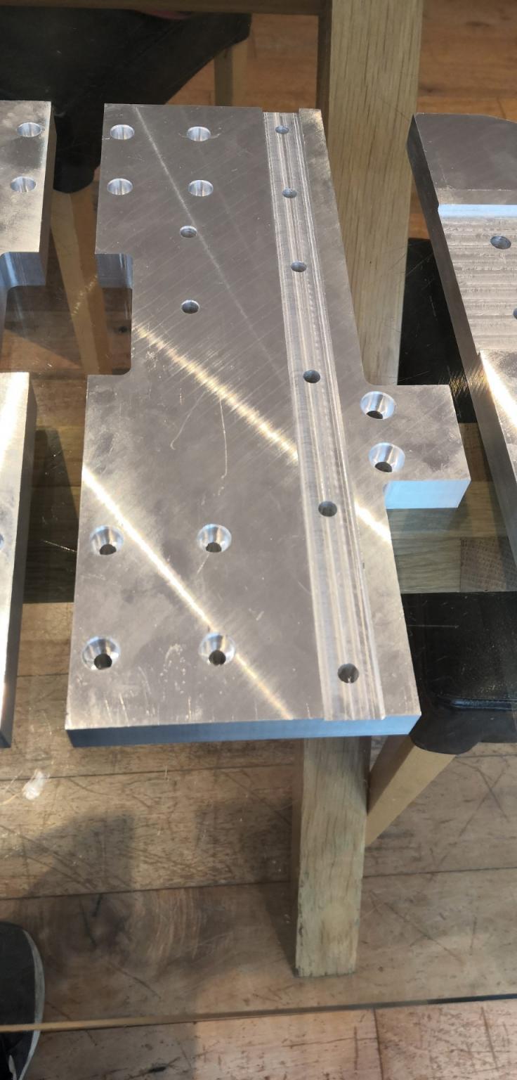

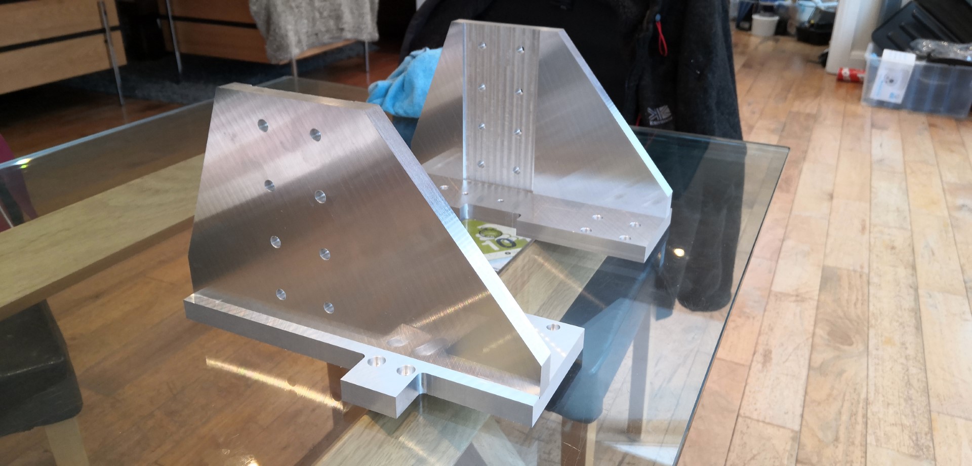

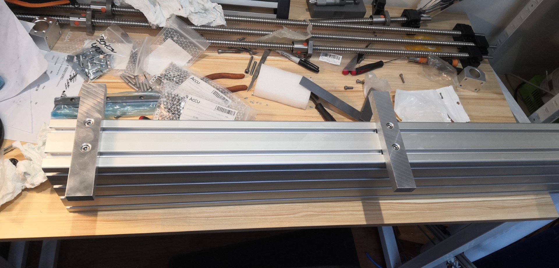

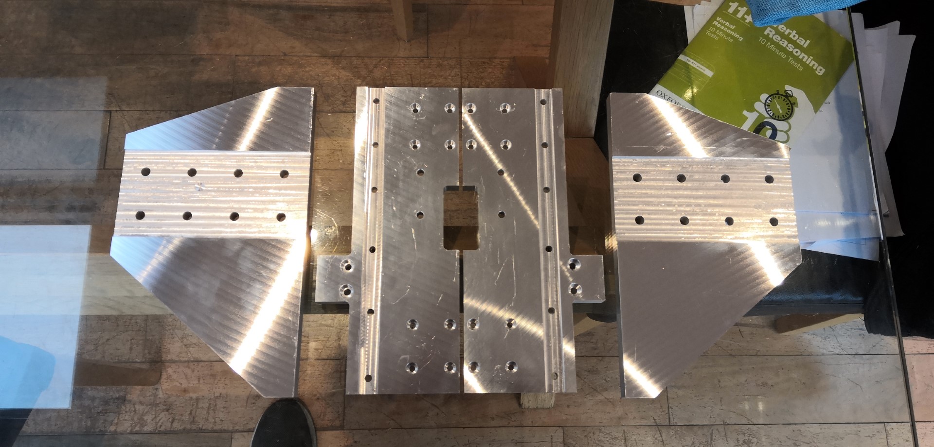

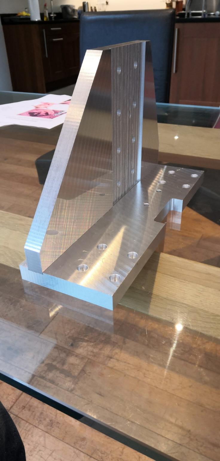

    Small progress update, I have finished the gantry end plates and X bearing plates.

    I have about 6 small plates to make for stepper and bk mounts then finished with the manual milling.

    Hi Steve,
    I also thought twice before milling the locating slots on the different plates. On some joints it is not so critical, such as attaching a stepper mounting plate but when you are joining two plates that locate the axis at exactly 90 degrees such as where my gantry end plates join the X bearing plates it is super critical. In this example it was also critical the slots in the top of the X bearing plates were not only planar with the plate surface but also identical depth on both X bearing plates.
    When I mill out shapes from plate I clamp the plate to MDF so the cutter clears the mill table. MDF (particularly when it has sat in the garage for a year) is not sufficiently uniform for accurate Z milling. Therefore I mill these slots after the outside profile has been finished. I set the Z height on the mill and lock the axis then I clamp each X bearing plate to the mill table directly and mill the slot. I do both plates without unlocking the Z axis so they should be identical.
    Before doing any of this critical stuff (particularly milling the gantry extrusion flat where the Y rails are mounted) I checked the mill table was flat within 0.01mm over the entire travel with a DTI in the spindle. You don't want to do this if your saddle is sloppy or any long work really.
    I'm an amateur machinist at best, only been playing around with the manual machine for a few months really so take this advice with a pinch of salt. The slots are within 0.01mm in depth over their length which is good enough and no worse than the milled plate itself. It is quite satisfying when you get a friction fit on the joint between two plates.
    Also bear in mind that the milled plate isn't exactly whatever nominal dimension you purchase, mine in nominally 16mm but is infact 16.055mm thick, also your cutters are not exactly whatever dimension they are supposed to be. This means if you just mill the slot to the DRO readout it wont be the correct width.
    What I do is designate one side of the slot as the reference since my cad drawing assumes 16mm plate, then mill that. Then open up the slot and use a piece of clean spare plate to test the slot until you get a nice fit, this is much more accurate than trying to measure with a vernier or micrometer as the slot is too shallow.

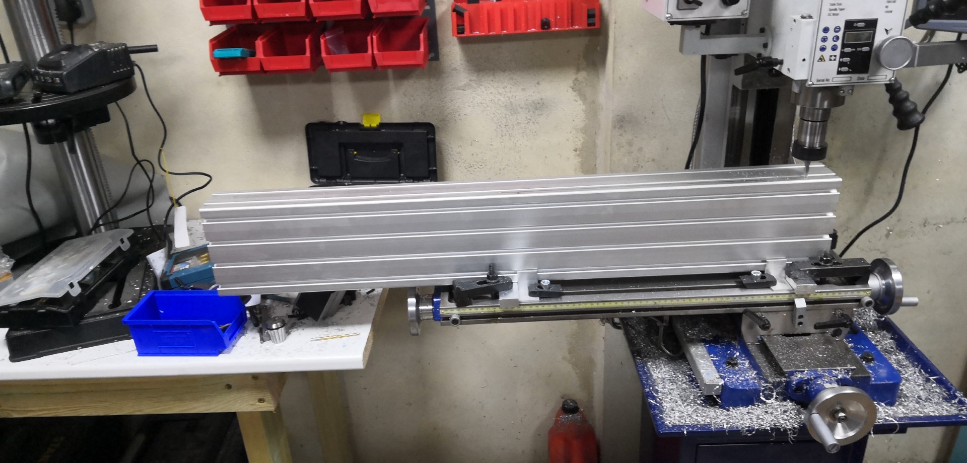

    Not really no. If you want the rails to sit flat then you have to mill the extrusion anyway particularly with 15mm rail on 8mm slot.
    When you set the rail you will need a setting tool to offset the reference edge of the rail from the edge of the profile, I am making the assumption that the extrusion itself is straight. The setting tool with be a pair of L shapes milled together so they are identical with a hole so they can be bolted to the T slot. The short part of the L will then form a reference surface to locate the rail.
    Note I'm referring to the rails on the gantry as the Y rails.

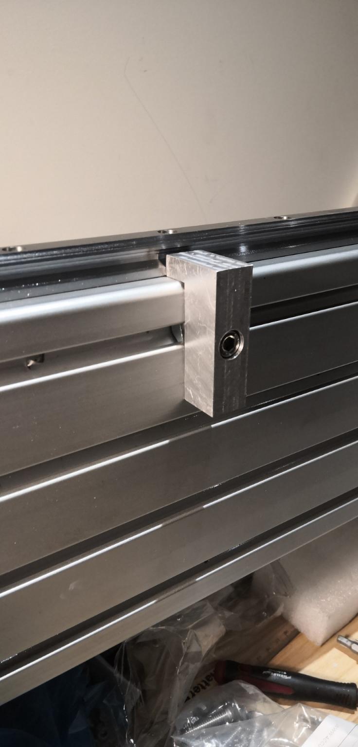

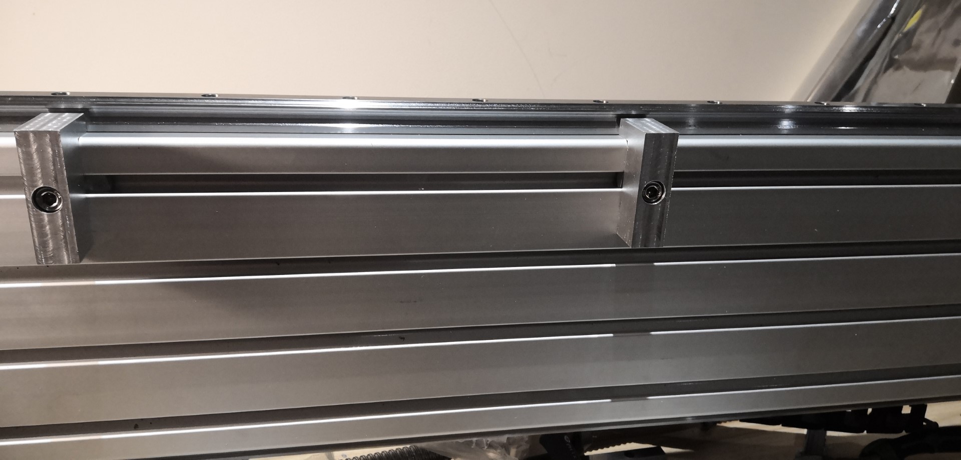

    Once I fit the gantry end plate assemblies to the gantry I wont be able to mount the Z assembly without removing one of them, therefore I think this it is time to align and tighten the Y rails to the gantry in their final location.
    For this I have just machined some precise setting tools, they were machined as a pair to ensure they are identical.
Name:	IMG_20200102_162536 (Large).jpg
    Here they are attached to the gantry, they bolt into the T-slot. Plan is to snug them up, the milled faces should then act as a reference surface to match up the reference edge on the hiwin rail, they will be moved along for each rail bolt. Note that I made them long enough so they extend across two of the high points that are on the reference plane on the face of the gantry extrusion.

    Plate-plate joint using the alignment slot:
