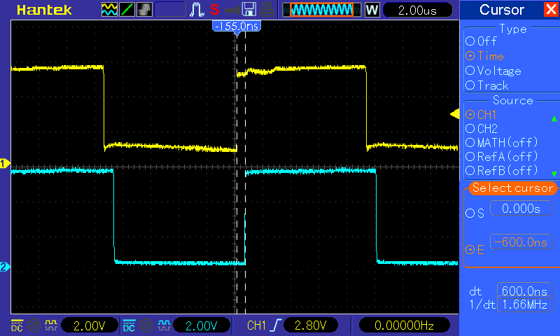

    So I've just scoped the DDCS. An axis setup as per my machine, 1610 screw, 16x ustepping -> 320 steps/mm, max speed 10000mm/min.
    As expected step frequency is ~53kHz, half period of 9.375us. Nyquist/Shannon tell us that this needs to be sampled at a minimum of 2f, i.e. 106kHz for perfect reconstruction. Puts an upper bound on my mirror code latency of ~9us, so to be safe say 5us. This is 80 cpu cycles, will it fit?? Should do, got to wire it in and test.
    DDCS defaults set dir 7000ns (7us) ahead of step therefore code running at 5us will always see this. EM806 only requires 2.5us but configuring DDCS to deliver this will risk breaking the contract woth EM806.

    So here is a baseline, the basic axis mirroring with auto squaring, but without I2C. Lag is 600ns after a lot of messing about I just stuck the logic in a lookup table and deleted all my code ;-) Yellow trace is step output from DDCS running at 10000mm/min, blue trace is the arduino step output, lag is shown in 'dt' bottom right.
  9. #117
    Doddy's Avatar
    Lives in Preston, United Kingdom. Last Activity: 4 Weeks Ago Has been a member for 9-10 years. Has a total post count of 1,364. Received thanks 188 times, giving thanks to others 66 times. Referred 1 members to the community.
    You're not going to get better than that!
  10. #118
    Quote Originally Posted by devmonkey View Post
    Hahaha love it. Sometimes 'ugly' solutions are just the best.
