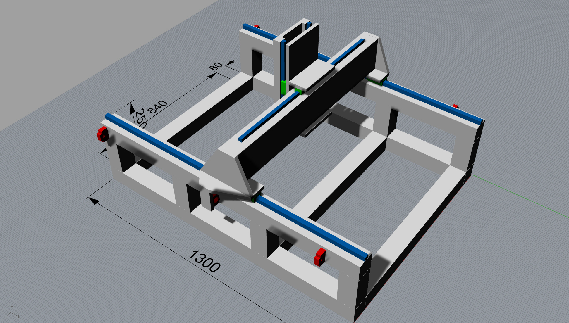

    This will be the 4th machine I've built but the first for 10 years and the first I have posted a thread on. After various house moves, workshop rebuilds, etc, I am actually without a functioning router for the first time in ages which is extremely frustrating!

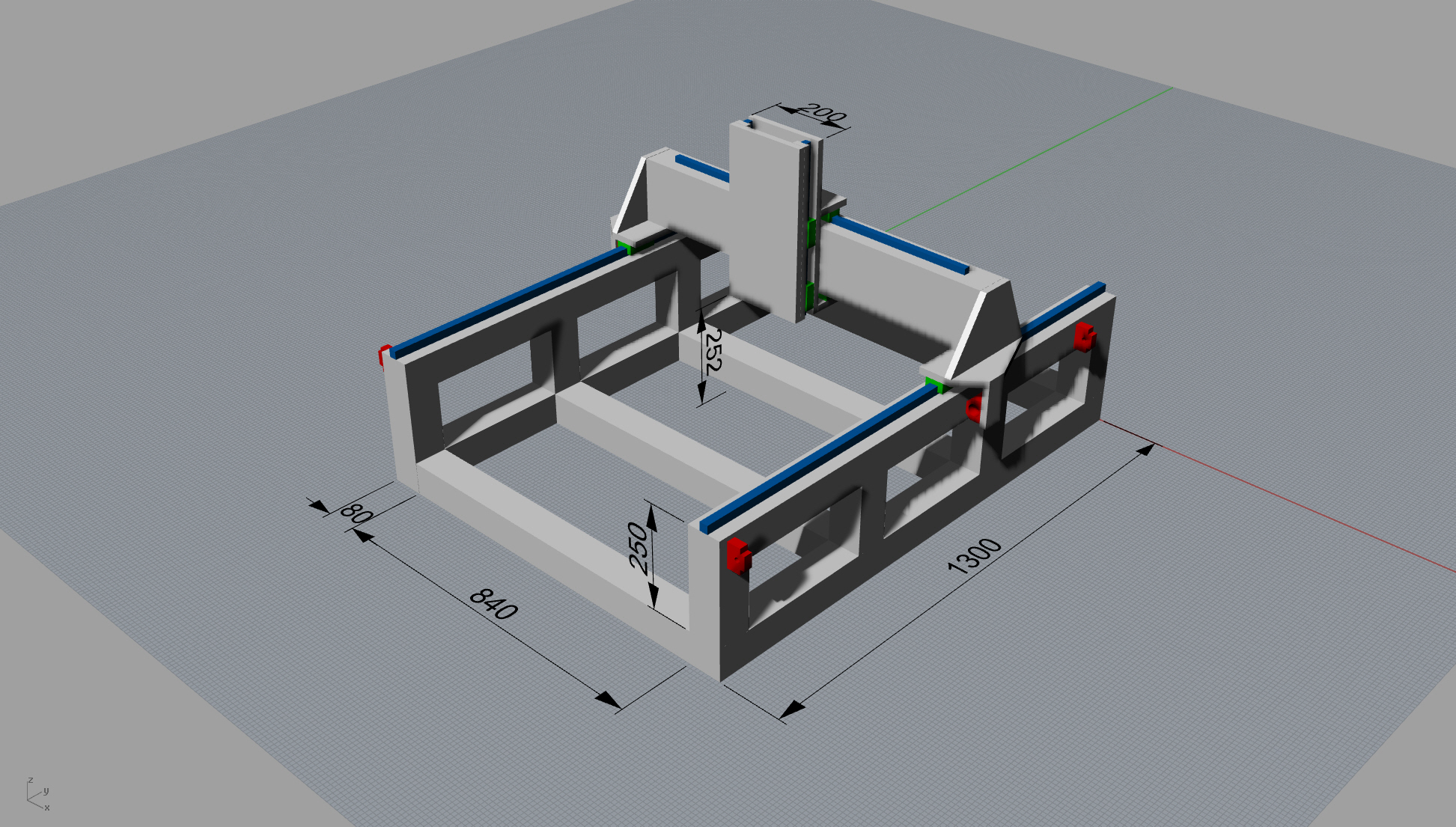

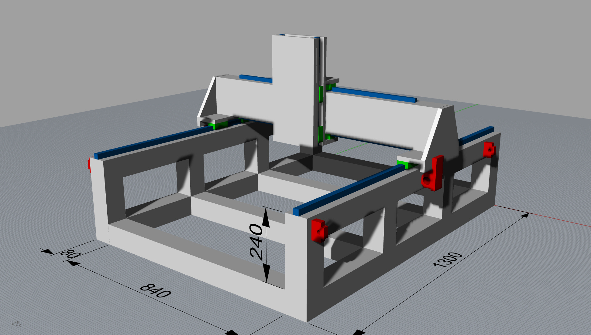

    This machine will be reasonably compact, work volume of around 1000x600x200mm. It is very similar to the first router build by Boyan, in that it has a self supporting bed frame with raised X rail supports. I need to process aluminium, carbon, modelling board and maybe hardwood.
    Frame is 80x80x3 welded steel box.
    Gantry is 160x80 extrusion (Item series 8 heavy or clone thereof).
    Plates will be 16mm cast milled tooling plate which I will have to produce on my manual mill.
    Ballscrews from Fred, 1610 on X+Y, 1605 on Z, with BK/BF12 AC support blocks.
    Hiwin 20 on X and 15 on Y+Z. X rails will be epoxy levelled with West 105/209.
    I'm going to use steppers (in the past I used DMMTech servos) but seemingly 3N steppers with digital drives are quite suitable for this small machine.

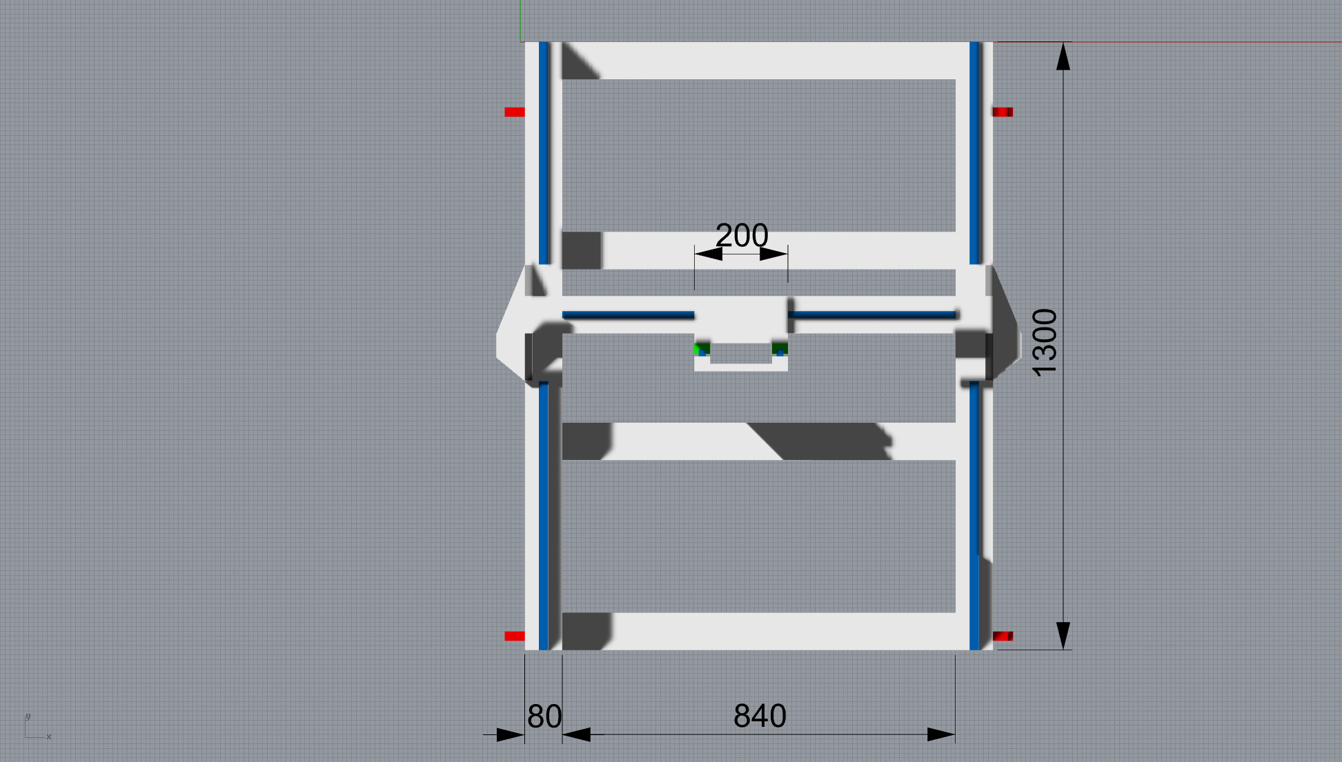

    I have done the basic dimensioning so I can get started on the frame. The gantry plates and Z axis will be adjusted as required but the sketches below should give you (and me) and idea of where I am heading.

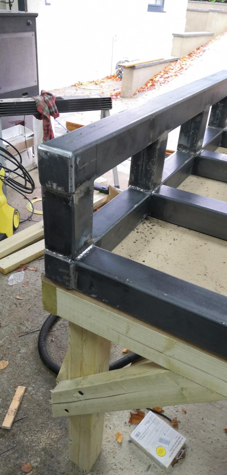

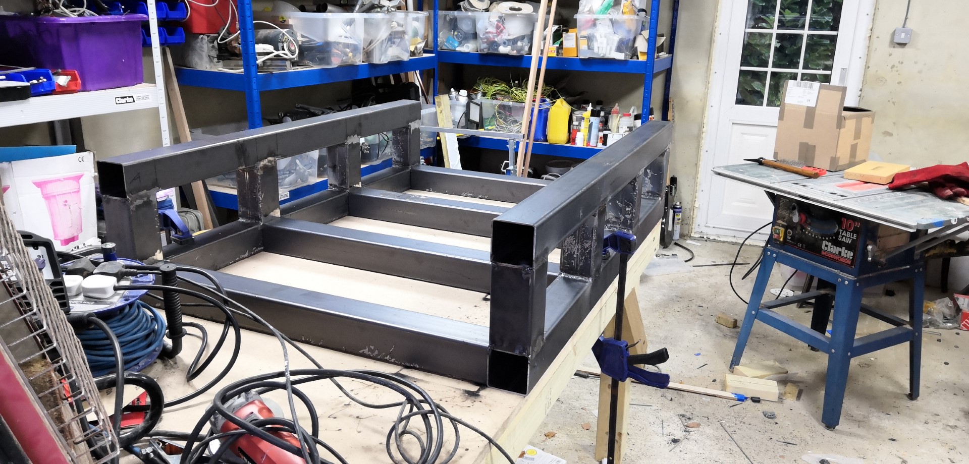

    And frame welded up, not quite finished yet, needs some end plates and reinforcements to catch the screw supports and motor mounts. I used an inverter stick welder, quite a revelation, amazing capability in something the size of a lunch box. Was quite careful to avoid warping, not by limiting heat but rather by carefully sequencing the welds to counter each other. I can't measure any warpage so it was successful.

    I would would welcome any input on the basic design, but more urgently I'd like some help on the following:
    1. Where is the best place to buy cast milled plate from? The guy I last bought from locally has gone to the wall.
    2. What is the minimum constant temperature you would risk an epoxy pour with 105/209?
    3. Has anyone bought extrusion from Alprofil? http://www.alprofil.com/aluminium_profile_frames.htm
    Cheers, Joe
    Thanks Andy, will call KJN tomorrow, they don't list the price for 160x80 on their site.
    Last time I used a 6"x2"x0.25" aluminium box section, it worked ok but wasn't particularly flat or straight. I'm hoping I can use the slotted profile gantry without having to shim the rail. Milling the gantry is a pain as my mill only has 700mm of travel so would need to move an re-reference and would loose accuracy.
    Looking good, classic design. Ballnut brackets off gantry plates may need a bit of support?
    I’ve always ordered from aluminium warehouse as you can select the exact size you need. Other members have mentioned cheaper sources elsewhere (Smiths?).
    I tried to keep 21deg C for the epoxy pour but from my brief experience with it I wouldn’t be concerned going down to say 18. I guess the heat might be required more at the beginning to keep the viscosity lower for the self levelling as it should generate its own heat as it cures. Others may have more to add on that.
    I've only used Aluminium warehouse for tubes in the past, couldn't complain about them, product came well packaged, but I've read on this forum their cast plate is sometimes delivered damaged? I guess the plate you received was ok?
    I've reconfigured the gantry end plates and extended the gantry. I wanted to keep the nut holder fixing on the outside so that I can fit simple angle over the screw to keep debris off it. With this configuration I would recess the X bearing plate and the gantry extrusion into the gantry end plate a couple of mm to keep the gantry vertical to the X rails.It also provides enough space outside the X rail to bolt up through the X bearing plate into the extrusion.
    The (red) ball nut holder assembly will be adjustable up and down and if I make the gantry a few mm wider it will allow me to shim the ball screw supports off the steel frame to get the screws properly aligned, making the absolute length of the gantry beam non-critical.On my last machine I didn't have enough adjustment to align the X ball screws properly and it was a bit of headache to sort.

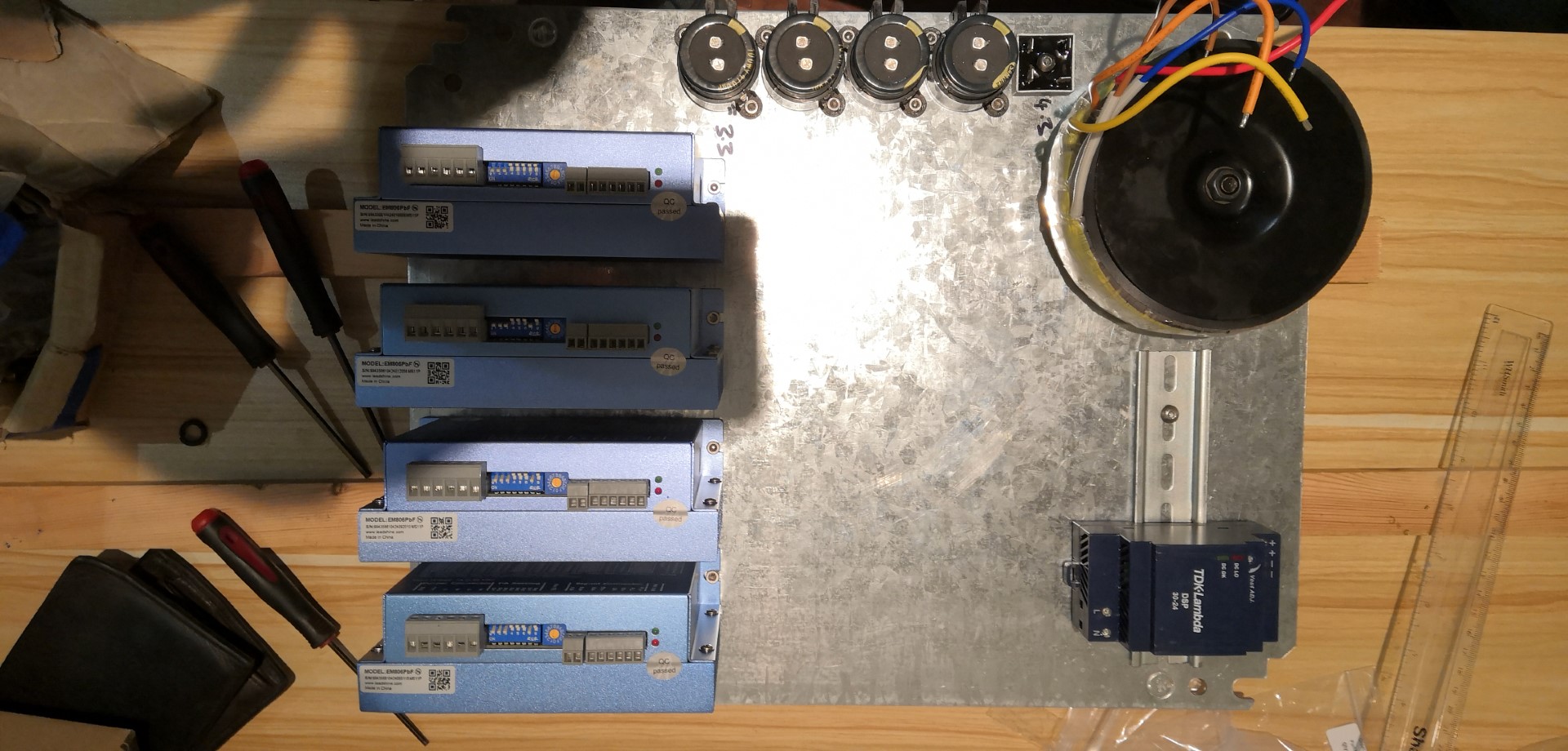

    I've chosen EM806 drivers. Yesterday I was about to order from AliExpress, thought I'd check Zapp first and Gary has a Black Friday deal on, managed to score 4xEM806 for £340 inc vat and delivery and rather unbelievably they turned up this morning 17hrs after ordering! What an amazing service and at the same or better price than China after duties without the wait.
    Steppers are ordered from OMC-stepperonline coming from UK warehouse, should be here in the next few days.
    Given the drivers arrived and I already had an enclosure to hand I've started to build up the electronics, PSU parts are from Rapid:

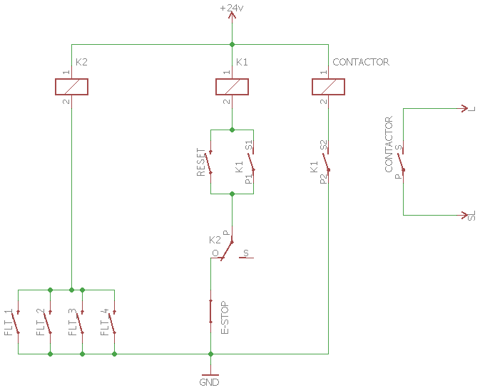

    Looking for some validation of my estop circuit as I didn't need to build one on my last machine, it was all integrated into the servo BOB.
    My proposed circuit is a normal start-stop relay circuit with the addition of the EM806 fault signals, is this how everyone else does it?
    E-stop is NC
    Reset is NO momentary
    FLT 1-4 are the open collector FLT outputs from the 4xEM806.
    K1 is a DPST relay, first pole used for latching, second pole to switch contactor.
    K2 is a SPDT relay using the NC contact
    Functions as follows:
    With no driver fault signals K2 is off and conducting.
    E-stop is conducting and in series with K2.
    K1 is off.
    Reset is pressed momentarily, current flows through K1 coil, latching K1 on.
    Now if any driver fault signal switches on, K2 swiches on breaking the path through K1 coil, K1 switches off. If fault clears K1 remains off until reset is pressed.
    Similarly if E-stop is pressed this also breaks the path through K1 coil and the same happens.
    Any additional NO sources of fault can be paralleled with the FLT outputs. Any other NC sources of fault can be added in series with E-stop + K2.
    Thoughts?
