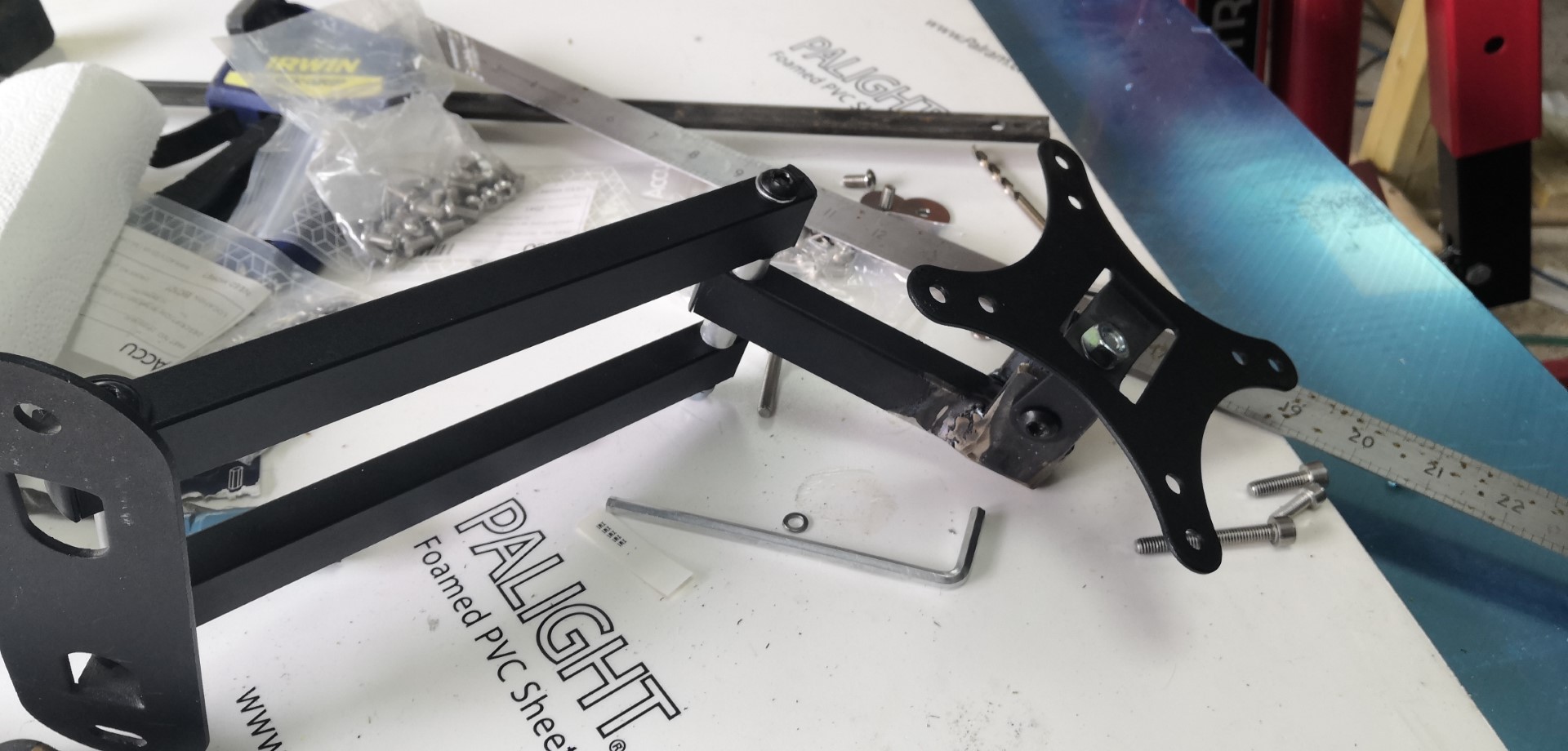

    Progress update. Today was spent putting some controls in a box and attaching it to the machine. I used an old TV mount and made some crude alterations to it with the welder.

    I also soldering up the MPG connections which was a massive pain in the rear.
