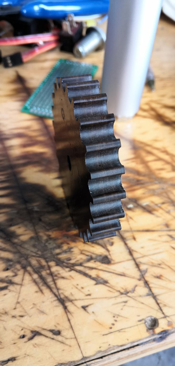

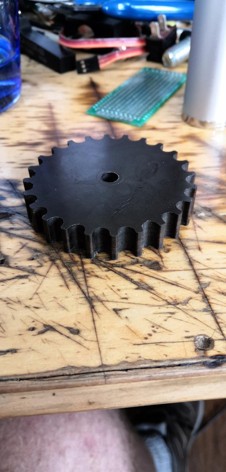

I use a free command line dxf generator that can generate all of the main timing pulley profiles, super simple.
I just cut an 8m test pulley in 10mm SRBP P1, if came out very nice and extremely strong teeth. I think I will use this material and laminate a few layers together then bolt through, it is pretty cheap stuff and locally available to me.
