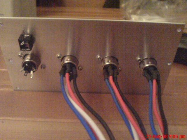

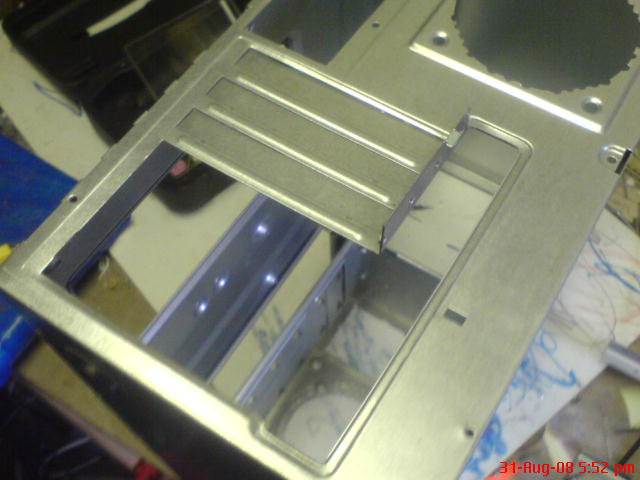

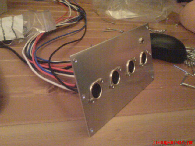

    In the end i had the bob wiring coming out the back and into the bob, the bob then went onto the m/b with no need for a parallel cable to conect them.
    Yea i had the PC in the same case, didnt get any problems and i never used shielded cable.
    Looking pretty sweet Lee! I like the idea of putting the drives and PSUs in the drive bays. You've actually had the PC in there at the same time as the PSUs and the drives going? I didn't really think it would be a problem, but its good to know for sure.
    Hopefully will get myself a mini iTX next month to finish off the box...
    Where did you get the black cable tidy stuff?
    Cheers,
    Dave.
    Yo,
    yea i was going to post up a build log with all the pics and so on, yea i liked the idea of using the drive bays as well, the tower is sat in front of me now, the plan was to extened the driver L.E.D's onto the front beisel? with fuses and so on.
    I was also going to swap the pooh red and green L.E.D's fitted to the case and replace them with clear bule ones, but no never got that far.
    Yea i'v got an older AMD based PC inside the case with all the other stuff, didnt see/notice any problems.
    The cable brading i got from the USA on 300m drums, dont know how much is left now as i used to sell it on ebay. I know i'v got lots of the smaller size left, they use it for ICE installs and stuff like that on cars.
    Steve i'v got a few big sheets of Ali, think its somthing like 1.5mm thick, its just sitting here if you can use that for this project ? I'v got some 200x200mm cut ready to go, shouldnt cost much to post it to you ?
    Thanks,
    I have got a load of that 'black cable tidy stuff' as well, got a couple if sizes which should do you, let me know if you need some of that as well.
