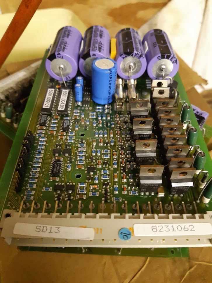

    Are they rack mount drivers?
    If they are, I think I've still got a rack from my Triac kicking around.
    Hi, Yes they are rack mount. I think the triac has two sd/2 drivers and one sd/3. Would you sell them if you do? Thanks Paul
    Lives in East Lothian, United Kingdom. Last Activity: 1 Day Ago Forum Superstar, has done so much to help others, they deserve a medal. Has a total post count of 2,994. Received thanks 376 times, giving thanks to others 9 times.
    You were right, two 2's and a 3.
    I have got no idea if they still work or not.
    Hi m_c that board is an SD13, it's different to the sd3, and I guess not interchangeable 😞
    I would have thought drivers would be interchangeable to some extent.
    I may still have the rack out my Cyclone, which is an older machine than my Triac, however I've not seen the box it was in for quite some time. I'll have a rummage when I get home tomorrow.

    To be honest, I'm not sure if they are interchangeable or not. I've got the machine going now using a spare sd/2, which has taken the heat off. I have 4 other spare boards, all of which appear to be broken so I've sent them away for repair. Hopefully they will fix, if not I'll be looking for retrofit options. Thanks Paul
