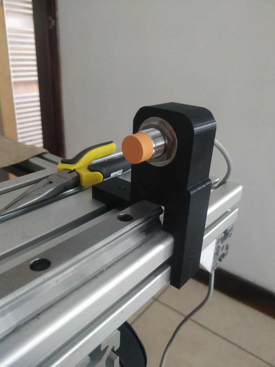

  8. #27
Name:	Proximity sensor mount.jpg
    I 3d printed a mount.
    Thanks again for all the advice.
  9. #28
    You may wish to revise the end-on approach, the first time you jog into and crush a switch. Don't ask me how I know. They work just as well when the profile just glides in from the side.
    Rob-T
  10. The Following User Says Thank You to cropwell For This Useful Post:
  11. #29
    Rob-T
    + one
  12. The Following User Says Thank You to Clive S For This Useful Post:
  13. #30
    Hmm, I could mount it sideways on. Im planning on using it as one of the home switches and just using mechanical switches for the limits that I would mount on the other side.
