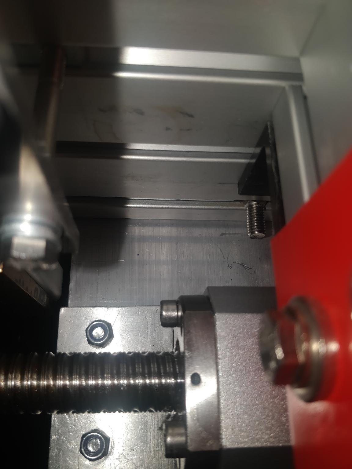

ID:	26965 OK guys so the plan now is to go with 3 proximity switches mounted sideways and now underneath the table one for homing two as limits. This looks like suitable place to put them.
  9. #47
    WiringDia_compressed.pdf
    So this wiring diagram is how the home switch works. Next question is how do I wire two of the same NPN NC switches in series to act a limit switches.
    Regards Chris
  10. #48
    Quote Originally Posted by chillybo View Post
    Regards Chris
    You are using an IP-M why would you wire them in series you're not short of inputs surely.? Wiring prox switches in series slows there reaction time so it, if not needed, wouldn't do it.
    However, if you must do it then simply take the Signal wire (black) from first switch to the (0V) on the second and repeat for any further switches in wired series. On the last switch take the Signal to the IP-M (-)input.
