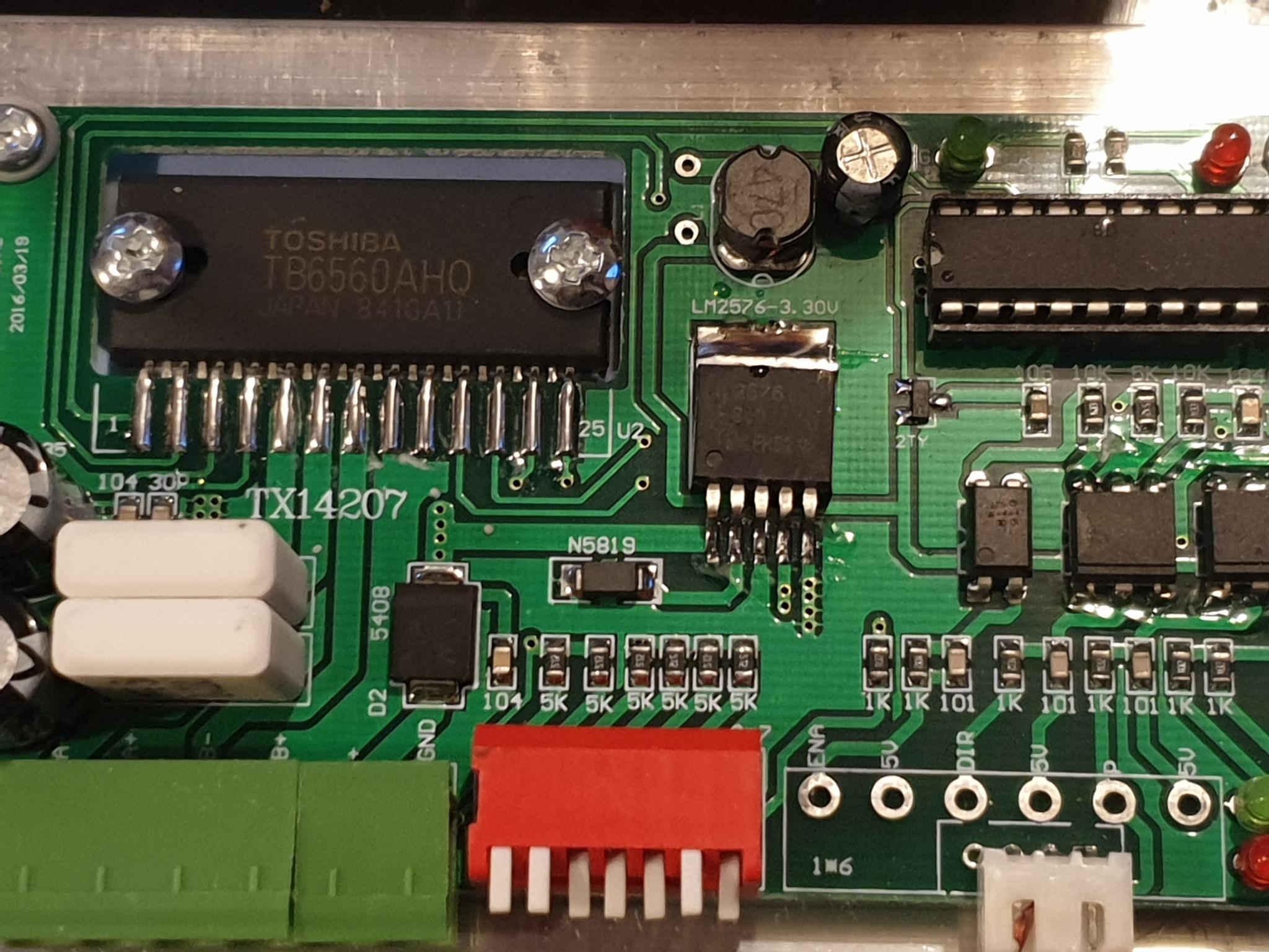

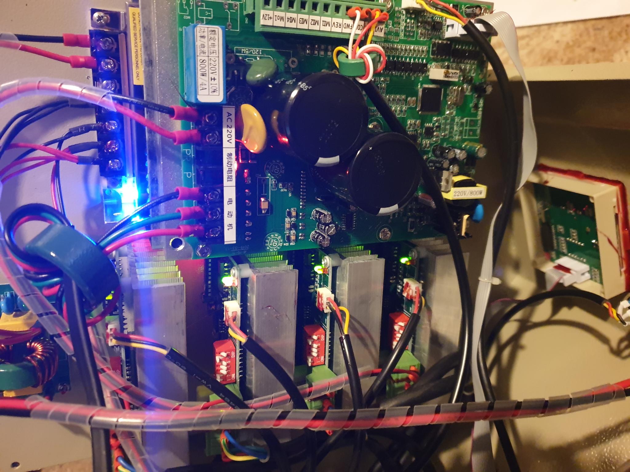

    Lol, A bit of progress. I opened the controller box up and there are 4 drive boards, I have the 4 axis version (see photos of inside). I have a bit of common sense and did not touch anything as the unit was powered on at 240v at the time. Don't try this at home
    The board for the Z drive had 3 leds one green the other red both aluminated. where as the other drive boards just had green leds illuminated.
    Attached photos.
    Anyway I POWERED OFF AND DISCONNECTED THE MAINS then swapped the connections between the A and the Z and now the Z axis is functional. On the board is TX14207 which I'm assuming I can source. Does not appear to be anything wrong with the board apart from the red LEDs. The top right Red Led on it's on has en near it does that stand for encoder? I did notice that when I moved the Z axis MACH 3 showed the Z axis moving even though it wasn't on the faulty drive board.

    EN = Enable, ironically if you drive this input you disable the drive. Normally left unconnected.
    That driver board looks like a generic stepper driver that's not been cased. You can replace with a generic stepper driver of similar spec. Use the A-axis driver for the Z for now but you might want to change the current drive (dip switches) to the same as the old Z driver.
    Sometimes Electronics fail, google bathtub curve. Especially cheap Chinese.
  8. #7
    davitc,
    The toshiba TB6560 is a very common analogue stepper driver chip. You can buy a new board based around it on eBay for about the price of a pint. Put 'TB6560 stepper' into eBay and you'll be offered millions of them in a handful of different shapes. Upgrading to digital drives, even the least expensive ones from, say Stepperonline) in the future will make your motors run more smoothly and quietly and at a lower temperature.

    Don’t panic. The photos are a great help. The top photo is the VFD motor controller with 240V main input and just below it 3 outputs going to the spindle motor (usually called UVW). The green terminals along the top are controlling the forward reverse and speed. If it comes to it you can rig something up independently so don’t worry about options on that one. Signals are either a simple switch between 2 terminals or a 0-10V supply for speed, so don’t need to make big decisions on other items just to get VFD working.
    Also good news to see separate drivers. That TB6560 is common and cheap. I would send a photo of all the lights on green except the red one on the faulty driver to the seller and just say you just need a new stepper driver sending over. It might be cheaper for them to do that and get you on your way.

    The replacement Stepper Driver arrived yesterday so I am back to 4 axis again :-) . Found one on ebay.
    I do notice that the stepper motor (used on the A axis rotary) is very notchy at low feed rate, even to the point where it does not make a 360 degree revolution, say at G1 F2000 but at G1 F4000 it is fine. Is this down to the poor torque of the stepper or could it be just some tightness in the A Axis unit somewhere. There are a number of dip switches on the TX14207 anyone got any further info into what these do?
