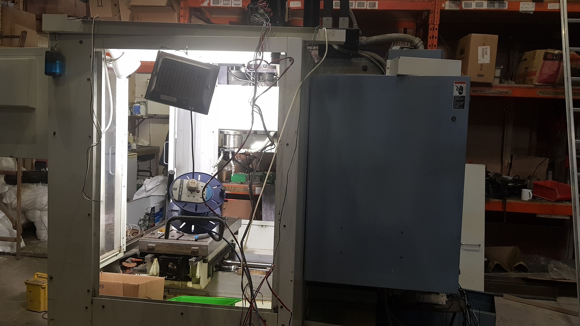

    Ok another small update, Spindle motor off ready for clean up or replacement with Servo Spindle motor.?
    I needed to measure shaft length, diameter plus find bolt spacing because I'm considering fitting a 10,000rpm 11Kw Servo Spindle so needed this info, which I could probably have found from Fadal spec sheets if honest but I wanted to get in there and give it a good clean up and check belt condition, etc. Which is like brand new.
    With the belt off, I can now feel and check the spindle bearings and balance, both of which are perfect I'm pleased to say.
    As you can see nothing on this machine is lightweight so it's a bloody good job I've got a fork truck because I wouldn't fancy humping that big lump down from up there.!!

    Another small update: After further investigation of the 4th axis it seems I can remove the DC motor and replace with an absolute AC Servo to match the others, only 750W instead of 1.5Kw.
    The old motor was a round flange type and the new ones are square but it's simply case of drilling a few more holes and tapping into to the existing plate. There is a seal on the plate that motor shaft goes thru and the pinion gear clamps onto the shaft using a collet type system. SZGH are making the shaft to fit the seal and pinion.
    So when done it will back to all it's glory using the factory fitted 4th axis slimmed down with a nice shiny new controller, some extra grunt in the motors and spindle.!!! . . . . Well that's the dream anyway so lets see what reality delivers...
