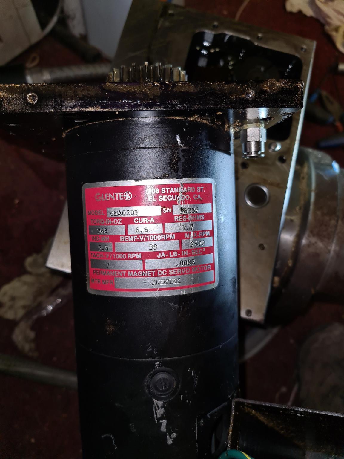

    Yes, I've seen and considered those Servo motor packages. To be honest, there's nothing wrong with the AMC Drive or Baldor Spindle it's just the 3 phase I'm trying to get away from, but that might not be so easy to do and keep all the power it currently has.
    The plan is to remove the DC motors and drives which all work, only the Z-axis card is faulty. I think some of the control cards have gone down which is why I've pulled it apart, it's just not worth replacing Axis and Control cards without knowing 100% if that's all that's wrong.

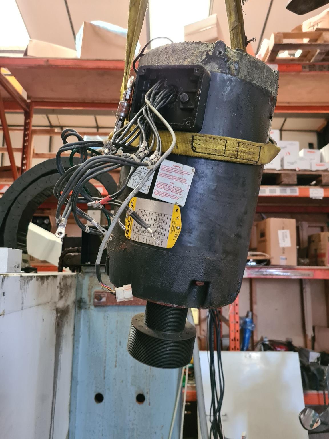

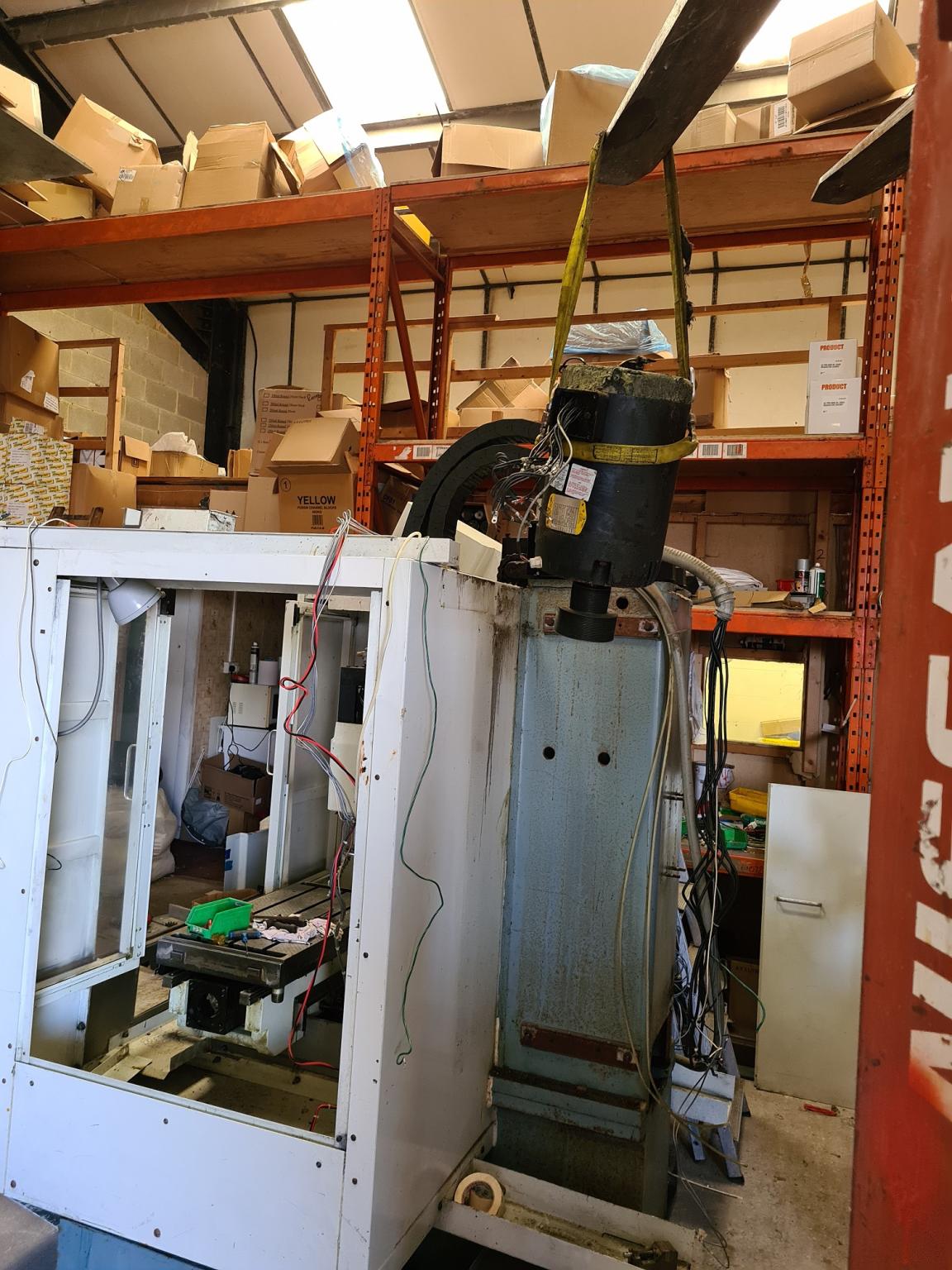

    Ok another small update, Spindle motor off ready for clean up or replacement with Servo Spindle motor.?
    I needed to measure shaft length, diameter plus find bolt spacing because I'm considering fitting a 10,000rpm 11Kw Servo Spindle so needed this info, which I could probably have found from Fadal spec sheets if honest but I wanted to get in there and give it a good clean up and check belt condition, etc. Which is like brand new.
    With the belt off, I can now feel and check the spindle bearings and balance, both of which are perfect I'm pleased to say.
    As you can see nothing on this machine is lightweight so it's a bloody good job I've got a fork truck because I wouldn't fancy humping that big lump down from up there.!!
