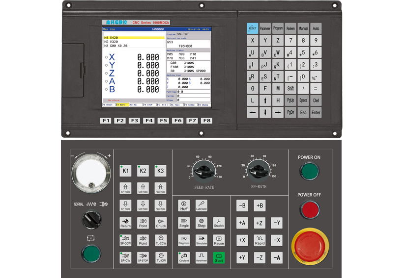

    Ok quick update.
    I'm still in the process of trying to decide which controller I'm going with. I'm narrowing it down slowly and I think I'm nearly there.?
    These are the candidates that are still in the running.?
    Linux CNC with Mesa Cards 7i76e + 7i85 which I've already purchased and are currently being played with by Clive (Clive S) testing with AC incremental servo's and closing the loop back to Linux CNC.
    Next up are two Chinese industrial controllers both using 2Kw Bus type Absolute Servos. Newker 1000-18i-Mi and Gunt - 350iMa both with C type Subpanel with MPG.
    These are interesting to me because I like the idea of an industrial controller without a PC. I also like the idea of Bus type Absolute servos because of the ease of use wiring/setup and servo's always knowing their exact location even after power down so not having to install limit or home switches.
    My reservations are both of them are Chinese and I'll be dealing with Chinglish manuals which won't help when it comes to writing ATC macro's and using PLC.
    However, I'm used to Chinglish and dealing with Chinese company's and the price is very very good.!
    Only downside is I won't be able to use my 4th Axis so I'll probably sell that if take this route.
    I was looking at Adtech controllers/servos but I've seen some negative comments from users about lag on 3D toolpaths or on toolpaths like adaptive with high data rates due to slow DNC feeding the code from external cards etc. Also after carefully checking out specs and manuals etc, they are quite limiting in speed at 10mtr/min when really this machine would run closer to 20mtr/min rapids with 2Kw AC motors.
    http://newker-cnc.com/index.php?m=co...=165&l=3&id=90
    Lastly and new to the running and one that I'm seriously considering using is Puruvesi ET10 controller using UmyCNC software.
    This is a company I've only discovered in recent months through helping another member of the forum and after doing a lot of research and reading the manual cover to cover I've become very impressed with it.
    The Ethernet controller is very well made and provides both Analog and Step N Dir closed-loop system with more than enough I/O for my needs. It also allows me to mix Step n Dir with Analog so I could keep the 4th axis with an encoder change.
    The UmyCNC software is very nice indeed, not so much because of how it looks but for what it allows you to do and the S curve planner it uses. It pretty much allows you to build a system exactly as you'd like it using a mixture of G-code and C++ Macros and PLC. S-curve planners give very nice smooth toolpaths.
    The GUI is fully customizable so you can build custom front end if required and it's very Touch screen friendly. (I'm not keen on the profiles provided so I probably will be doing this.!) It's also very flexible regards what computer and OS it will run on, Linux, Windows even Raspberry py's. I'll probably run it on Linux as it's a very stable OS.
    The only downside with this setup is that I will have to use Incremental encoders as it doesn't support absolute encoders.
    Another BIG plus is the backup and fact hardware and software are both in house. I've already been in touch with Ivan at Puruvesi who has been super helpful with quick replies answering technical questions and offering experienced advice. The support and backup is a big Plus.
    I'm also seriously considering switching to there lower ET6 and ET7 models controllers on the routers I build. They have everything I need from a controller, like slaved motors and gantry squaring/homing, probing, built-in camera vision system and tangental knife friendly which is great for some of the plotter type machines I build. Again the S curve planner is also interesting and exciting because they really shine on routers and improve performance massively on 3D toolpaths.
    They will also be more than good enough for the Mills I convert and the future plans I have for super-strong Mini Mill I intend building. They are also very plasma orientated which is a bonus and an area I will be looking into more also.
    However, as always I'll be thrashing them to death first on a test machine to within an inch of its life before I commit to switching. But to be honest I haven't been this impressed by the Spec of a controller/software for a long long time and after communications, with Ivan, I'm very optimistic it will be a good experience. You can rest assured if it's not you'll hear about that as well.!
    I'll keep you posted.

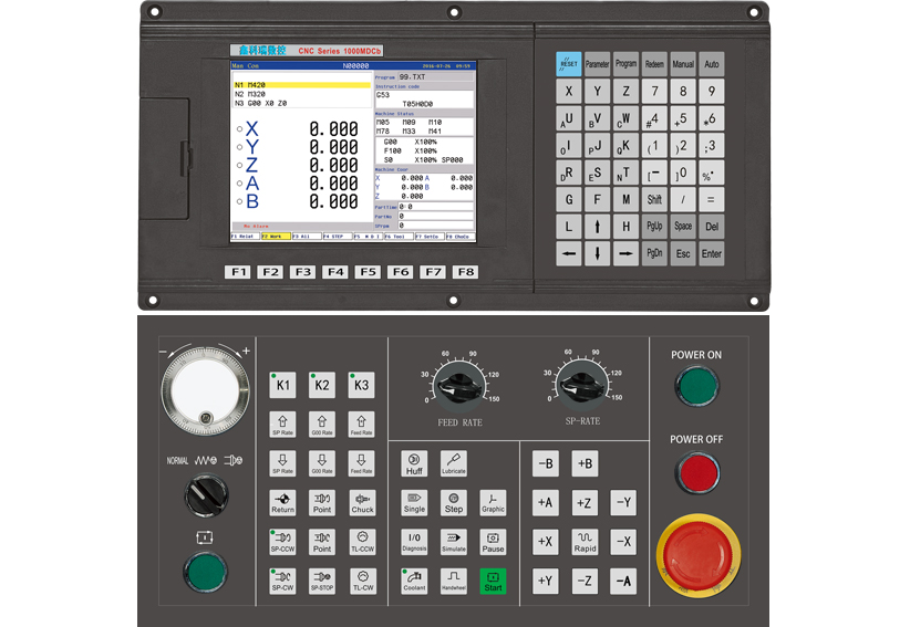

    Ok well, it's decided I'm going with the Newker New18Mi Bus type Controller with 2Kw absolute Motors and drives.
Name:	newker control.jpg
    It's a bit of an unknown using this controller and the Bus type controller but I've read the manual cover to cover a good few times and Newker has been helpful answering my questions quickly with good explanations of few things I wasn't sure about. So decided to give them a shot and the price is excellent, which I won't disclose as I promised them I wouldn't because they have done me a bit of a deal so please don't ask.
    If it performs as I hope then it should make for a very nice addition to the machine increasing performance and reliability.
    Watch this space.!
