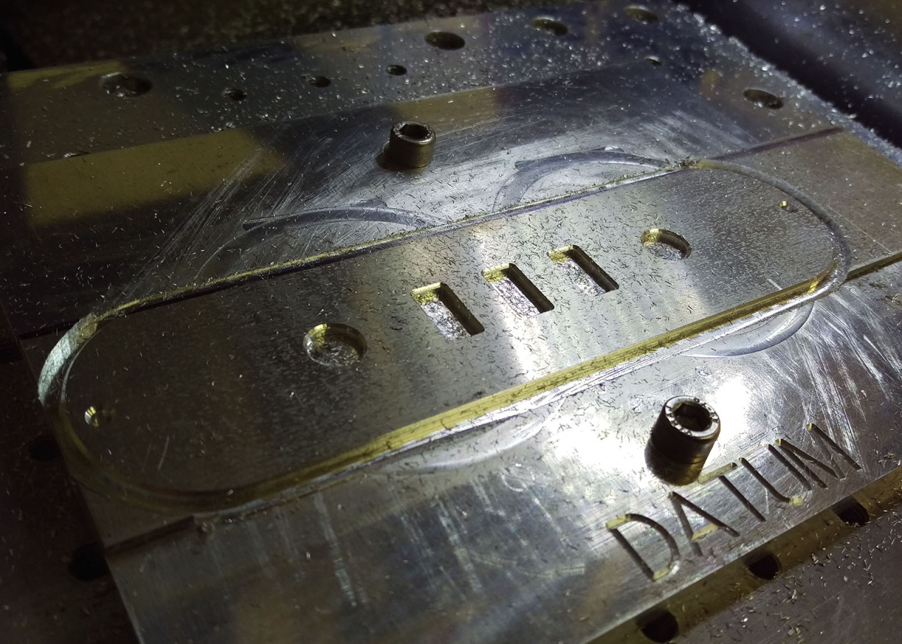

    I've just finished making something similar-ish - a control plate for a telecaster, but to accommodate Hofner style switches/pots etc.
    Pretty straightforward process - client sent me the original Hofner control plate to scan/trace - fag packet sketch with good measurements would have sufficed, he wanted it pretty exact so sent through the original. Once that was traced, the over-sized outline profile to cover the body cavity was created and approved.
    Sketch below shows original Hofner style plate (blue), body cavity to cover up (red), outer profile (black).
    After that it was a case of cutting it out of 2mm 6082 aluminium and giving it a polish - the latter probably took the longest time...
    It's one of those easy jobs that's a bit of a double-edged sword... will still take you three or four hours to do properly, but you'll be lucky to get £25 for doing it..!

    Wal, Thanks for the info. Looks good. You have confirmed one of my fears - that it might be too small a job for it to be worth anyone's while taking on.
  13. #10
    Its funny Wal because i was getting ready to send you a msg about this thread as it looked right up your street lol.
    Wow, I don't think I've seen 6082 polished as good as that before, would love to know your workflow for those results!
    Raymond have you found someone to make this for you or will you be making it yourself by hand?
    It would be pretty easy to make if you've got a bench belt/disk sander, lots of people use this method of printing 1 to 1 on sticky back paper and using the print as a template to make the part, or I can draw it up for you if you have no other offers...
