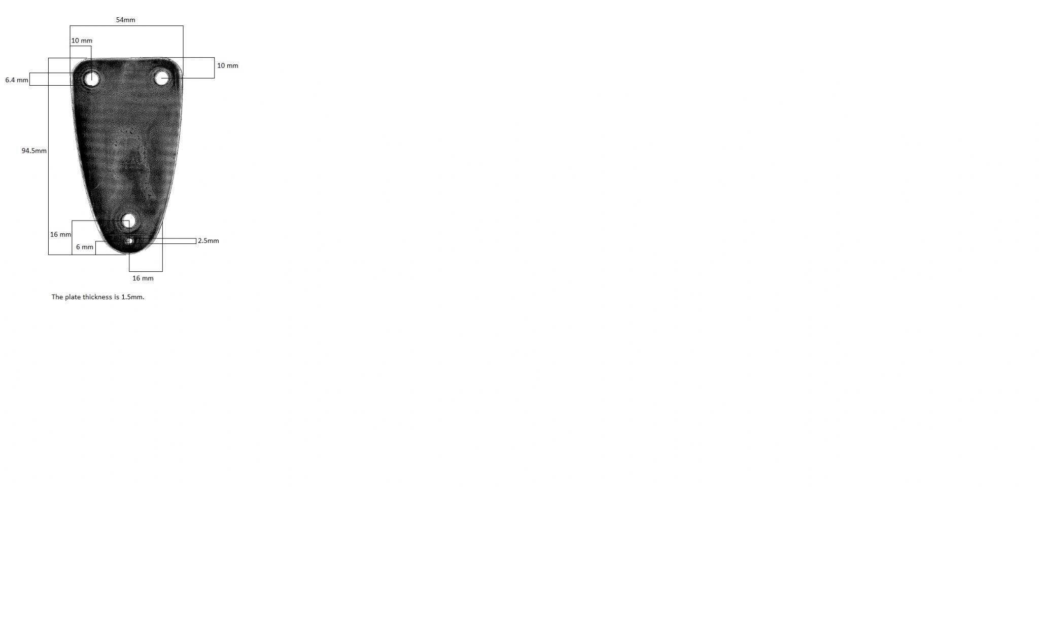

    Lee, Yes - I have a plate. I was originally just enquiring to see if this was the sort of work someone think was worth taking on. But now that I have had some many offers of help, I have taken the plate off its existing bass and I will attempt to scan it tomorrow, at work.

    If you have an original plate don't bother scanning it just draw around it with a fine drawing pen /fineliner. I wasted a lot of time scanning pickguards to image trace when a simple outline would have done the job.
    Andrew
  7. #16
    Andrew, By the time I had read your response, I had already scanned it. I think it scanned ok (see attached) or do you still think a outline drawing would be better? When I then print off the PDF file and compare it with the actual plate, it is a perfect match (to the level I can measure it).
    The additional picture file is my attempt to add dimensions, but it is not to scale.
    Let me know what you think. This is all new, but very interesting, to me. (Hopefully it is to others, and I am not just annoying everyone?)

  8. #17
    Hi Raymond
    The pdf + the dimensions should be enough for someone to make cutting file. A line drawing makes it easy to image trace and saves some time with the software (i'm a bit slow learning these programs as I was brought up pre computers and tend to forget how i've done things with software) This might be a daft question but do you have a cnc machine or are you after someone machining the part for you ?

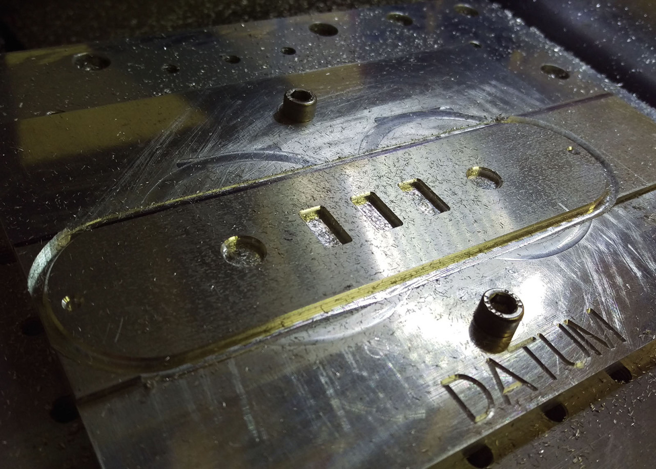

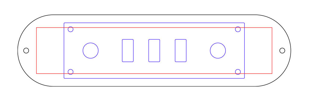

    I've just finished making something similar-ish - a control plate for a telecaster, but to accommodate Hofner style switches/pots etc.
    Pretty straightforward process - client sent me the original Hofner control plate to scan/trace - fag packet sketch with good measurements would have sufficed, he wanted it pretty exact so sent through the original. Once that was traced, the over-sized outline profile to cover the body cavity was created and approved.
    Sketch below shows original Hofner style plate (blue), body cavity to cover up (red), outer profile (black).

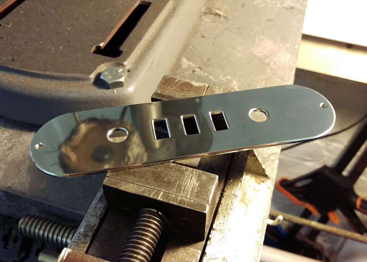

    After that it was a case of cutting it out of 2mm 6082 aluminium and giving it a polish - the latter probably took the longest time...
    It's one of those easy jobs that's a bit of a double-edged sword... will still take you three or four hours to do properly, but you'll be lucky to get £25 for doing it..!

    Wow, I don't think I've seen 6082 polished as good as that before, would love to know your workflow for those results!
    Mostly tears, Lee. Hot, salty tears.
    Heh. Start with a sisal wheel and brown compound, then a quick run on the belt sander fitted with a felt belt, then on a colour stitched wheel still using brown compound and finish with softest wheel and blue compound.
    It's a faff. Especially using a pillar drill..!
