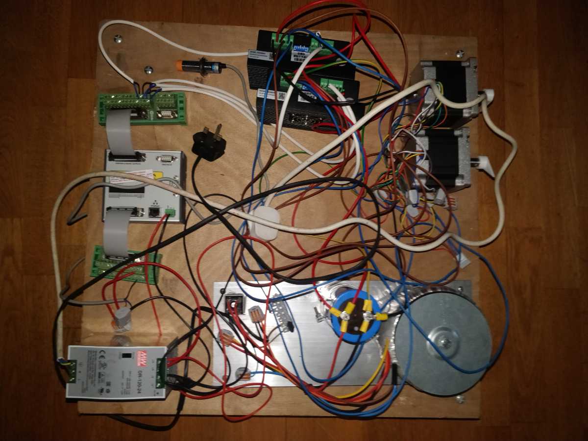

    Thanks Muzzer. I ended up ordering a 600 x 600 x 300mm enclosure. I will wire it up on a back plate and then install it into the enclosure as you suggested. I have thrown things together on a 600mm square piece of ply at the moment just to test how to wire the electrical bits (and to finally see an axis moving).

  11. #17
    That photograph looks like a blatant rip-off of the insides of my control box!
  12. The Following User Says Thank You to Kitwn For This Useful Post:
  13. #18
    Looks like a standard reference design to me :-)
    I really need to tidy my lathe conversion up before I post any pics
