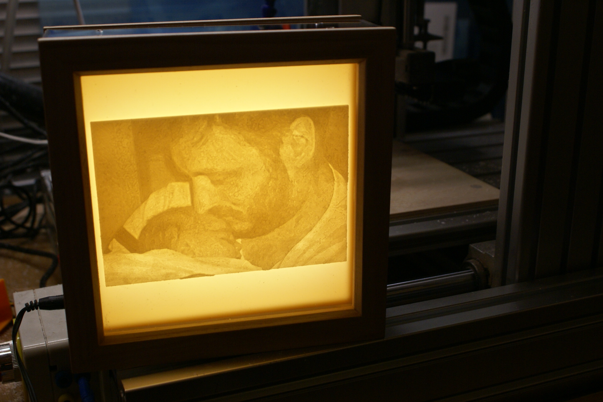

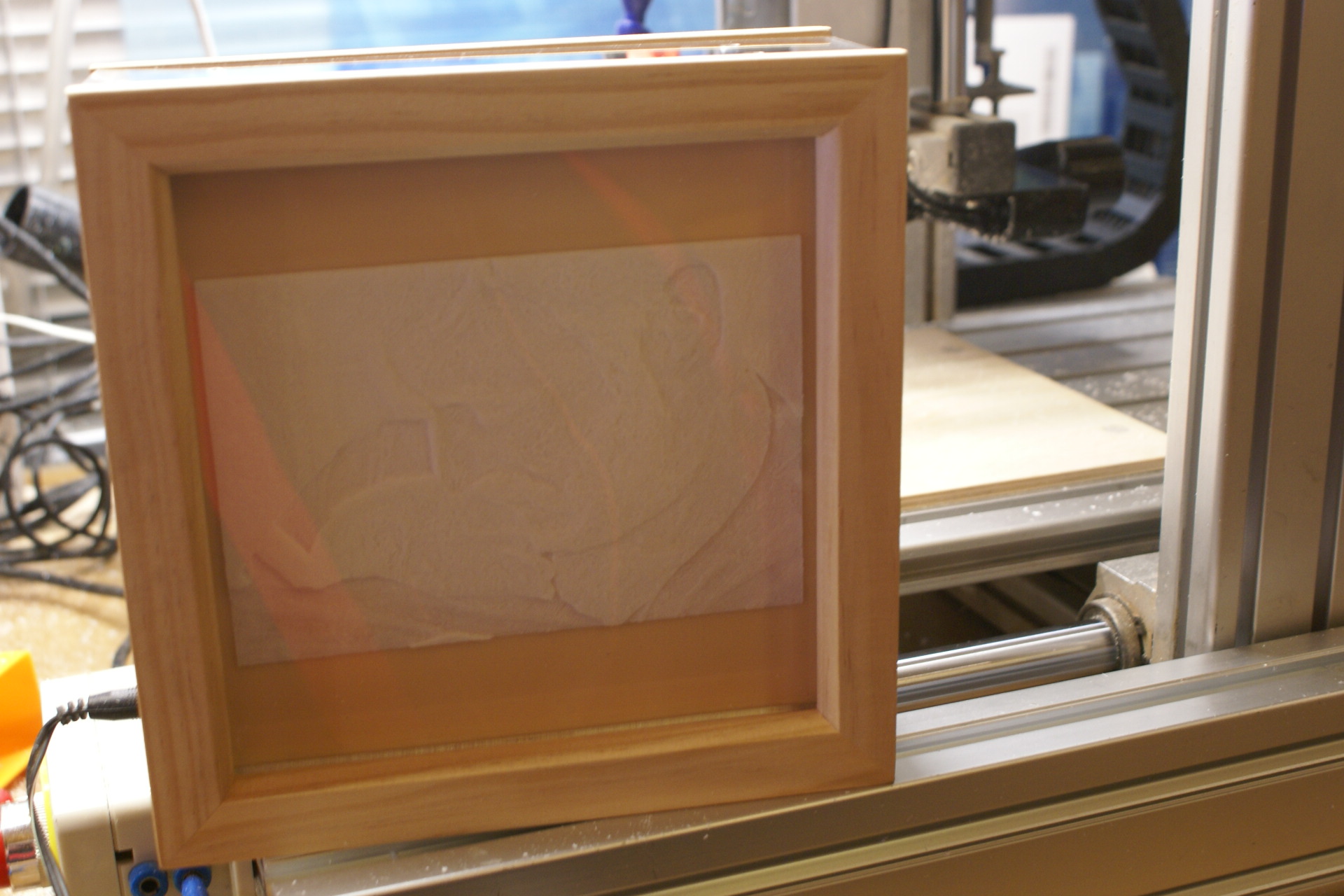

    I did the lithophane a couple of years ago and only just got round to making it up in a frame.
    It makes a difference when lit.
    The frame outside is clad in mirror perspex. It is extruded and it cuts a lot different from cast, it seems to be softer and stickier to the cutter. I virtually cut it underwater, spraying it liberally with a mix of 75% deionised water, 25% isopropanol and just a splash of rinse aid.
    Well that is one present done, almost - I need to take it to a clean area and dust it inside.

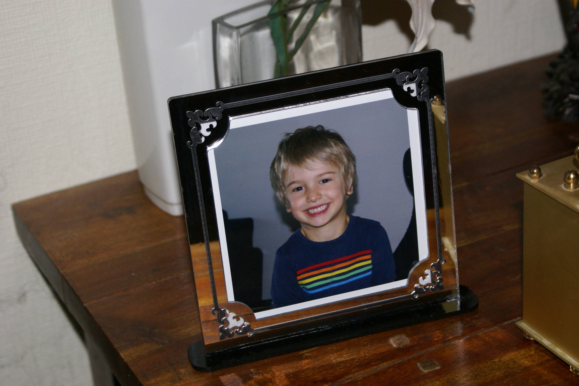

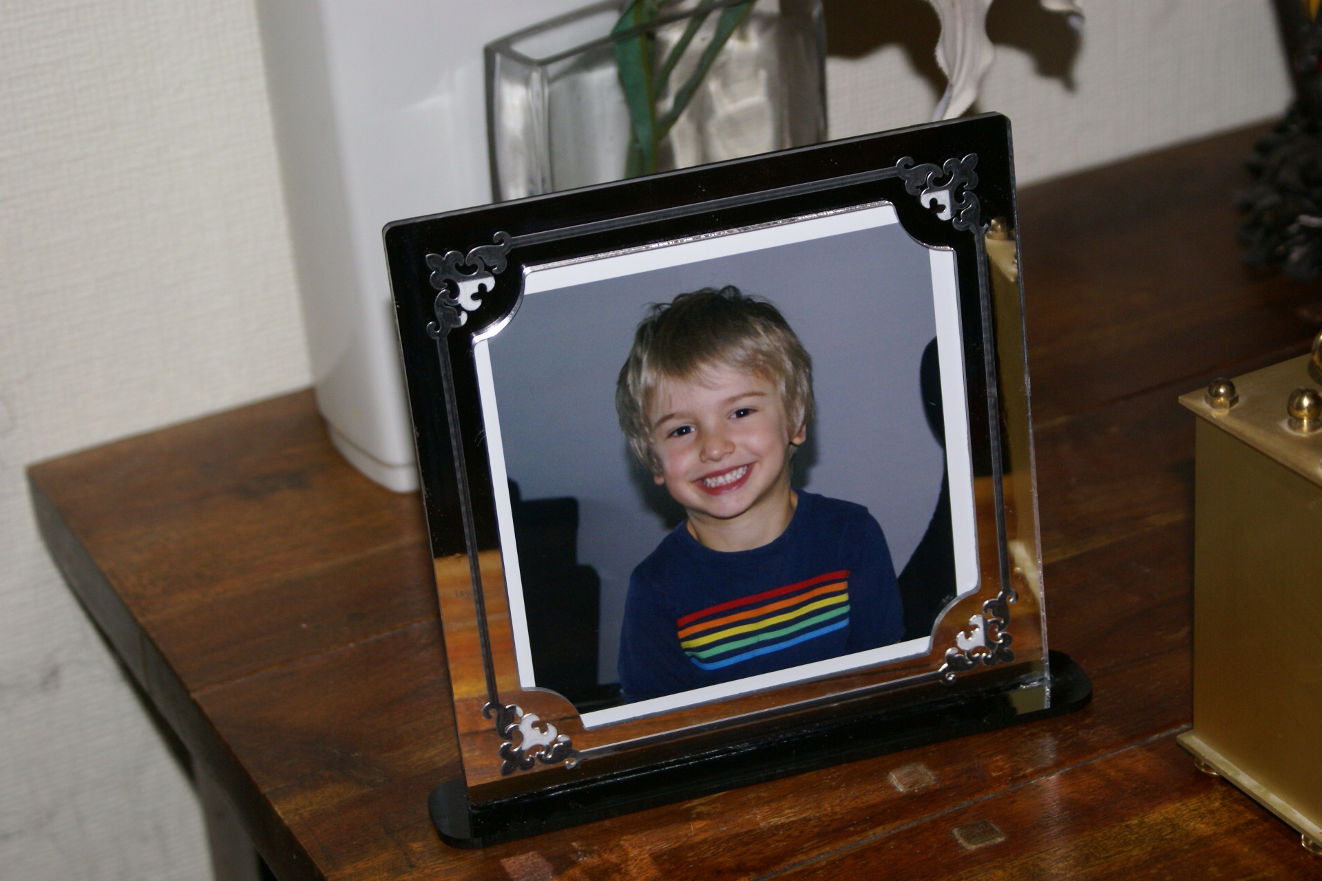

    Made something else with that extruded mirrored perspex. Cripes on a Bike! does that stuff clag your cutters like shit on a blanket. First attempt with 60deg 3 flute stuck on so much I nearly lost the cutter.
    Would using a thin silicone oil as a cutting fluid help I wonder??? It's pretty inert and slippy stuff. I seem to remember my late father using when doing something on his watchmakers lathe.
    I have tried all sorts of things- I am fine with cast perspex, it seems to be harder and the chips can be blown away (single flute - as open architecture as you can get). I am seriously thinking of some sort of water tray to enable me to use more of a flood coolant.
    Anything oily just kills the adhesive on double sided tape.
    Anyway no more cutting till next year, I need to tidy up my workspace.
    Rob-T
