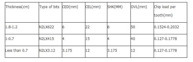

For cutting 1.8-1.5cm MDF, N2LX622 with 6mm CED is good enough. N2LX415 is for cutting 1.2-0.7cm MDF, and thickness below 0.7, you can use N2LX3.12.
Here is the suggested figure to cut different thickness of MDF:
Normally, we use 18000RPM to cut MDF, but need to adjust feed rate, for example:
Recommended parameter to cut 1.8-1.2cm MDF:
RPM: 18000RPM
Feed Rate: 10-11m/min
Recommended parameter to cut 1-0.7cm MDF:
18000rpm
Feed Rate: 7-8m/min
