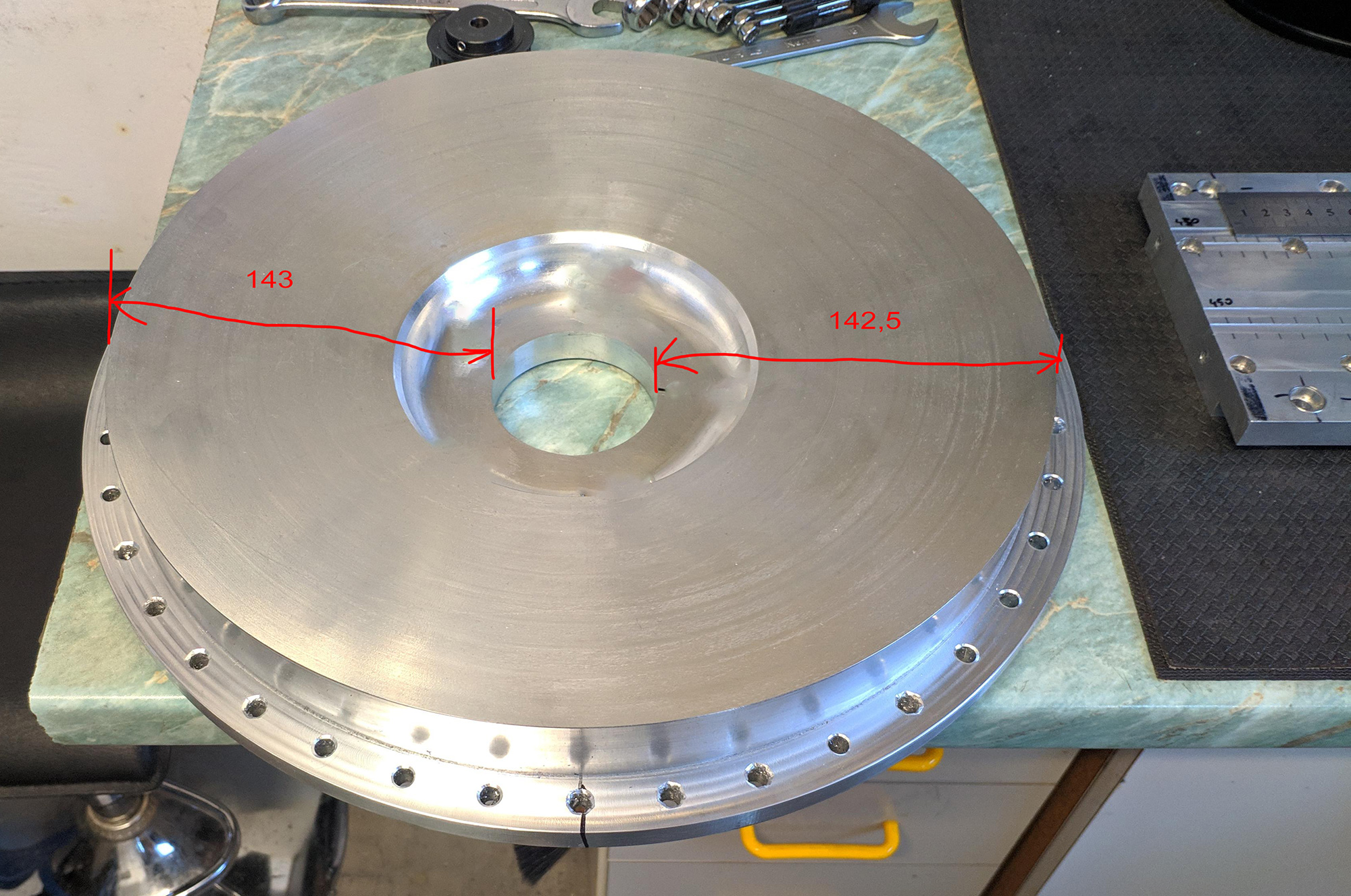

  1. I wonder what would cause this error on my parts. Till recently, all worked well, but on my last 5 parts i noticed error on x axis. It is the same error on all 5 parts. It is cut circle and there are also 40 x 7.1mm holes made circular around that circle. Error is 0.5mm only on x direction. See the illustration bollow what i mean:
    https://i.imgur.com/wB1vJnK.png
    The holes positions have same error, so i assume it is worn leadscrew / nut, but when i move the x axis by hand, i dont feel any movement, so i wonder, is this mechanical error or is there some electrical issue? i use chinese servo motors (bst motion, krs?? 400w) and cslab csmio ips controller.

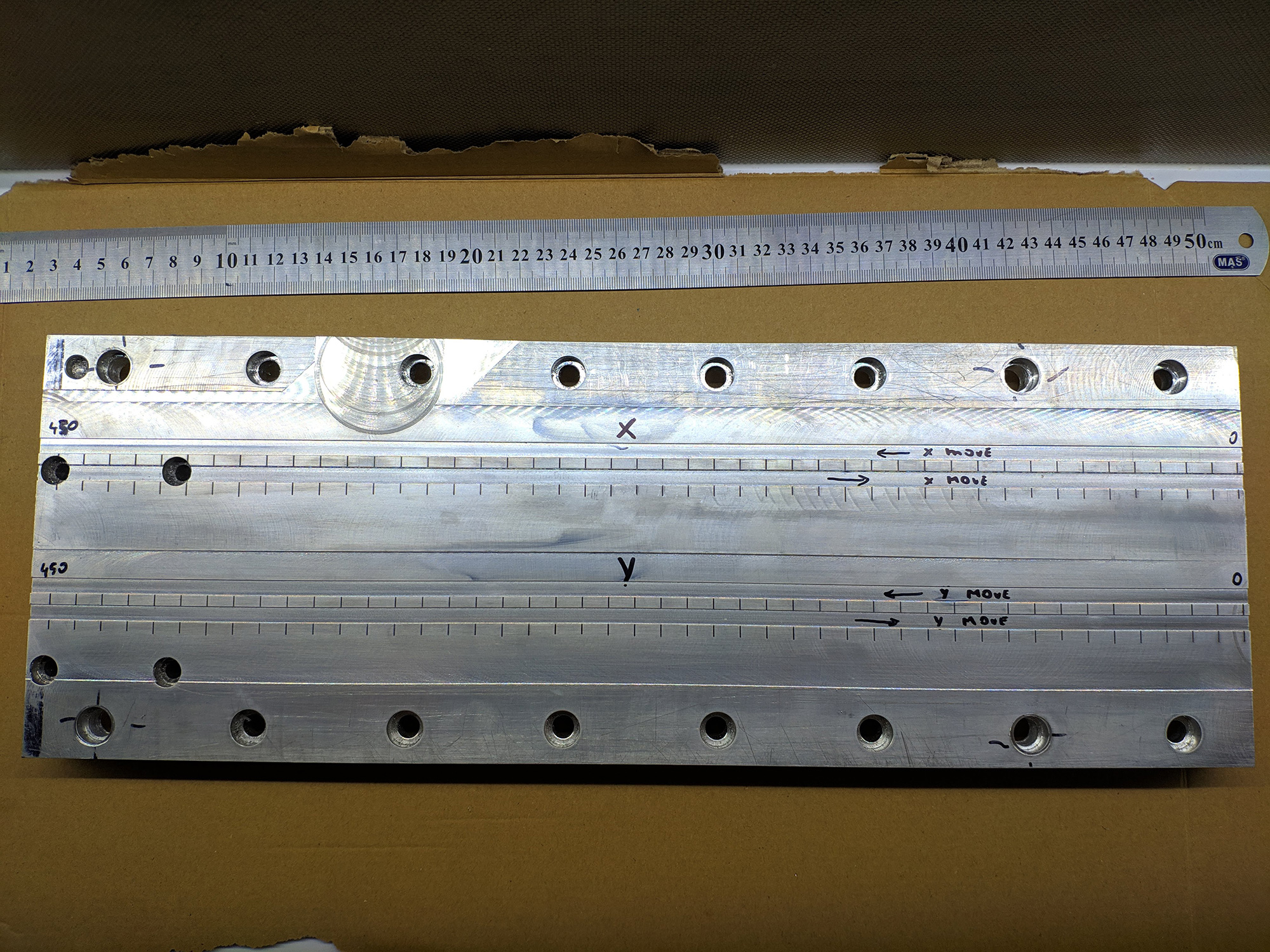

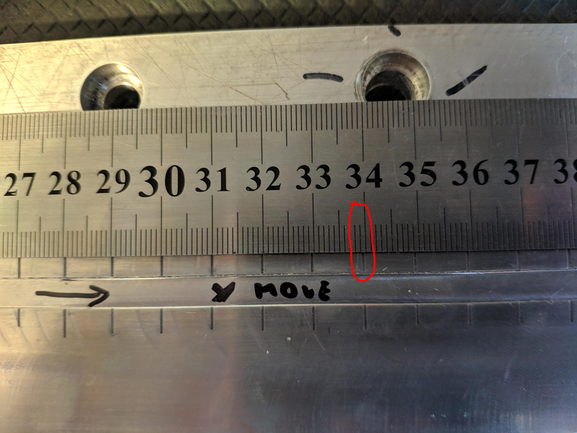

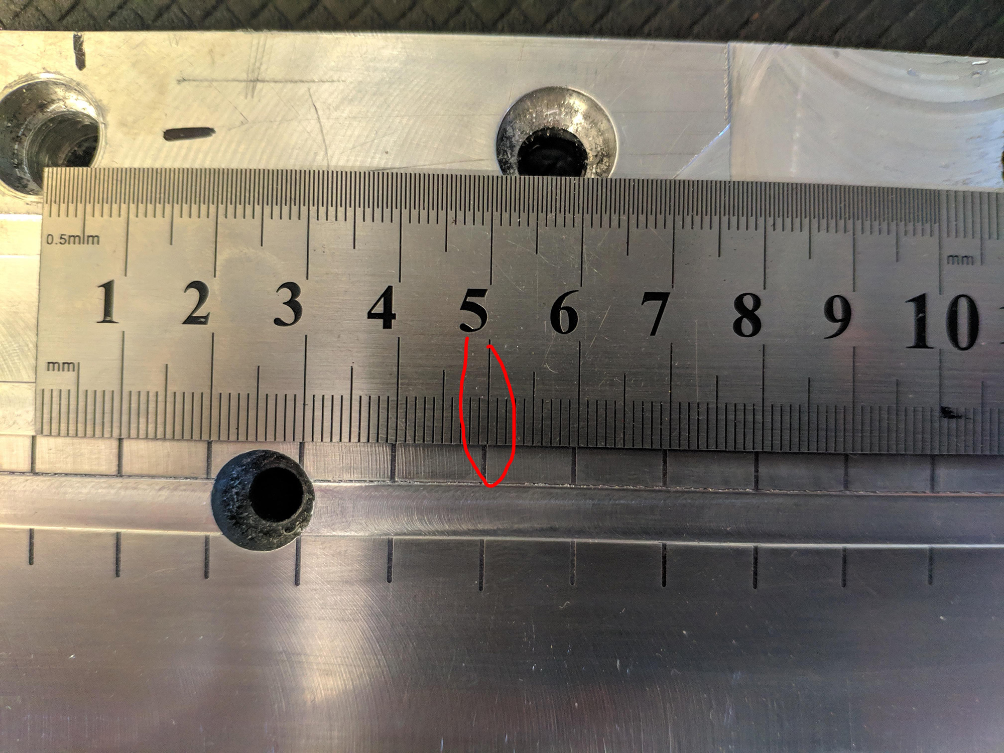

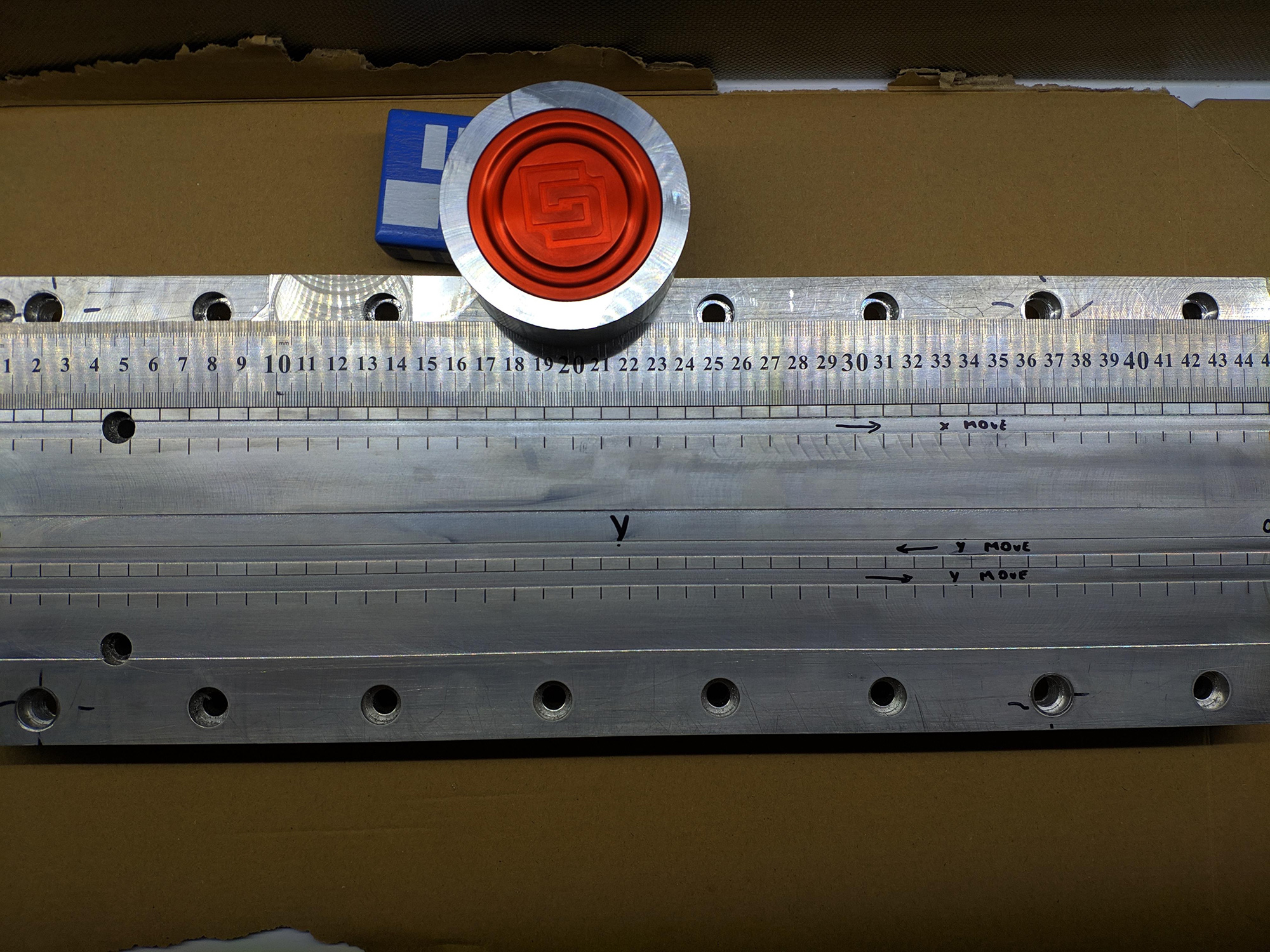

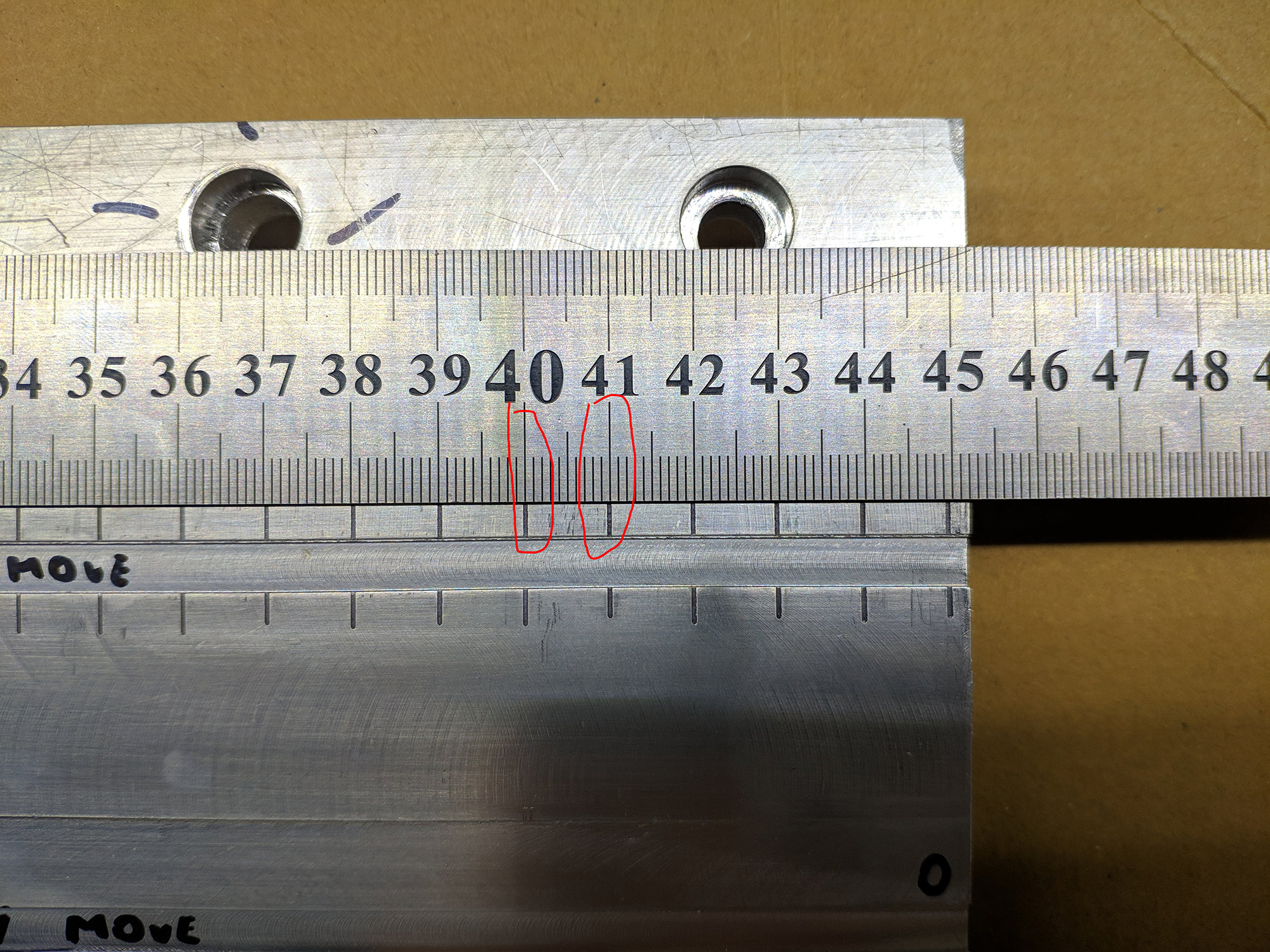

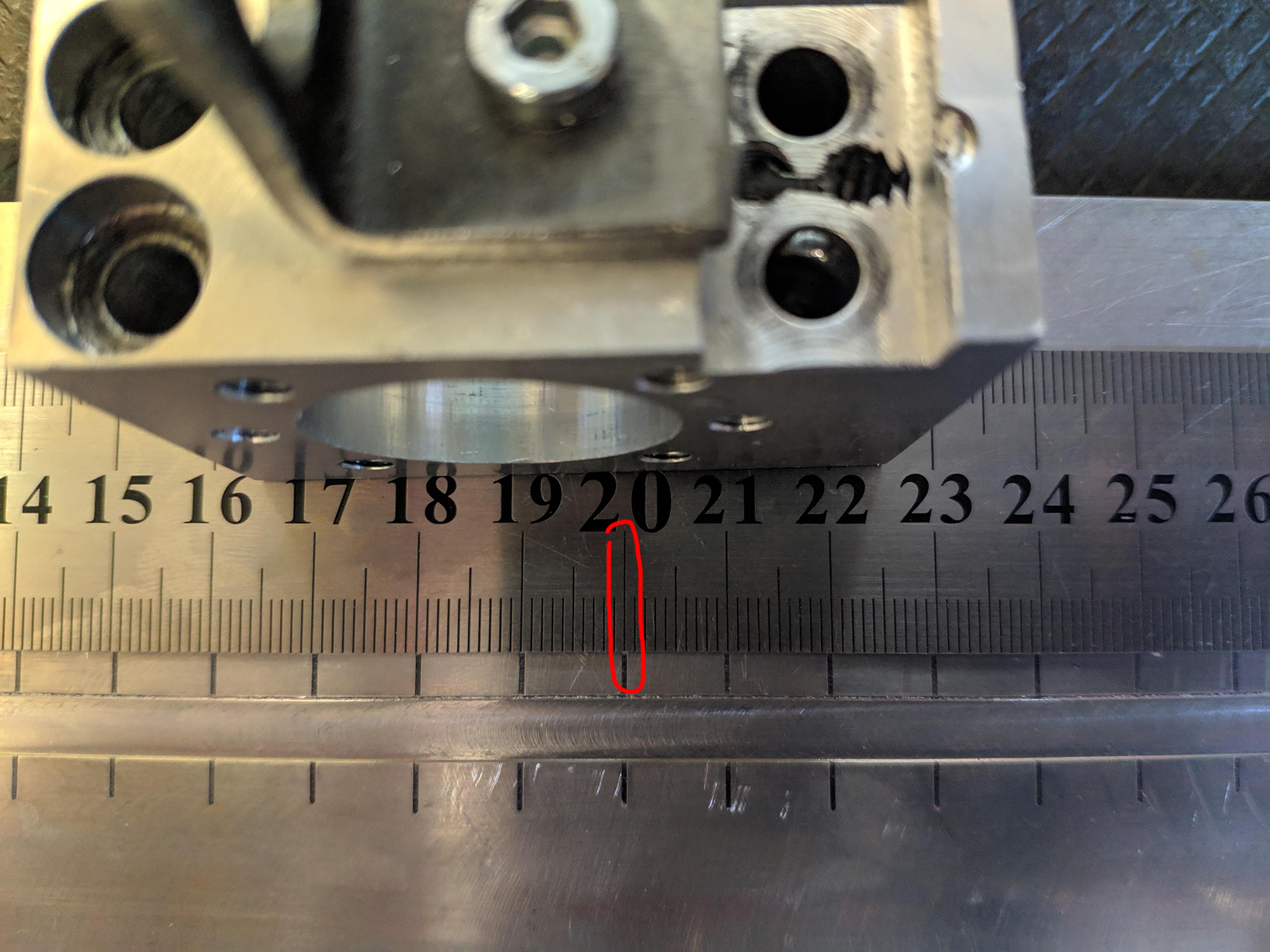

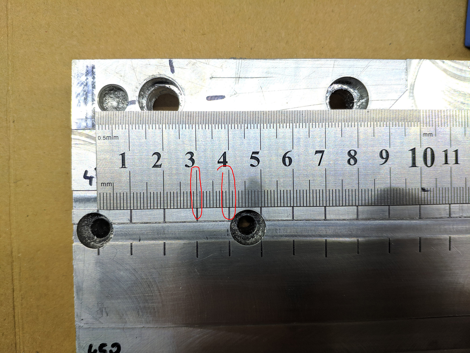

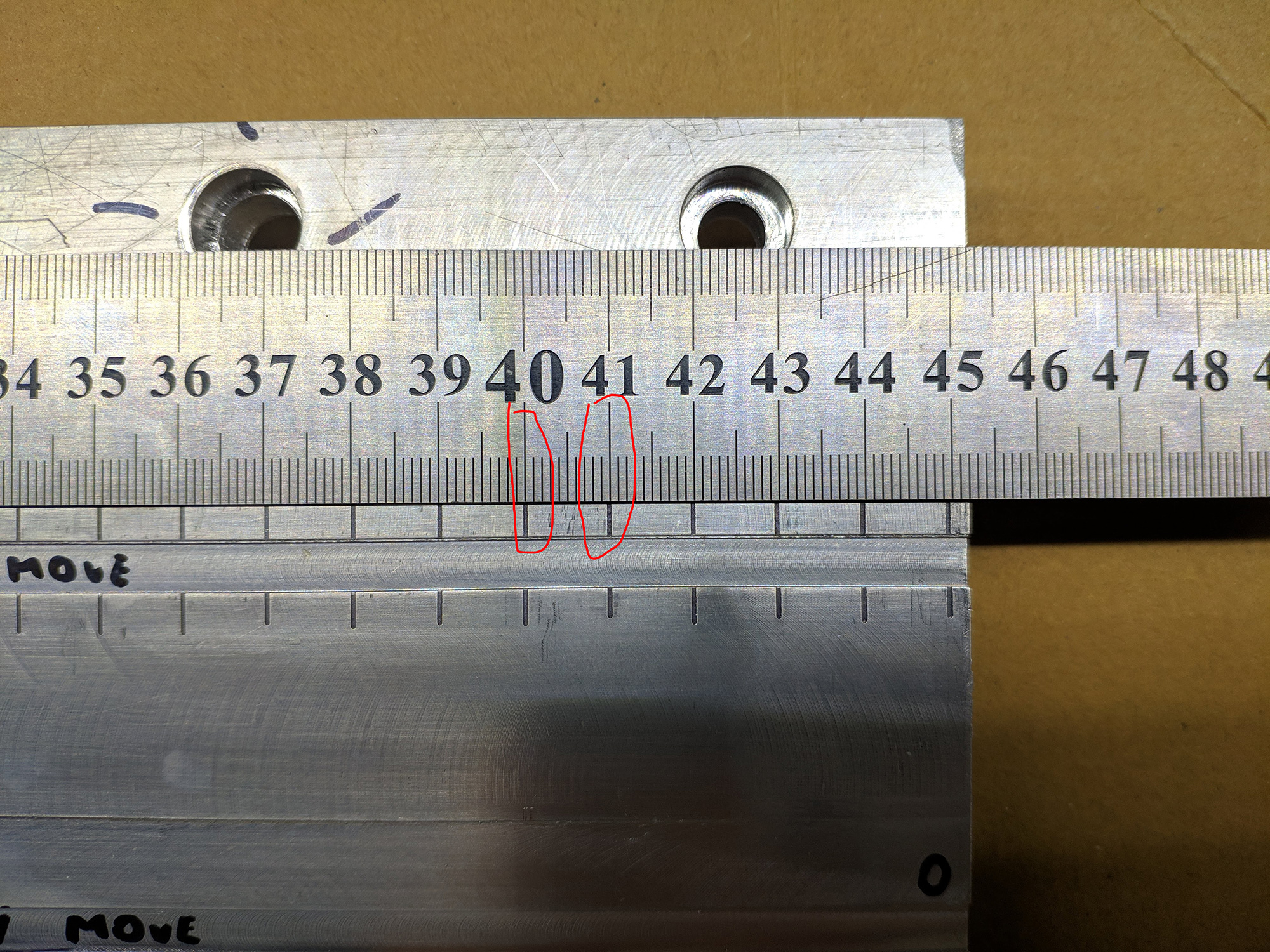

  7. I have engraved multiple rulers (10mm spacing) on a blank plate. First i engraved with x axis (from right to left and then vice versa) and the the same for y axis, overall 4 rulers. The result is the same as it was on my 5 parts with the error. X axis has 0.5mm error, y axis is ok. Engraving from left to right and vice versa doesnt show any error when comparing those two cuts. So i guess no mechanical error.
    On the pics bellow it shows where the error appears. It is in the middle area, approx 0.5mm error. I circled where the camera shows correctly because of its lens.

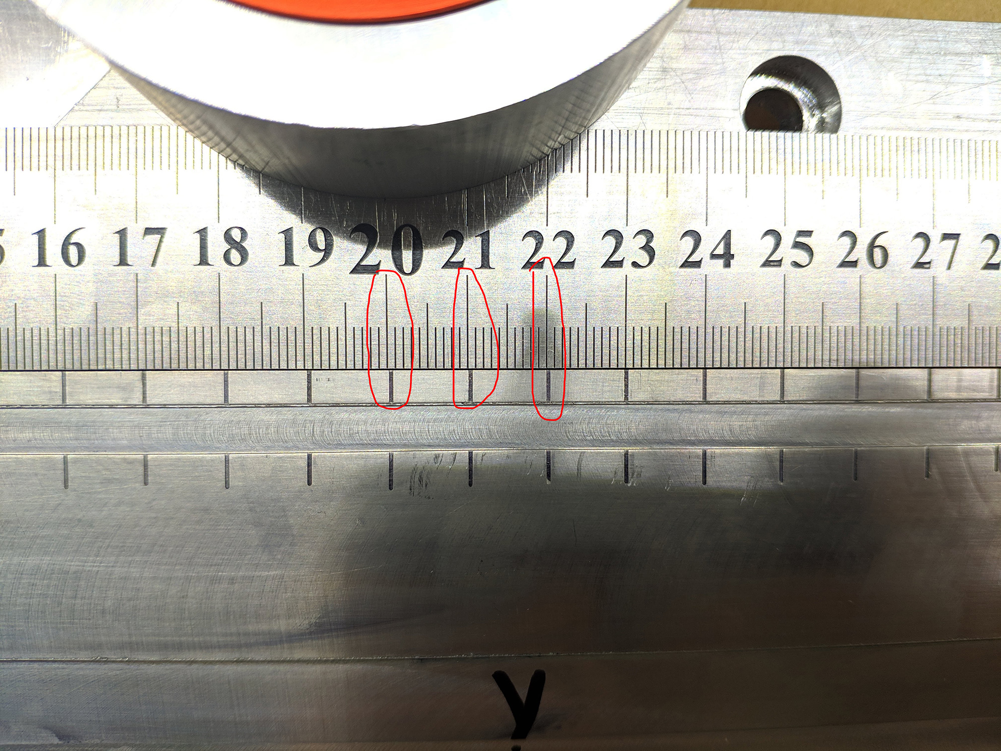

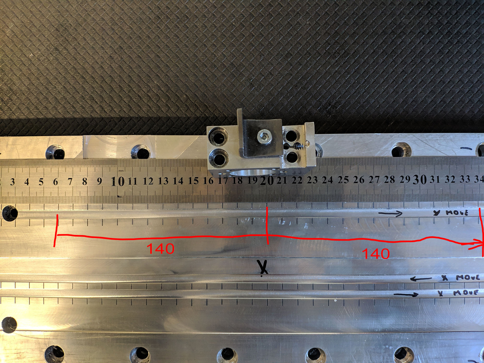

    On following pics i fixed the ruler in the center of the engraved ruler and it shows the same error as on the part:

    This must be something with the servos. Is this fixable with servo tuning considering i have no clue how to fine tune the servos?

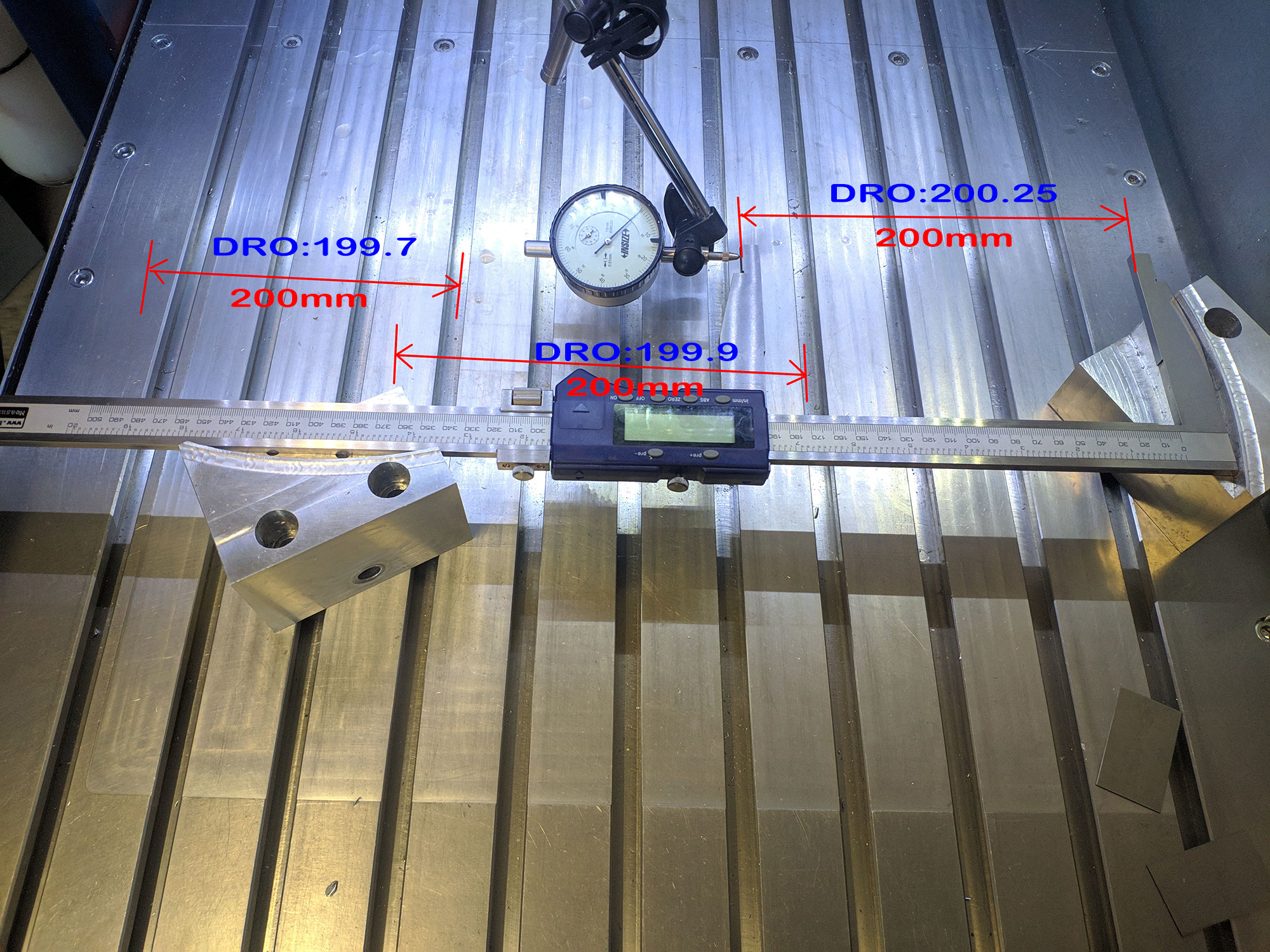

    That just looks like your steps per setting is wrong. It's not moving the amount you think it is.? The first thing you need to do is check that it moves the amount you tell it with one move. Using a ruler to measure against isn't accurate enough you need to measure with digital calipers at least or ideally linear scale.

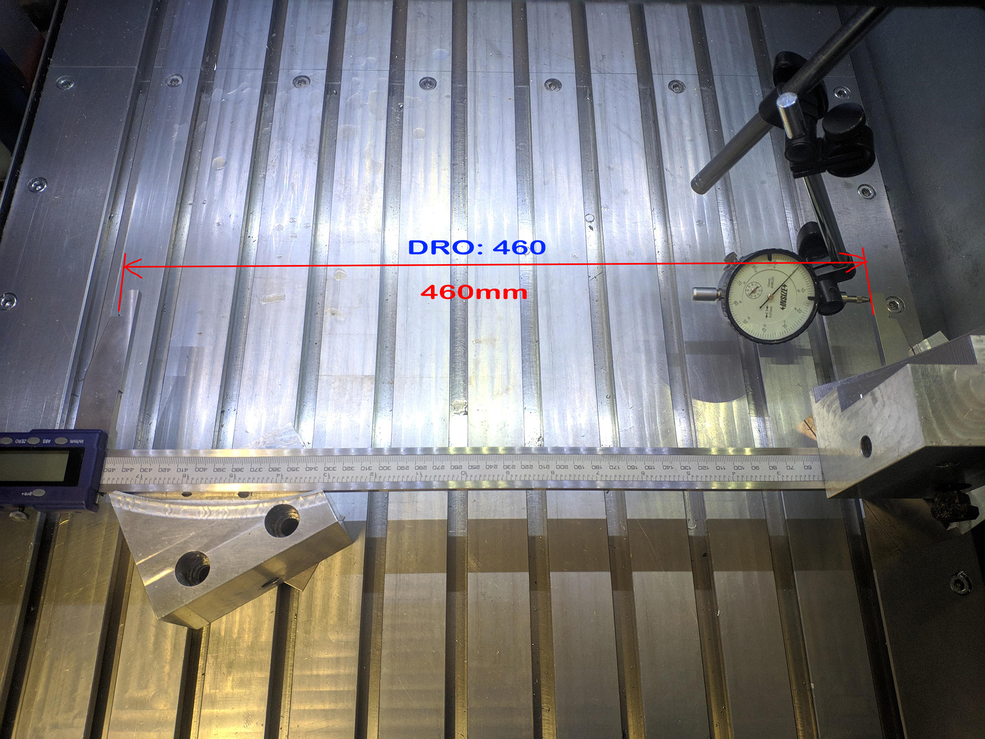

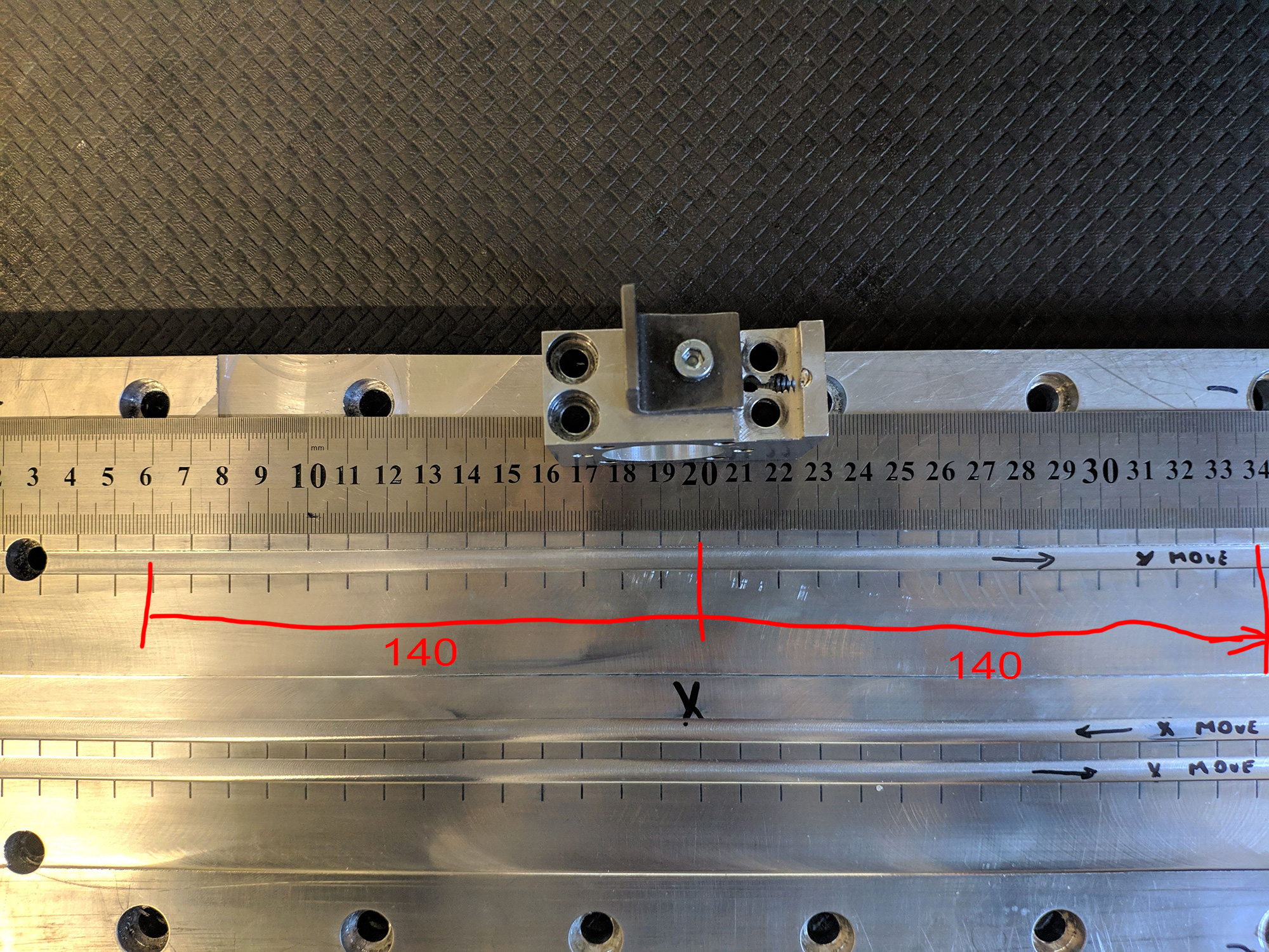

  9. I put the ruler there just for illustration of the error. Today i played with mach3 sets steps and the digital caliper and it shows exactly the same error. On pic1 i calibrated the x axis in mach so it moves exactly 460mm, then i set caliper to 200mm and placed it on 3 different locations, left, right and center. Pic2 shows what error machine makes. Have no idea how to fix that. I will inspect the connections next and swap motors. Maybe the encoder is faulty? Just guessing.

    How are the motors connected to the ballscrews.?
