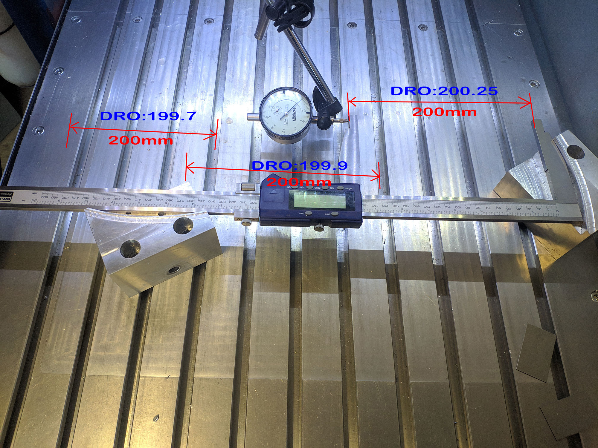

  9. I put the ruler there just for illustration of the error. Today i played with mach3 sets steps and the digital caliper and it shows exactly the same error. On pic1 i calibrated the x axis in mach so it moves exactly 460mm, then i set caliper to 200mm and placed it on 3 different locations, left, right and center. Pic2 shows what error machine makes. Have no idea how to fix that. I will inspect the connections next and swap motors. Maybe the encoder is faulty? Just guessing.

    How are the motors connected to the ballscrews.?
