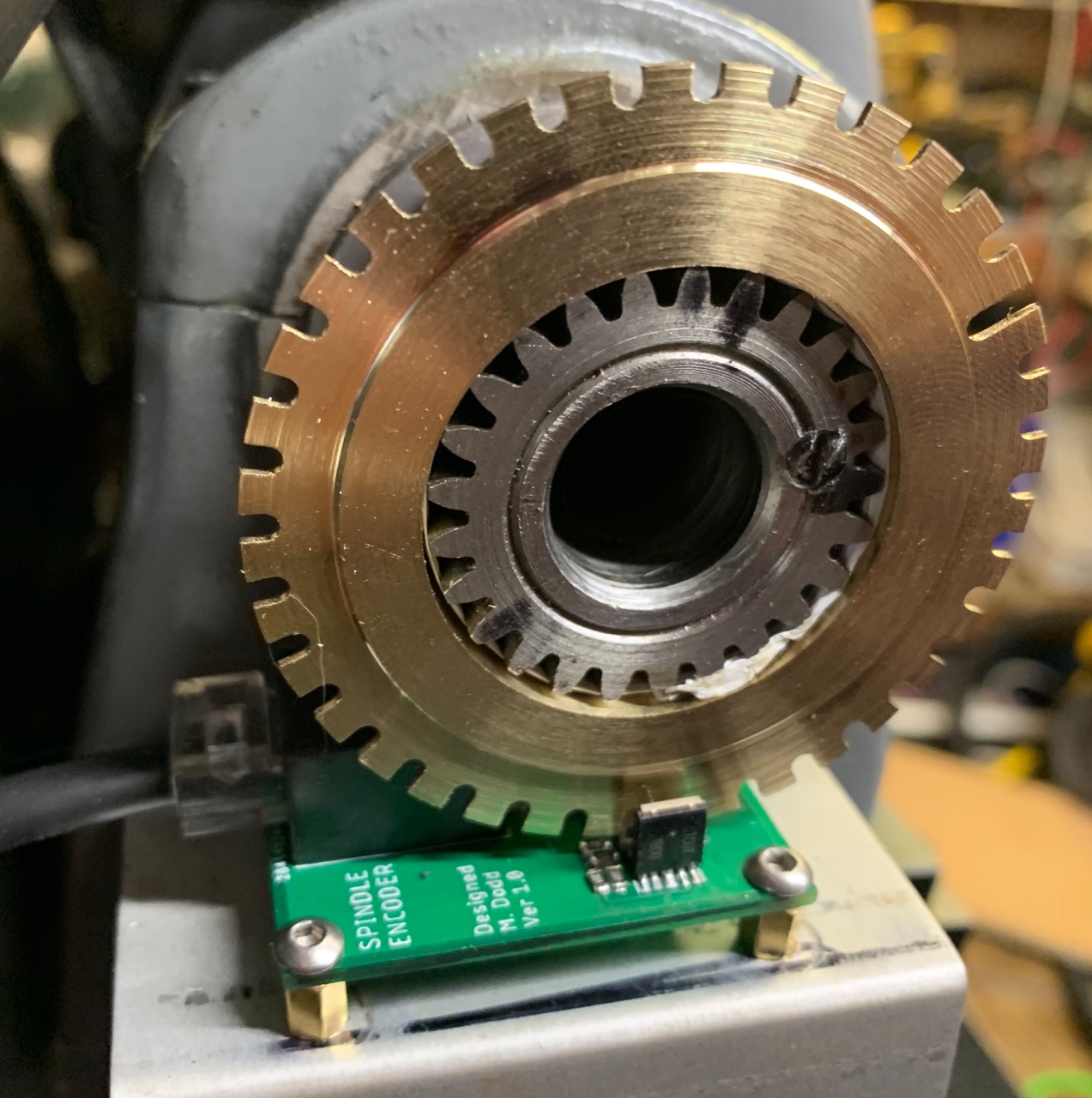

    Basic config: Lathe, LinuxCNC (2.7.14, Debian 9 Stretch install). Mesa 7i76E controller.
    I've added a spindle encoder to the machine with 36 detents and an index pulse - standard A/B/Index (differential drive).

    I do have a problem getting a working config to read RPM from this. What I'm really asking for is any example HAL file for a Mesa-based spindle encoder. My existing HAL is so far removed from the Mesa configuration wizard format that I'm hacking the HAL directly.
    Where I've got to so far is examining the HM2 Encoder component and the resolved velocity, but that seems to increment until the index pulse is received then resets and so-on. I've included the Encoder component as a thread into the HAL, but I think that's an error on my part by mixing LinuxCNC components from the Mesa FPGA functions. I'm randomly cut/pasting examples into my HAL from the internet where similar questions on dissimilar hardware is being discussed and worried that I'm adding more bloat/non-functional content into the HAL.
    So, if anyone has a similar setup and a working HAL for a Mesa board I'd be grateful if you can post details here.
