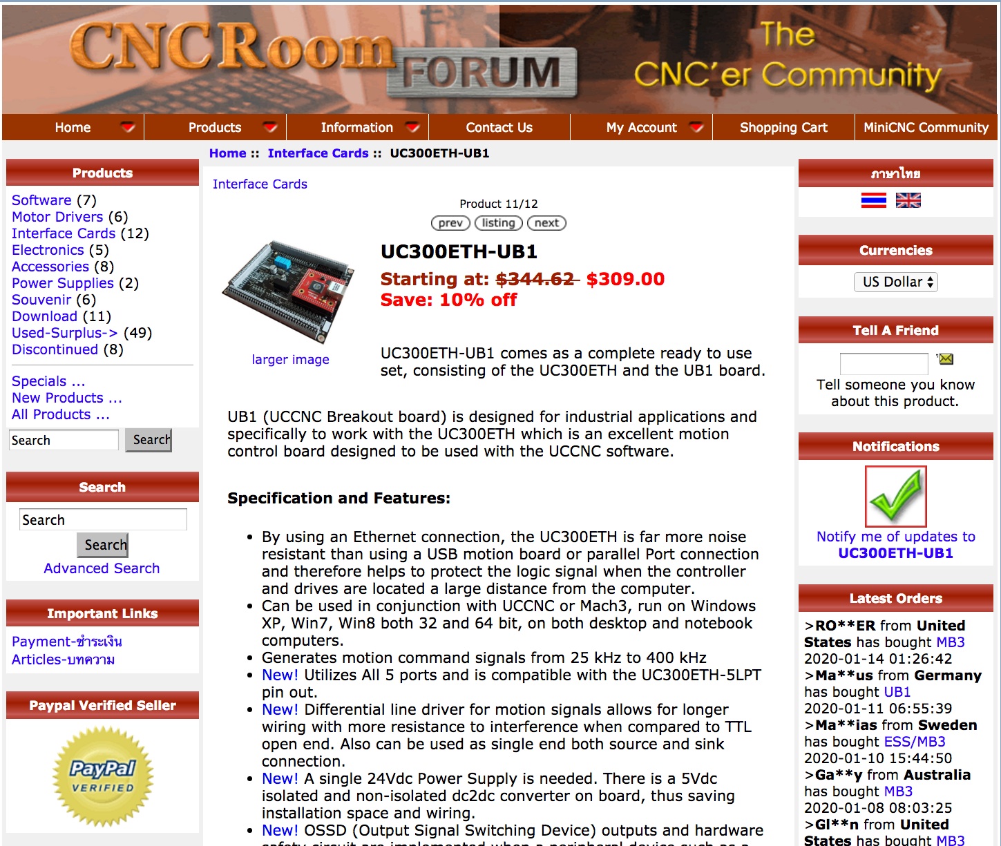

    Or maybe I only need this?
    https://www.cncroom.com/interface-ca...7b9jgm13v1aj83
    PS: Just noticed that with the above the UCCNC Licence is included but not with this package.

    That is a good setup and you won't go wrong. Just buy the license separately. You won't need the UD1-U board as you will have more than enough I/O from the UB1 for even a complex router setup..

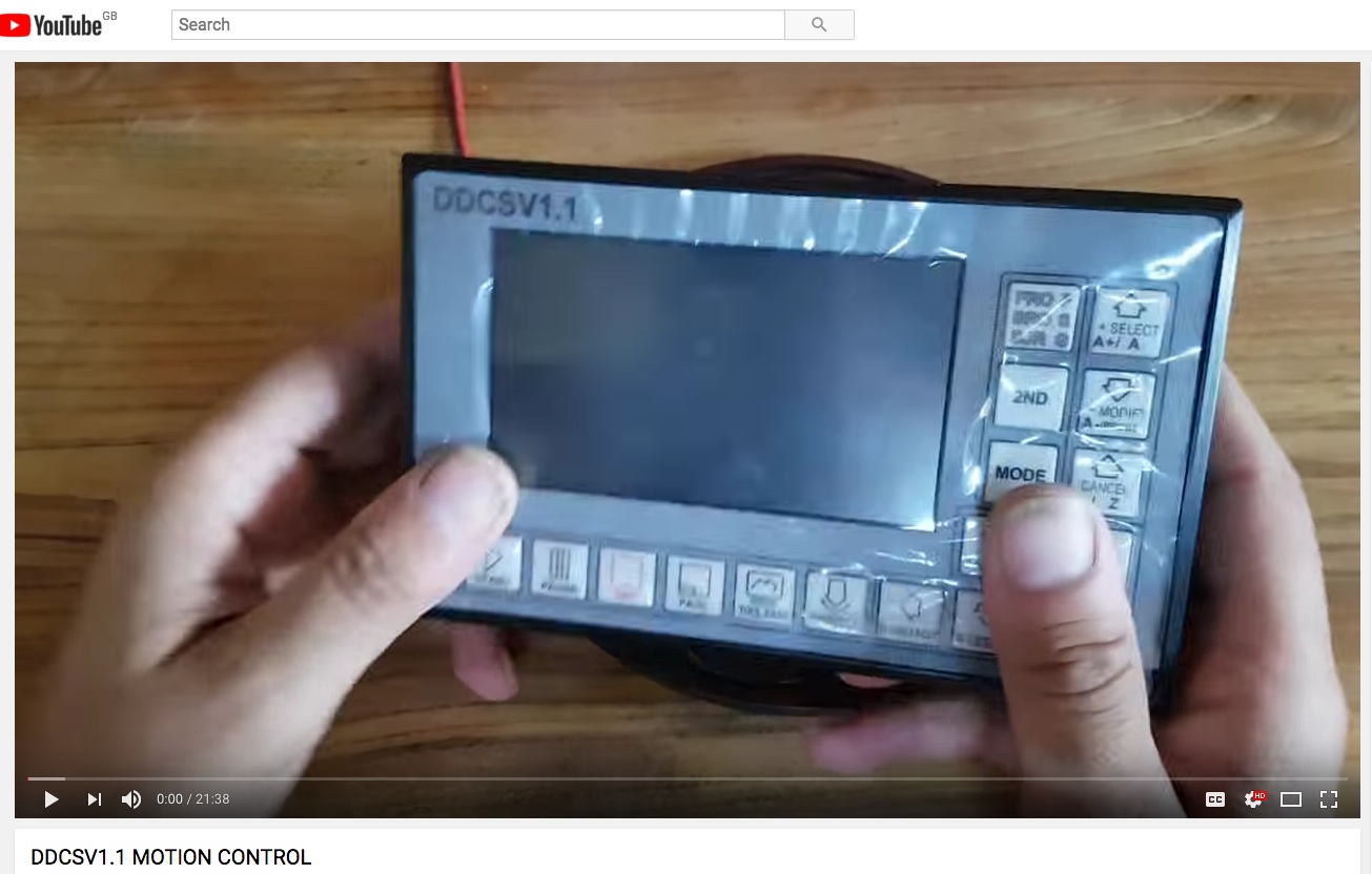

    DDCSV cnc controller . Have the earlier version on my machine and still working like a champ. I am tired of saying how much trouble was Mach 3 + Windows. Check on internet there is enough info and videos on Youtube.
    Have not had time last year , so dont know about the latest if any actual changes.
    PS. I see you have purchased already the laptop. Justifying buying computers instead of concentrating on the CNC machine needed. I guess once you finish what you are doing and remember what i said, you will start understanding what i was saying
    Had a bit of time to look at this today, it looks interesting. Not quite sure this is the way I want to go at this moment but it certainly looks like it could be very useful. I have not looked at all the aspects of the Control, just watched some of the Utube video. It sounds, like you have had quite a lot of experience with CNC machines before obtaining the control so know what you both want and need. It's good that you prompted me to look at this. Without your input I would not know that there are things like this out there.
    Thank you for the post Boyan
