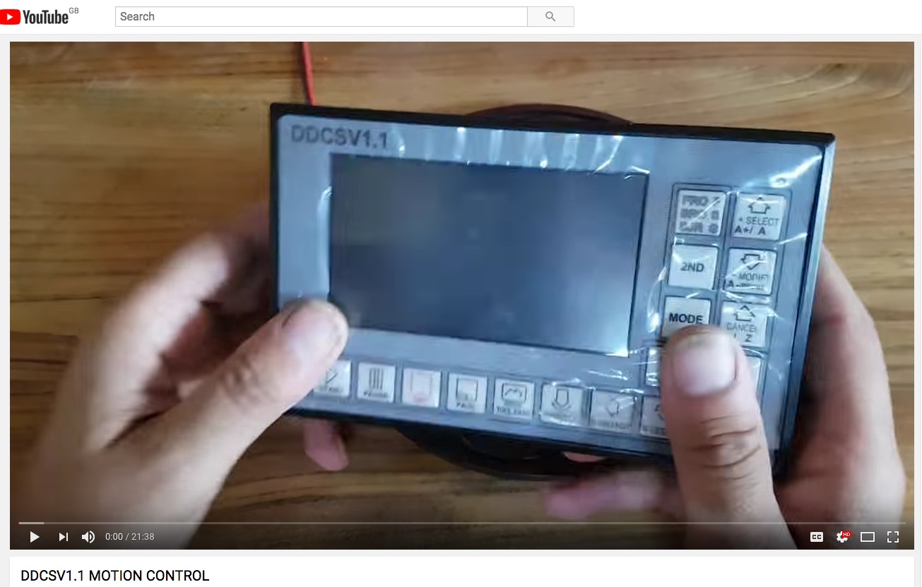

    Had a bit of time to look at this today, it looks interesting. Not quite sure this is the way I want to go at this moment but it certainly looks like it could be very useful. I have not looked at all the aspects of the Control, just watched some of the Utube video. It sounds, like you have had quite a lot of experience with CNC machines before obtaining the control so know what you both want and need. It's good that you prompted me to look at this. Without your input I would not know that there are things like this out there.
    Thank you for the post Boyan

    Not that i am a big defender on Chinese stuff but as its simple and it works... Moneywise is the cheapest solution also at around 200e. And simplifies connections also.
    Now i definitely understand why someone will want to have 22" touchscreen nicely displaying a software ,DROS, toolpaths and so on mounted in an Inox shiny box with fancy buttons. I have been there.. I remember even a time having transparent door so i could look at the blinking leds on top of that. Maybe its me but with the years i want only simplicity now and 100% reliability. That's why i don't drive Mercedes S classe as before but VW polo if you know what i mean
