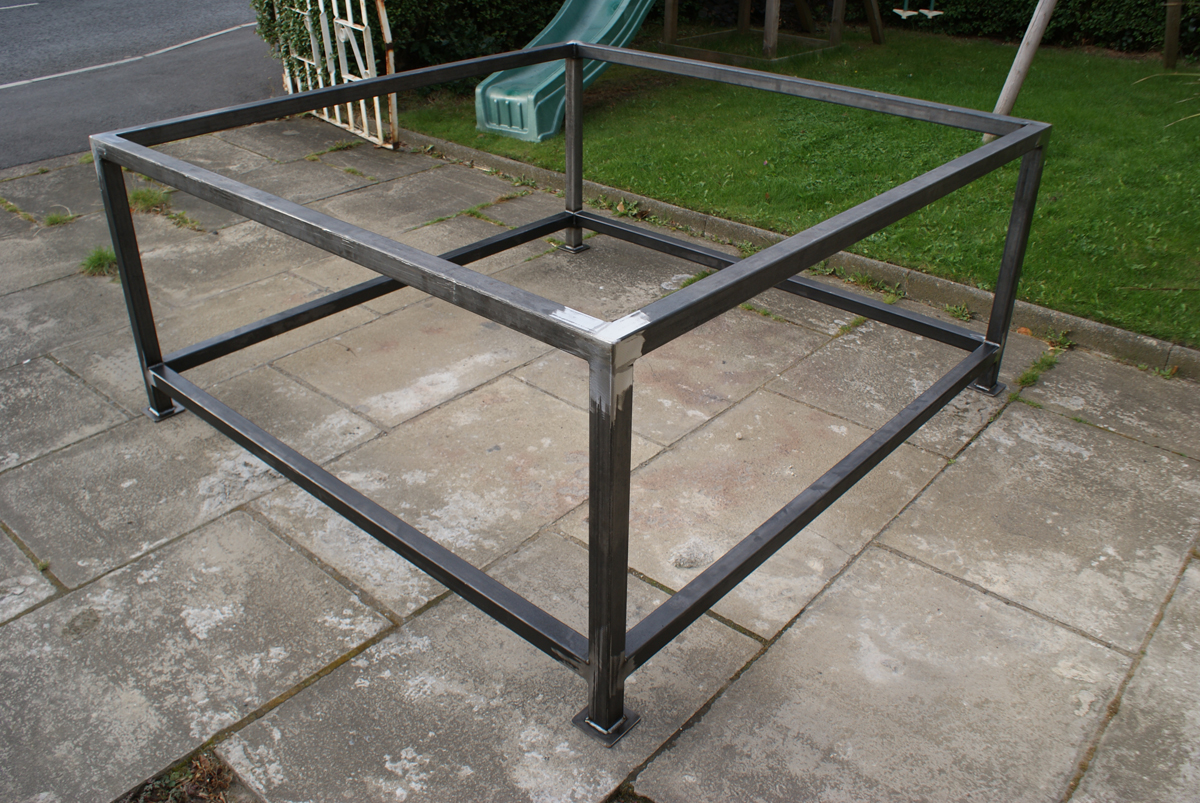

    Hi guys, i have considered building a cnc router for a while now so heres my build stage!
    i would appreciate any help on the electronics side ? as I'm am really lost here.
    take a look at the pictures and let me know what you think!

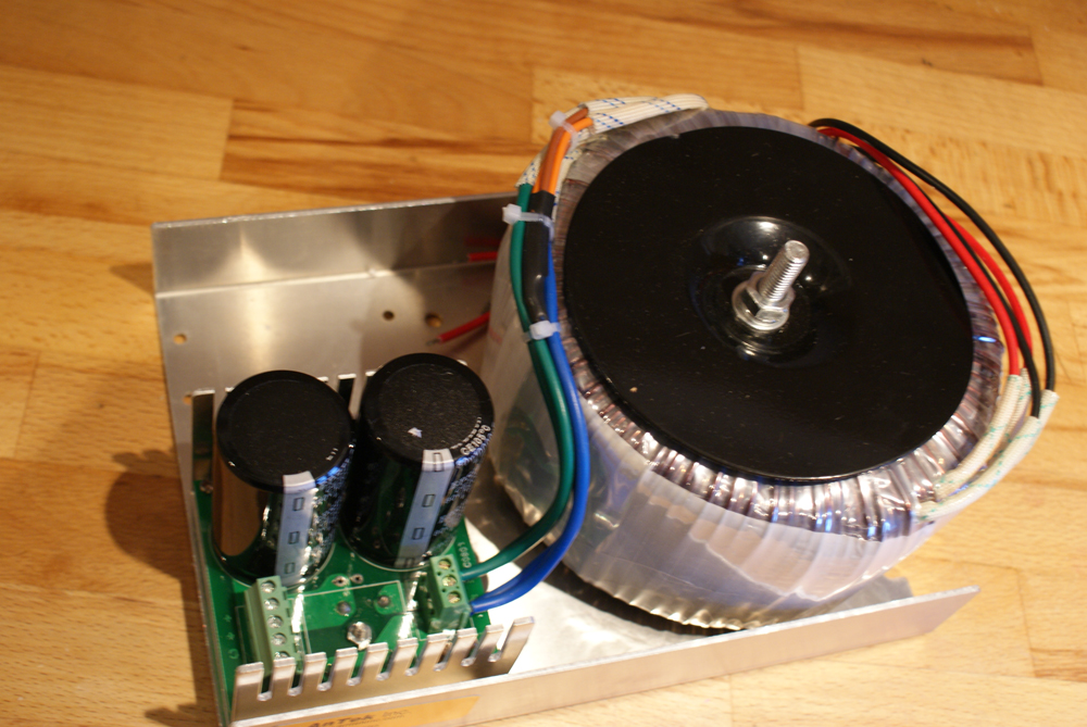

    heres a few pics of the drivers :)

    The power supply should have two wires coming from that - these will need to go to the Gecko's left hand connectors (as you've pictured them). Make sure that the PSU ground goes to the "POWER GROUND" pin, and the PSU + supply to the "+18 TO 80 VDC" pin.

    i was also wondering what type of slow blow fuse (amp) and holder i should use on the power side before the drivers ?
    I didn't use one, but generally you should base it on the current that will be consumed by the driver.
    So, if the output of the driver is 4A at 50V, then that's 200W (multiply the two together). Then, divide by the voltage input of the driver, say 100V. This means 2A.
    However, that does assume there's a 100% efficiency in the transfer, which there never is. I'd estimate between 75% and 90% efficiency, so worst case, it will be 2 x 100 / 75, or ~2.7A. Then choose the next value up from there (probably 3A).
    This is also applied to the power supply itself, so if you had 3 drivers with 2.7A@100V (270W x 3), then that would be 810W. Giving 220V into the PSU, you'd need a 3.7A, but with 75% efficiency, it's 4.9A - or say 5A.
    I'd probably be tempted to use a self resetting fuse - if anything goes wrong, just remove the power, and the fuse can be reused.
    As to the type of holder - really up to you.
    One thing though - if your motors are rated at 4A per phase, then wiring them in parallel will actually consume 8A, since in parallel, the current is doubled (you're putting two phases in parallel).

    The Motors you have are 8 wire...they can only be used in bipolar parallel or bipolar series with those drivers. So you have the choice of running at 6A or at 3A per phase. You can of course run them wired bipolar parallel at a lower current, e.g. 4A if you wanted but the only reason to do that is if your power supply wasnt up to the job. Your PSU is an 11A output. Ideally you'd want one per motor, or at least two in parallel. A single supply is going to limit you to a phase current of about 4.5A - 5A.
    These are hi-inductance motors, so wiring them Bipolar Series is going to severely limit torque at speed, so I'd still wire them Bipolar Parallel but run at a reduced current of 4.5A (82k resistors). You can always add a second or third supply later and up the current to 6A.
    The Gecko will shut down if you try to draw more than 10A from it. Fuses in the supply to the Geckos are additional protection in case of a catastrophic failure of the Gecko - to prevent wires melting and potential fire. They should be rated at 10 - 12A in this instance.
    The other consideration is that the Gecko need a substantial heatsinks for running at 5A - I think you have these and showed a pic of them in another thread?
    One word of warning:
    80v at 11A is potentially lethal (as is anything above 50v - which is why phone systems are all 50v). Keep hands away and if you have to adjust anything while its switched on always work with one hand in your pocket - that way you stay safe!
